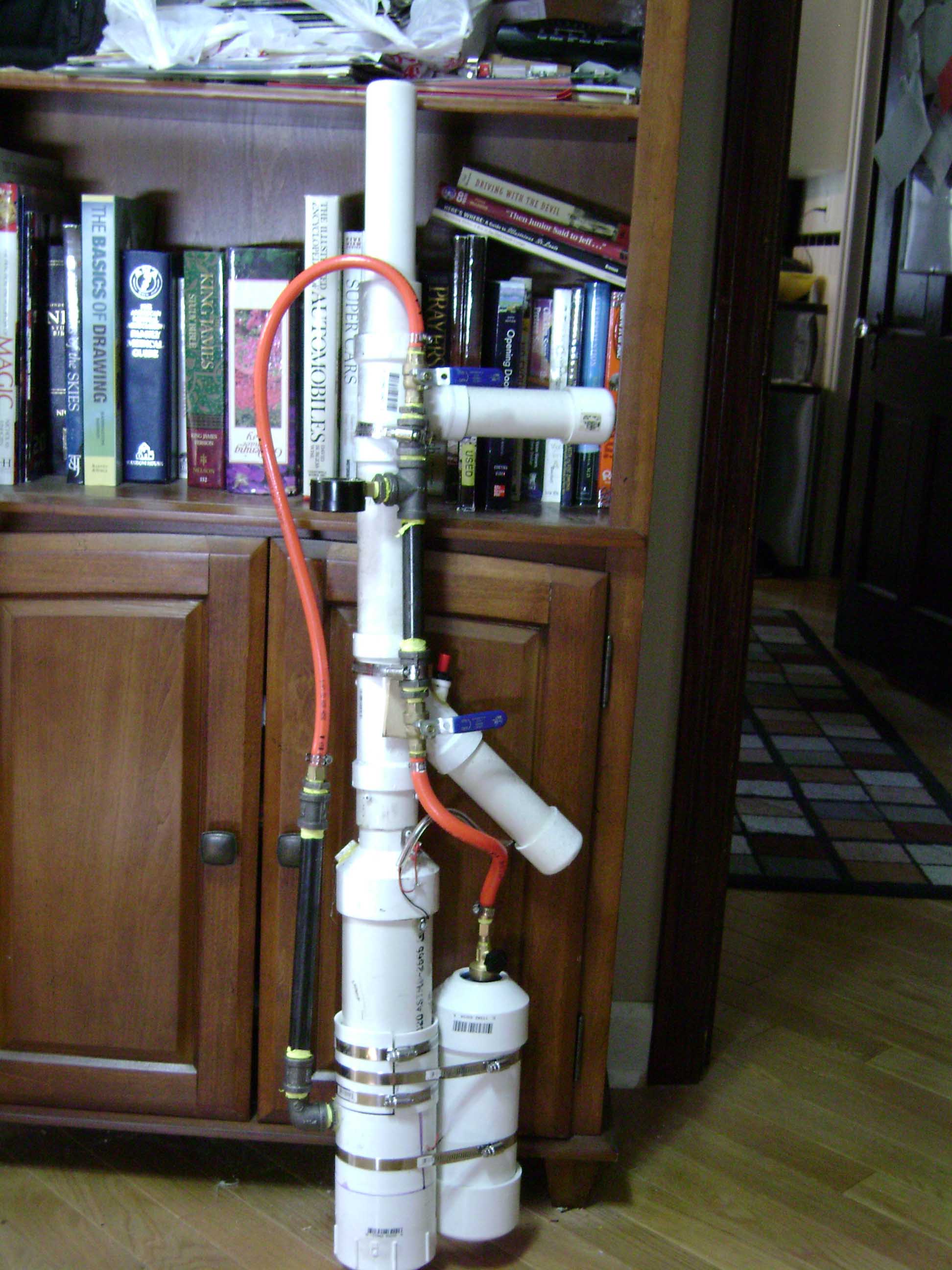

Hello, I am a new member to this site and I also built my first potato combustion cannon. I just got done building it today, but i can't get it to fire. The problem is that the propane is leaving the barrel, even when its loaded. I tried stuffing more down the barrel but that doesn't seem to help. It did however fire for the first test shot but after that it wouldn't fire at all. I have no clue what to do. Help would be very much appreciated!

What exactly do you mean by "leaving the barrel"? You can see the gas vapor floating out of the muzzle? Air out your chamber very well, unload it and look through the chamber and force clean air through it. Next check your spark. Can you see it? If so cap the chamber back off and try a dry fire. If it still doesn't work check your mixture and be sure to clear your chamber in between each test.

I think the problem it's that the meter pipe it's to far from chamber and most of the fuel are trapped inside that long house that connects the chamber/meter pipe, not well mixed inside the chamber.

What i mean is that i can hear the propane leaving the barrel. I will try to do what you suggested, jrrdw.
Noob question. How do you know if you have the right mixture?

Here is a good page to start you off in you quest for info: http://www.spudfiles.com/forums/useful- ... 13096.htmlninjamonkey127 wrote:How do you know if you have the right mixture?
To help you with the mixture: http://www.spudfiles.com/forums/propane ... t8017.html.
It is a good idea to shorten your feed hose to your meter...
Post some close up pictures of your cannon and meter so we can better help you.
You may hear the echoing sound of fuel leaking into the chamber through the hose out the barrel instead. None the less, if you have a spark, you can try the following qualitative test:
To tell if your running lean or rich, drop a match down the muzzle. If that lights it, you're running rich or with a poorly mixed mixture.
Otherwise, you're running lean.
Leave a decent amount of time between trials so as to minimize heat buildup. Obviously vent between every attempt.
Needless to say, point the canon in a safe direction (away from your head) when dropping the match and do not load a projectile.
If you're actually loosing propane out the barrel, having a projectile loaded will help (and prevent the use of this test.

Love the configuration, good luck with getting it firing!
I say "luck", I mean of course "science".
Some details of your fuelling procedure and chamber/meter dimensions and fill pressure would help. There is definitely too much pipe between the second ball valve and the chamber.
I would invert the bottle and use the metal pipe attached to the chamber as the meter.
Thanks for the great info! I'm going to try to figure this out tonight. I'll post some pictures up later.
I actually do have a fan in the chamber, i just need to wire it up.jsefcik wrote:installing a chamber fan will help out alot!
I never thought of that. I only assumed it was leaking out of the barrel is because it wouldn't fire.ramses wrote:You may hear the echoing sound of fuel leaking into the chamber through the hose out the barrel instead.
Thanks! Here are the dimensions:jackssmirkingrevenge wrote:Love the configuration, good luck with getting it firing!
Chamber 3"x 15 9/16"
Meter 1/2"x 6"
I might of over done it with the pipe but i don't plan on taking it apart and working on it any time soon. That first test shot has kept my hopes high.

So i test fired my gun again, but this time i put 30 psi of propane in the chamber instead of 40 and i had the fan wired up and on. It was a whole lot more powerful then the first time it shot and it had a lot of recoil to it. When i tried firing the gun again it wouldn't work. I was wondering, does it matter what kind of potatoes i use? I should also mention that a potatoe was left in the barrel over night. Maybe that has something to do with the gun firing?
brand doesnt mean anything, and id say fresh is always best, would you use a rotten potato?ninjamonkey127 wrote:So i test fired my gun again, but this time i put 30 psi of propane in the chamber instead of 40 and i had the fan wired up and on. It was a whole lot more powerful then the first time it shot and it had a lot of recoil to it. When i tried firing the gun again it wouldn't work. I was wondering, does it matter what kind of potatoes i use? I should also mention that a potatoe was left in the barrel over night. Maybe that has something to do with the gun firing?
and you want a very tight seal with the potato, i wouldnt leave the fan on, just put it on for a couple seconds,
what kind of ingition are you using as well?

Is there anything i can wrap the potato in to give it a tighter seal? cause every time i load a potato in the barrel it slides down really easily. and yes, the potato is bigger then the barrel bore.jsefcik wrote:brand doesnt mean anything, and id say fresh is always best, would you use a rotten potato?ninjamonkey127 wrote:So i test fired my gun again, but this time i put 30 psi of propane in the chamber instead of 40 and i had the fan wired up and on. It was a whole lot more powerful then the first time it shot and it had a lot of recoil to it. When i tried firing the gun again it wouldn't work. I was wondering, does it matter what kind of potatoes i use? I should also mention that a potatoe was left in the barrel over night. Maybe that has something to do with the gun firing?

I'm just using a bbq igniter.

...and you continue to show just how much you don't know. Leave the fan on, I believe it increases turbulence and results in a faster combustion. Someone more knowledgeable on the subject can correct me if my justification is wrong but it seems to be pretty common practice nowadays to leave the fan on during combustion.jsefcik wrote:i wouldnt leave the fan on, just put it on for a couple seconds
