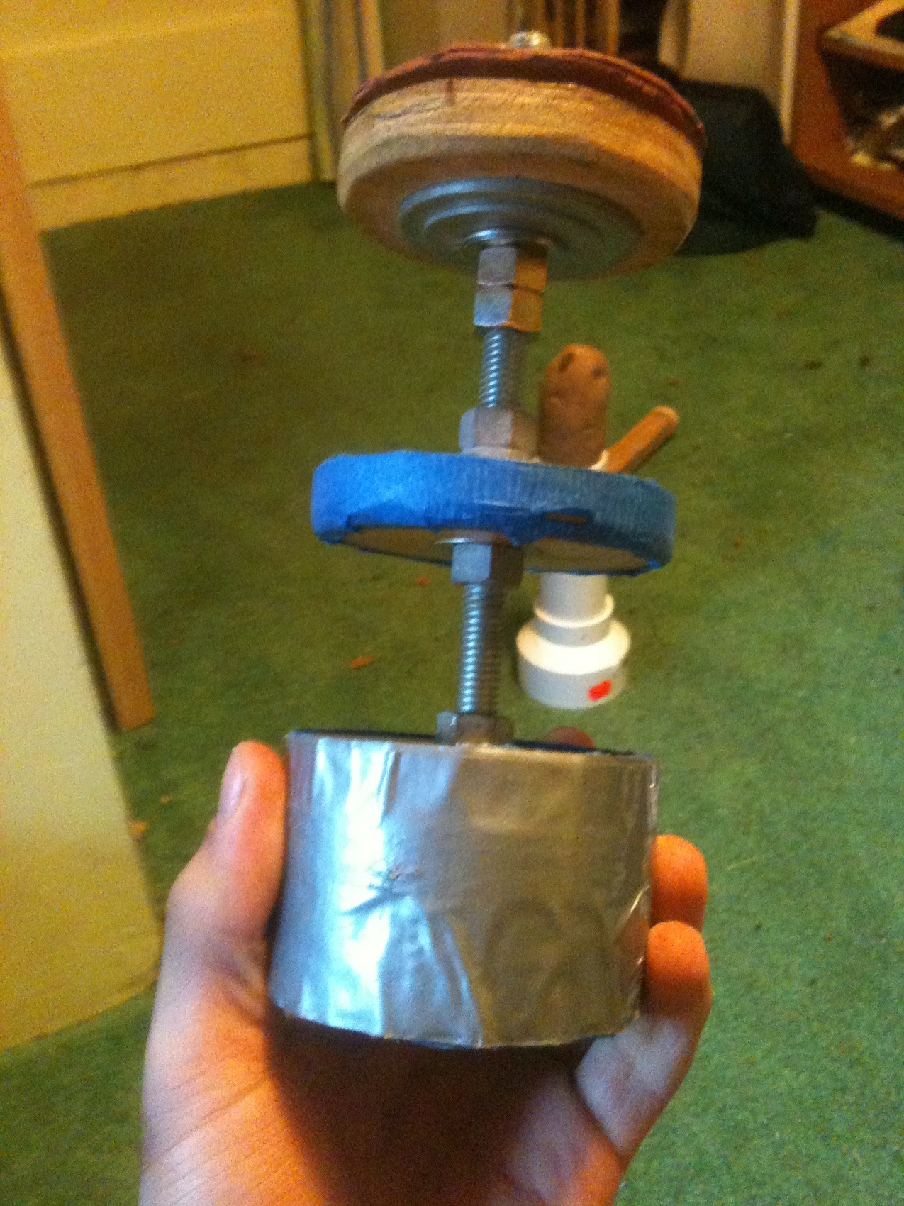

This is my first piston valve gun. It has two 5 ft long air tanks, 3 in. diameter. The piston housing is 3 in. with a 2 in. barrel. Soon to come: golf ball barrel! I'll see if I can get some videos later.
The only issue I have with it is that sometimes my pilot release valve doesn't bring the piston back. I believe it's because it's either too small or too tight. I really don't know enough about them to tell. I've messed around with wrapping layers of tape around the back of the piston (ghetto, I know) for a tighter fit but it's too hard to tell exactly what the problem is. Maybe somebody could help? :)

my piston
my piston

Nice first effort :) a ghetto piston like that needs a good pilot though, what are you using? A sprinkler valve would be an adequate solution.

yeah i'm using a sprinkler but for some reason it doesnt seem like it's opeing all the way. If i can get this darn video uploaded, maybe you could see. It almost whistles for a second or two before firing

The yellow coiled line is screwing you over by dramatically increasing the sprinkler pilot volume. You need to mount the sprinkler pilot on the valve itself.

Nice gun too much pilot volume.... I would also try using a we've for a pilot..
