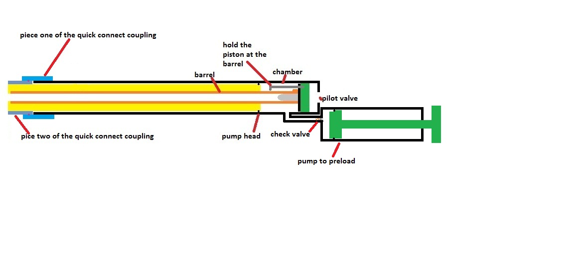

It would work as drawn, certainly - but in terms of complexity, you're not really gaining anything by having two pumps in my view.

Let's say you 50cm long chamber tube, and a barrel/pump filler with a stroke of 45cm - that would take you to enough pressure for a 10x hybrid
I was thinking along these lines here.
By having a 1x mix in a syringe and using that to pressurise a cartridge, any pressure you reach would technically be at the right ratio. Using it manually would naturally limit you to the pressures you can achieve through the pressure you can exert, so a possible solution to this would be modifying the syringe to enable the plunger to be pushed by air pressure
Coupled with Brian's concept here, hmmm...
Replace the burst disk pilot with a check valve, add some ignition points and a quick syringe squirt of butane/propane before inserting the pump head... profit!
I'm sure this is exactly the sort of brainstorming he intended to happenbrian sorry for the highjacking

heh not a bad idea - sounds worth tryingReplace the burst disk pilot with a check valve, add some ignition points and a quick syringe squirt of butane/propane before inserting the pump head... profit!
ohh and a metal on metal detent mechanims would be ideal for this application

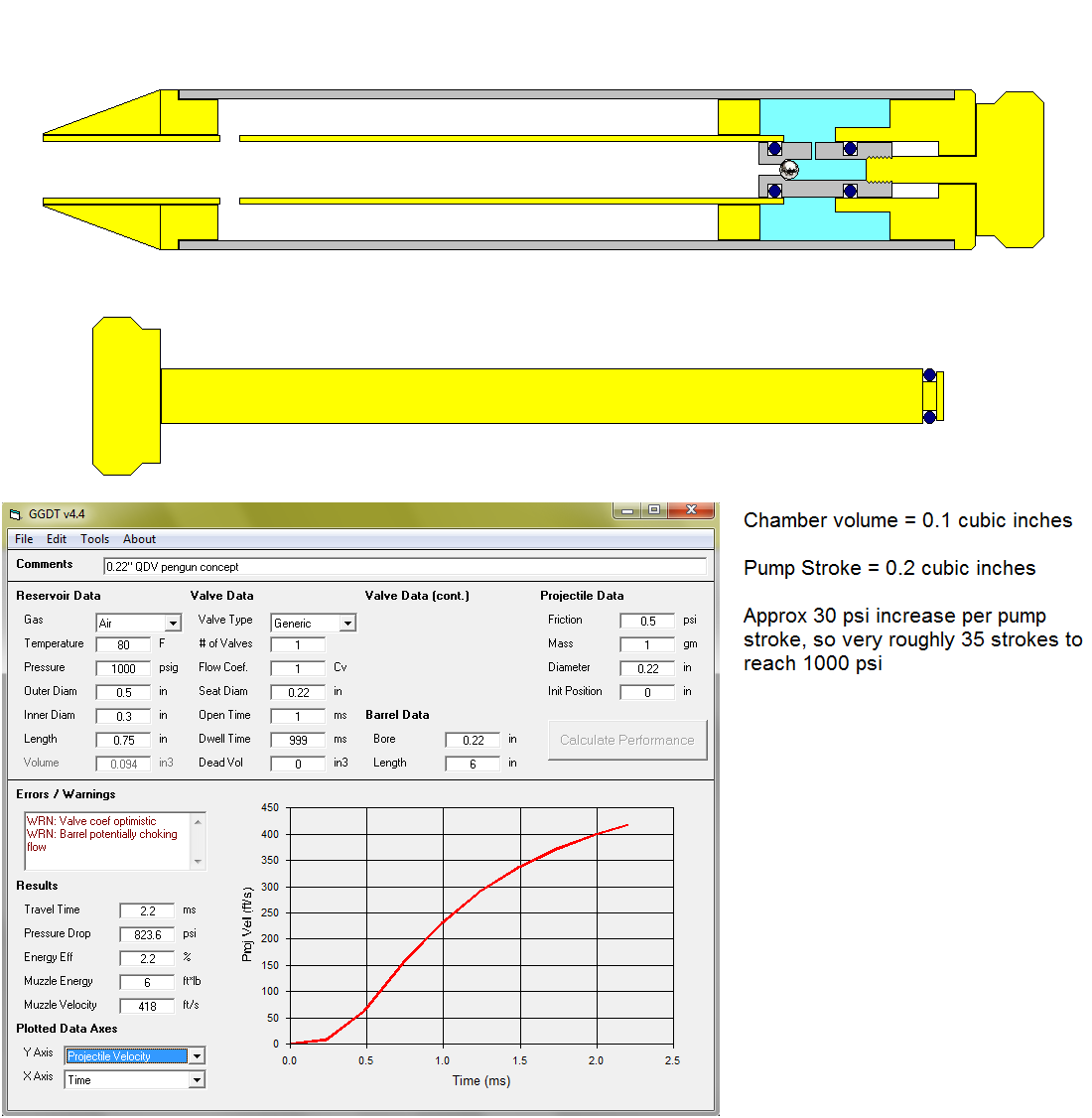

Here it is in GGDT assuming an 8mm steel bearing projectile and you can get to a pressure of 750 psi / 50 bar.
Note that at that pressure and using a 20mm ID chamber you would have to push down with around 125kg of force... so start eating

Should work I think, however the opening speed of your valve will be hugely limited by being fixed to the pulling rod..
you aren't going to manage a 1 ms. opening time on this one
With 1000 psi in the chamber giving a hand, I think it wouldLabtecpower wrote:you aren't going to manage a 1 ms. opening time on this one

Looks like that thing would pop as soon as the balance is broken...
My thoughts exactlyBrian the brain wrote:Looks like that thing would pop as soon as the balance is broken...
