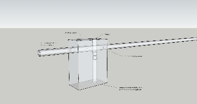

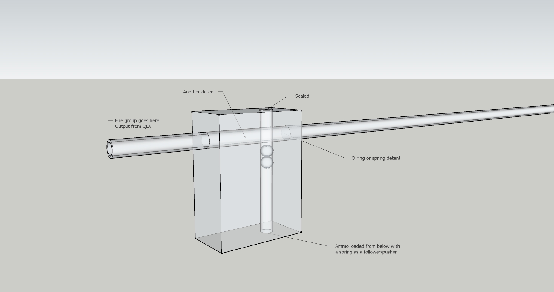

A germ of an idea was spawned from another discussion on the forum yesterday or day before about the issues of pressure loss via a tube mag / breech.
How about an integrated mag/breech setup ? The idea is to carve a block of HDPE or aluminium into say 100mm x 100mm x 40mm. Drill two holes at right angles to each other all the way through on the main axis, one the outer diameter of your barrel and one the diameter of your projectile. The projectile sized hole penetrates the bottom of the barrel, forming a T junction.
Assuming a snug barrel fit and probably a forward and rear detent, the round should sit snugly in the barrel ready to fire.
Put a dozen rounds up the pipe, cap it with a screw in spring pusher and you have a sealed system. To the external view it would have the appearance of a STANAG type magazine (once you dressed up the block a bit) but would function as a standard tube mag. I know you could get a long way to the same thing with just a T fitting then cladding but I suspect the drilled block idea would give a tighter and cleaner end result.
Thoughts ??
Integrated magazine, breech and barrel

well I see one problem - you have to drill really deep holes and that isn't always easy
ohh and what's the point of it ? you can achieve the same result with a T... if you have access to machining then go for something more impressive like an aluminium block that combines both the T and a valve

I currently operate a similar assembly in my gun.
I use a T-junction and a short tube as magazin. Spring loaded to allow gravity independent loading.
You should keep in mind that magazine should be fast to change.
In this case the mag also has to keep the full pressure of the system.
So some engineering is necessary to solve that. I chose to build a bayonette locking system, but it is not that good sealed, so I loose some power with it....
