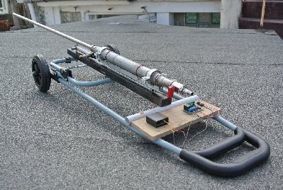

Well I still have exams, but with a excuse of a physical project I re-build my hybrid.
New designed suspension, now much more effective and durable, new spark plug allowing mix 20 and probably more. Also going to replace the tripod mount by a 2 wheeled mini cart. The rest continues the same.
Tomorrow I'm going to finish mounting it on the cart, then go for a couple shots, will record in both Full HD and high speed.
My Hybrid V2
Hmmm... so it's going to be a dual recoil affar, a bit like the Mörser 18?wyz2285 wrote:New designed suspension, now much more effective and durable, new spark plug allowing mix 20 and probably more. Also going to replace the tripod mount by a 2 wheeled mini cart.

Not really
, see the pneumatic ram in the front? That's the suspension, the chamber now is bolted on a rail (the kind used on sliding doors)
Are you sure? If it has a pneumatic cradle buffer, and the cradle itself is free to recoil on a wheeled chassis... dual recoil

Oh well, in that case yeah, dual recoil
sounds cooler even
You can see it clearly at

Got it working, only made 2 shots through, the remote ignition unite needs some refinements.
No damage video, just 2 dry fires to test the new structure.

Haha! see, dual recoil!
Should kick significantly more with projectiles, looking foward to that

Specially now I have lead to cast instead of waxShould kick significantly more with projectiles, looking foward to that
