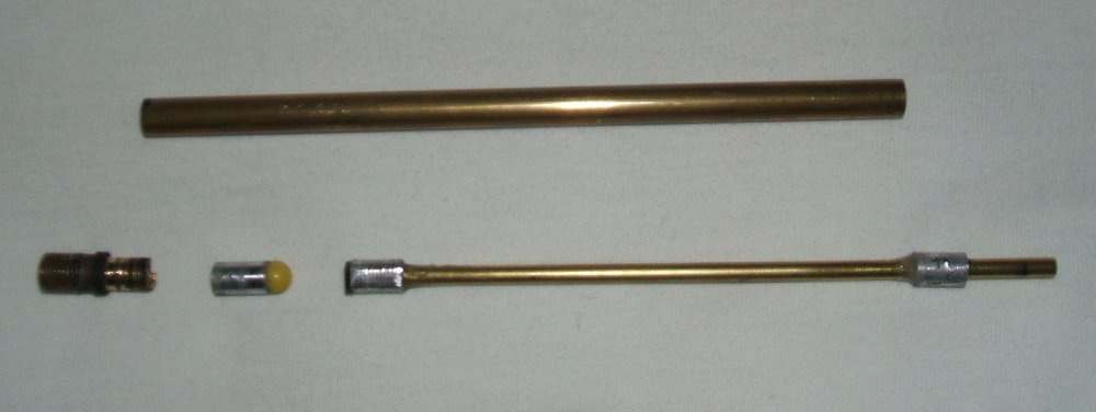

didn't check if anyone already asked this (i know, i know...) but what material are muzzle and breech parts, i mean the silver color parts glued to the barrel? also sorry if im posting on some old topic.
Aluminium, but I've had good results simply wrapping masking tape around the barrel and gluing the whole thing with araldite:
http://www.spudfiles.com/forums/mini-0- ... 20101.html
Good for 800 psi at least ;)

and why are the pictures deleted
they were on my photobucket account, i had deleted a bunch of stuff.
here:
