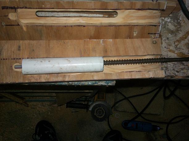

I tried out the spade bit and a 2 x 4, but I couldn't get the hole straight enough over a long enough distance.
I did however, get a chance to try out a new toy I was given for Christmas!
I was given a Ryobi Router by a family friend, and I decided to give it a shot.
I think, with the right bit, I will be able to cut the perfect groove in a pair of 1 x2's and fit them together, and then place the cylinder in the groove. AWESOME TOOL.

Actually, the one I'm using came off of an old umbrella, I think. Standard stores don't really carry springs that are long enough, without being too hard to compress.
At the moment the sniper rifle I'm working on is only as powerful as a cheap spring pistol, maybe 40 ft of range. But the nice thing is, its built DIY fashion, so I can put it under WAY more stress that manufactured ones, so bigger springs
