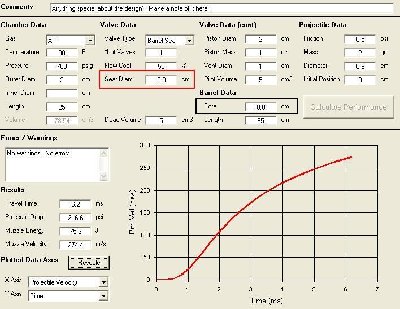

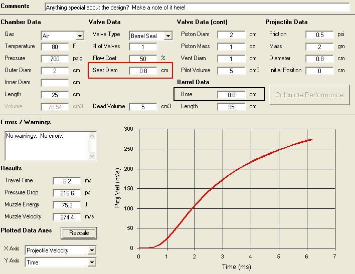

the meaning of this option in ggdt
in the red square
i have been in the ggdt site but i did not understand what they mean by seat diam
and why if i make the seat diam biger than the barrel bore in the black square i get choking flow and the muzzle velocity increase ??
can any body explain to me what....
It is the internal diameter of the opening that is uncovered when the piston or diaphragm moves back on piloting.
If the seat diameter is larger than the barrel and it tells you that flow is being choked... well that's because it is.
The seat diameter is the opening that the chamber air is dumped out through, if you then make the air go through a smaller diameter passage (like the barrel) then you aren't using the valve to its full potential and a smaller valve with the same size seat as the barrel diameter could have done as well.
It's not a problem, the cannon will work fine with a valve seat larger than the barrel, GGDT is just saying that you could have used a wider barrel there.
Up to a point yes.
The same way if you increase barrel length or chamber size you will get a few more fps.
Air passing through a piston valve has to do at least one 90 degree turn to get out, more likely 180 degrees so it loses some pressure and through that, loses energy which then doesn't get transferred to the projectile.
If the valve seat is exactly that of the barrel then the valve will be the part holding back the performance of the cannon as it is not supplying the maximum flow that could go through the barrel.
By increasing the size of the seat and therefore the valve you compensate for the energy loss by having a greater flow through the valve and you can then get maximum (or as close as no matter) flow through the barrel which translates into more energy in the projectile.
Really depends on your priorities on how much you care for those few extra fps.
Also the opening time can be cut with the larger seat.
Sounds weird, but heres the explanation:
When using a valve the same size as the barrel, the flow to the barrel depends on how far the valve is open. After X time, the valve is fully open and the air can flow without constriction from the valve. (Neglecting all energy losses stated by hotwired)
If you have that same barrel, but this time you have a valve that has twice the seat surface area (twice as much flow) the valve practicably only needs to be half open to grant the barrel full flow, any further opening doesnt matter, as the barrel is the narrowest diameter now, and the flow cannot go faster then the "weakest link" in this case, the lowest cross-sectional surface area.
If this larger valve opens up in the same X time, only 0,5X time is needed for the valve to give the barrel full flow.
Now larger valves tend to open slower, so this will not always apply, but opening time is just all about the point of the piston moving, until the moment of the flow being maxed.
