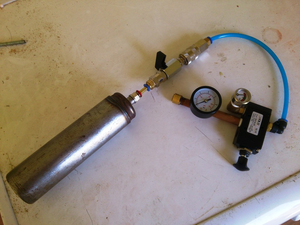

Kind finished the fuel meter, missing the fuel meter gauge still.
The "thing" on the left is a flow control valve to reduce the flow from the propane tank. The tiny gauge is for viewing the pressure inside the pressure tank.

Well, finished the meter and has all the rest planed.
The 5/2 valve didn't work the way I wanted, but well, I can live with it the way it is now. (too lazy to find a solution, it's bloody hot in my work shop)
BTW I used 2 layer of foil rather than 1 for once and I definitely got more power.
The black &amp;quot;thing&amp;quot; holding the bottle is not tap but heat shrink.<br />Big gauge is for the meter and the small gauge is for the propane tank.
The black &quot;thing&quot; holding the bottle is not tap but heat shrink.
pull the bottom to fill the meter, push to inject the metered fuel to chamber
