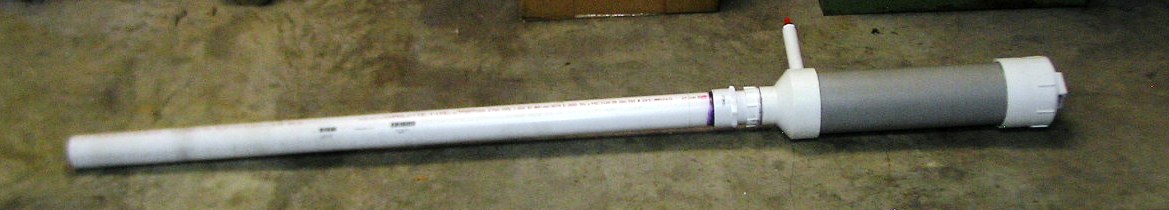

This weekend I made my first Spud Cannon and the test fire went great.
4" dia combustion chamber, 19" long effective (17" pipe cut length)
2" dia barrels, screw-on, 49" long and 73" long
Hair spray propellent (AquaNet)
BBQ piezo igniter
The test fire went over the trees in my backyard (~100ft) and deep into the woods (3 acres). Later this week or next weekend I hope to get out where I can measure the distance in an open field.
Is this Chamber to Barrel ratio reasonable for a hair spray cannon?
New Member - Test Fired my 1st potato today!
Today (Friday 7/12/2013) my friends and I had a chance to do some test firing!
With the 4 foot barrels we consistantly got 198-210 yards (600 ft) with potatoes. Then we put a little bit more hair spray in the chamber and we got 200-250 yards. The longest was with a 2.5" barrel (48") and a longer shot of hair spray. It went almost 300 yards.
While the 2.5" barrel was on the launcher, I put an old tennis ball in and it went about 300 yards but we didn't have a confirmed landing spot. That was the only tennis ball we had, so one data point.
I also tried a few shots with a 2" barrel 73" long (6 ft). There was some variation due to wind and tumbling, but it seemed to be good for 20-25 more yards than the 2" dia, 49" barrel.
Lots of fun!
Lots of fun!
4"dia x 19" Chamber, 2" dia barrels, 49" and 73" long, Hairspray & BBQ piezo igniter
