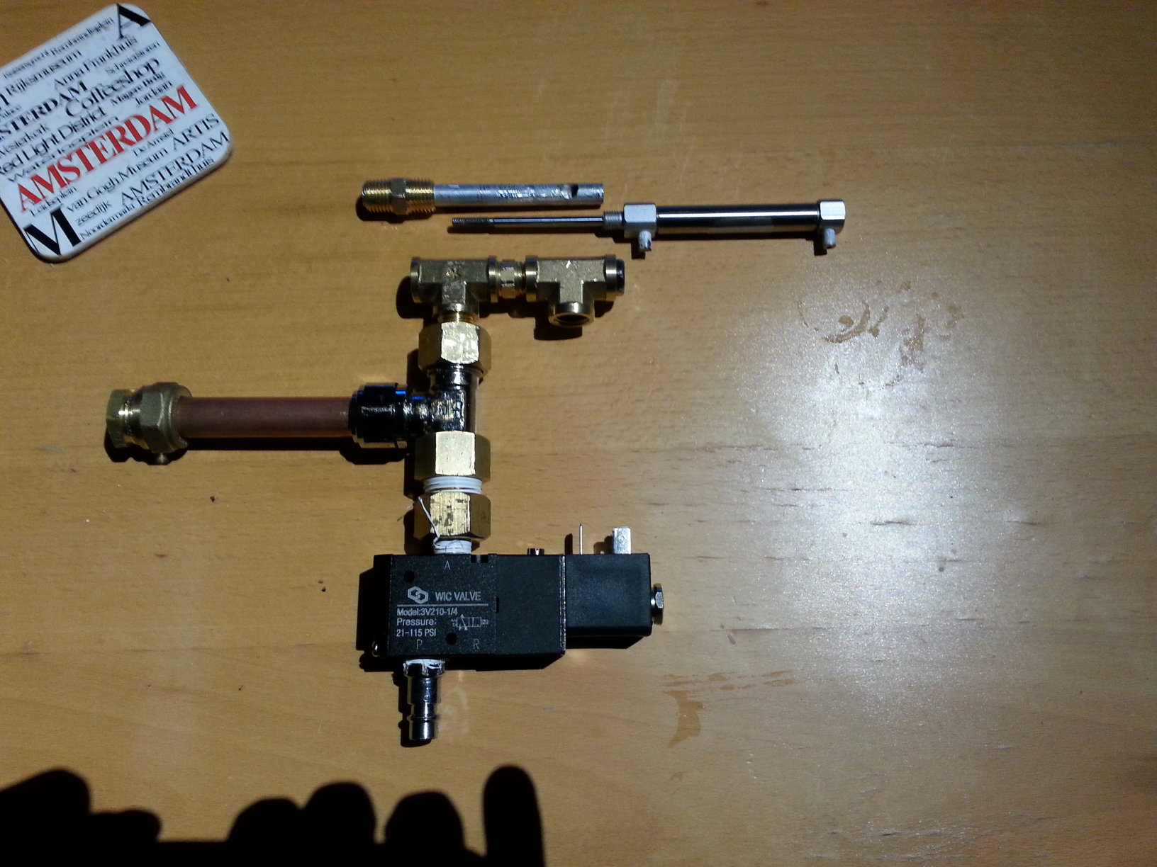

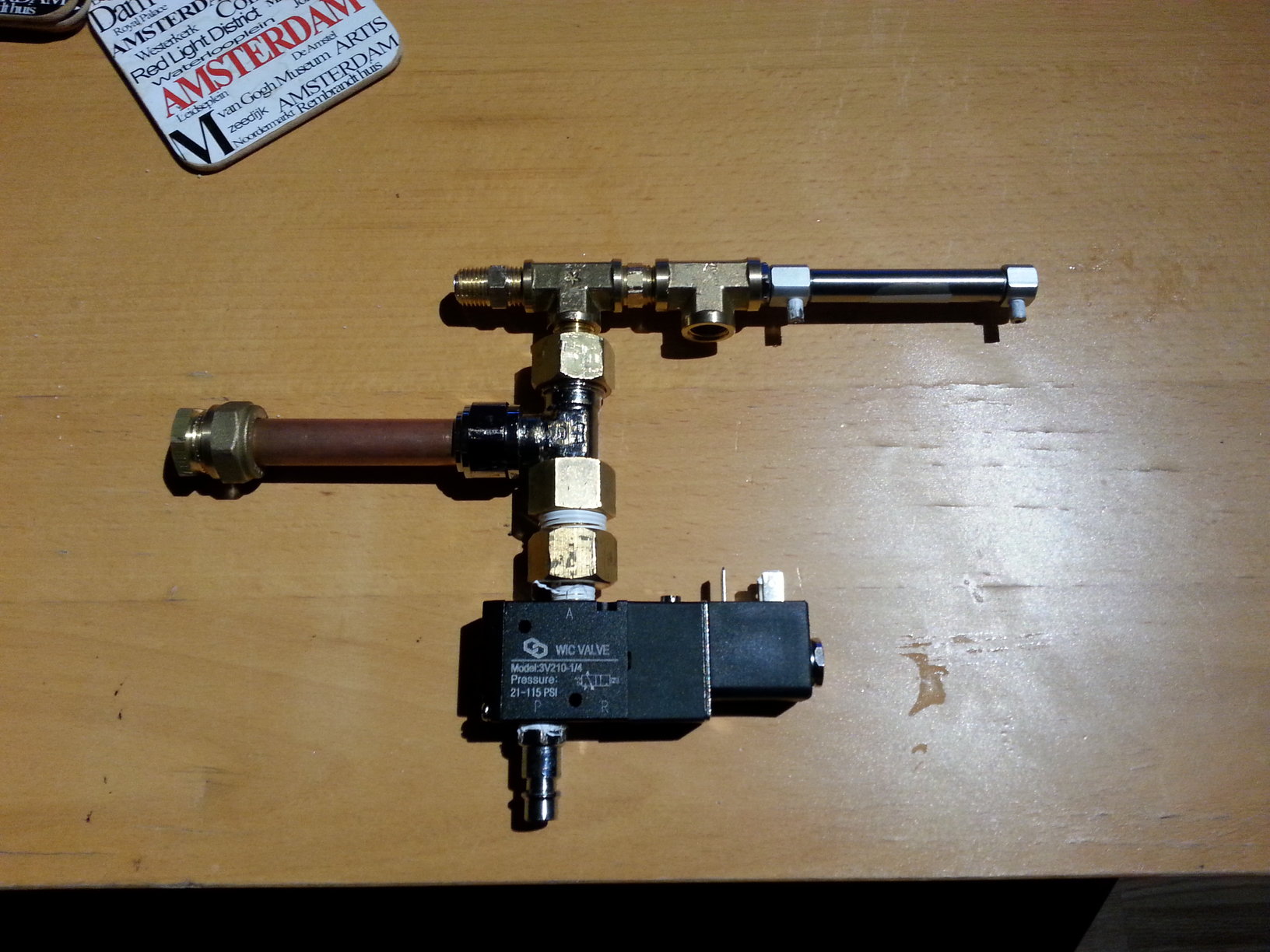

Two pics! getting there:P
Assembled
Assembled
Air cylinder and the bb feeding pipe,

Somebody actually not just post a fancy diagram but also the real stuff! Congratulations :thumbright:

I think it would be easier to build the magazine in front of the T but that would maybe reduce the flow when the piston resting in the breech?
But less dead space?
I could ad a 5 way solenoid to take care of the loading cylinder!
Just ad a delay in the arduino sketch so the bolt would hold it in forward position for some ms and then release and pick up next BB.... and so on!
More complex but then you could tune the reloading and fire rate digitally.
Any thoughts?

I agree with wyz, congratulations on actually building it! Its beautiful!! The idea about the 5-way valve is great if you can pull it off! Awaiting a video ;)

I think i can do it!
But the hardest part will be the programing:P i dont like it:P haha
Will upload some spudporn later today and show the solenoid controled by the arduino:P
