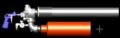

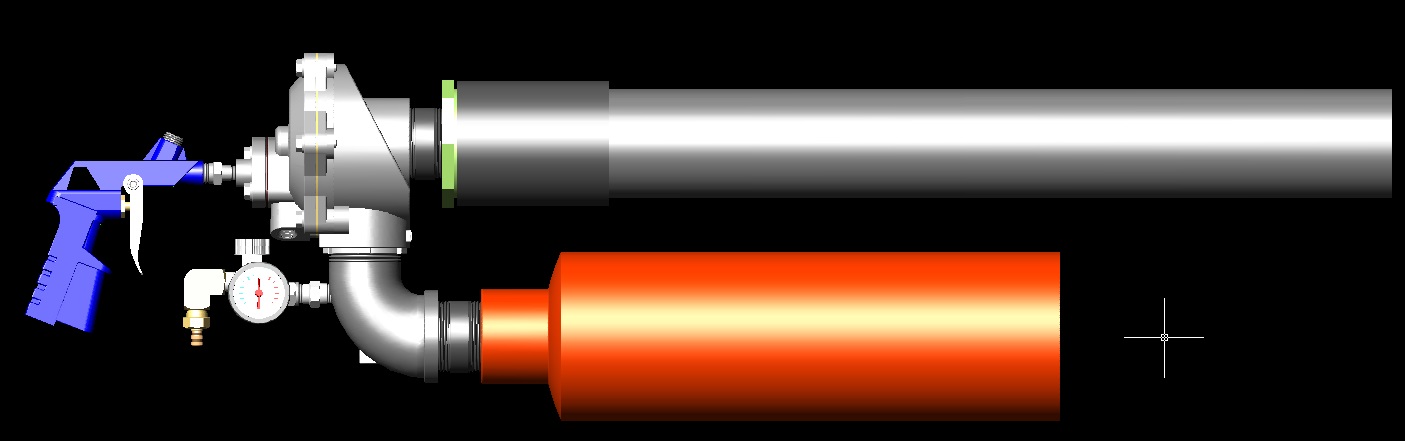

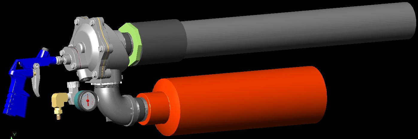

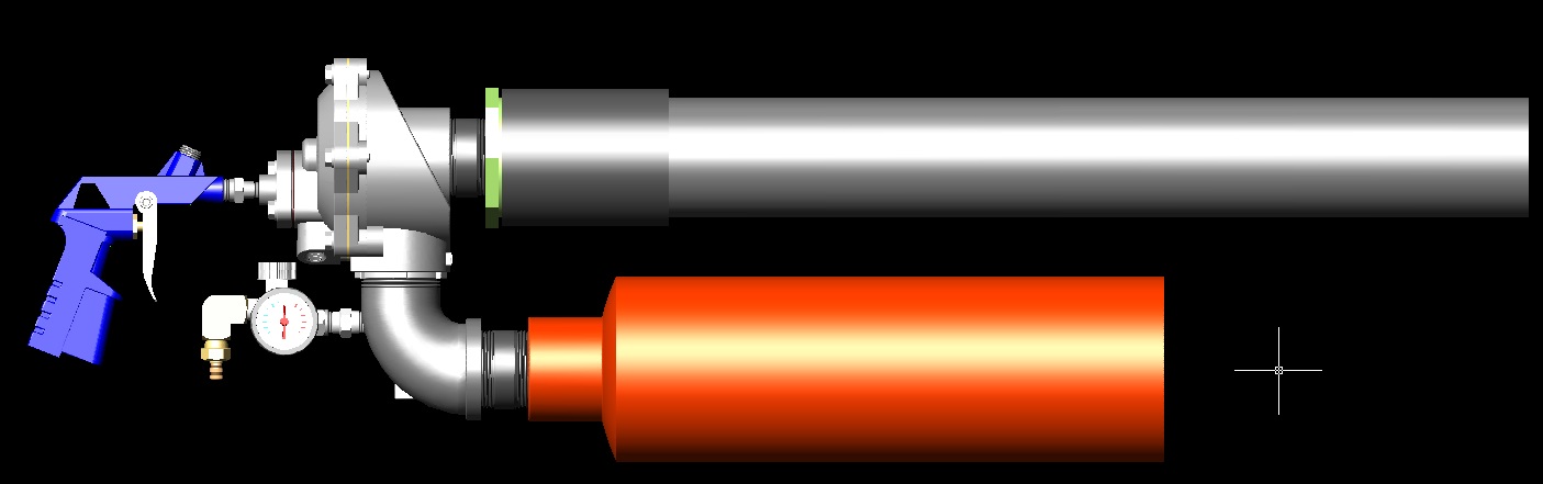

A flow regulator will control the "fill" rate and be much cheaper and smaller than what dart guy is proposing.
http://www.harborfreight.com/125-psi-ai ... 68219.html
You can see one in the 3D model attached.
The overall length of this model is 36 inches.
Edit to update drawings

The real benifit is the small guage that is on the flow regulator.ascientist wrote:dewey-1
I just plan on using a schrader valve to fill the chamber, so I don't think I will need the extra valve or a regulator to fill it.
Harbor Freight sells them cheap. You can still use a threaded Schrader valve.
You will need the gauge so you can adjust the pressures for different ranges of distances. Example: 50psi may be 400 feet, 30 psi may be 200 feet.
Also with a guage you will know if it is "armed" or not.
