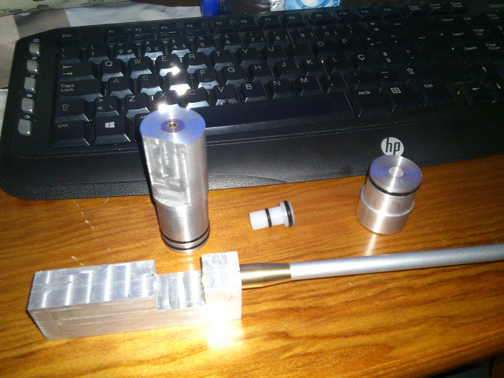

A very close friend's birthday is near, so I thought I'd give him something cool.
So I'm making a 5mm smooth bore PCP pistol( probably will have a butt stock though).
Also made a kit to make 5mm lead pellets, all parts made from 32 OD aluminium cylinder, the cup for melting lead is bored out for the same cylinder, just to not wast the left overs

How did you make the cap for the schrader valve? What tap size did you use?

I ddin,t tap it myself, just used one ofthese, lathed it down and epoxied it into the cap, voila.How did you make the cap for the schrader valve? What tap size did you use?

Ah, same hereI ddin't tap it myself, just used one of these, lathed it down and epoxied it into the cap, voila
I also made a new one, 4.5mm
