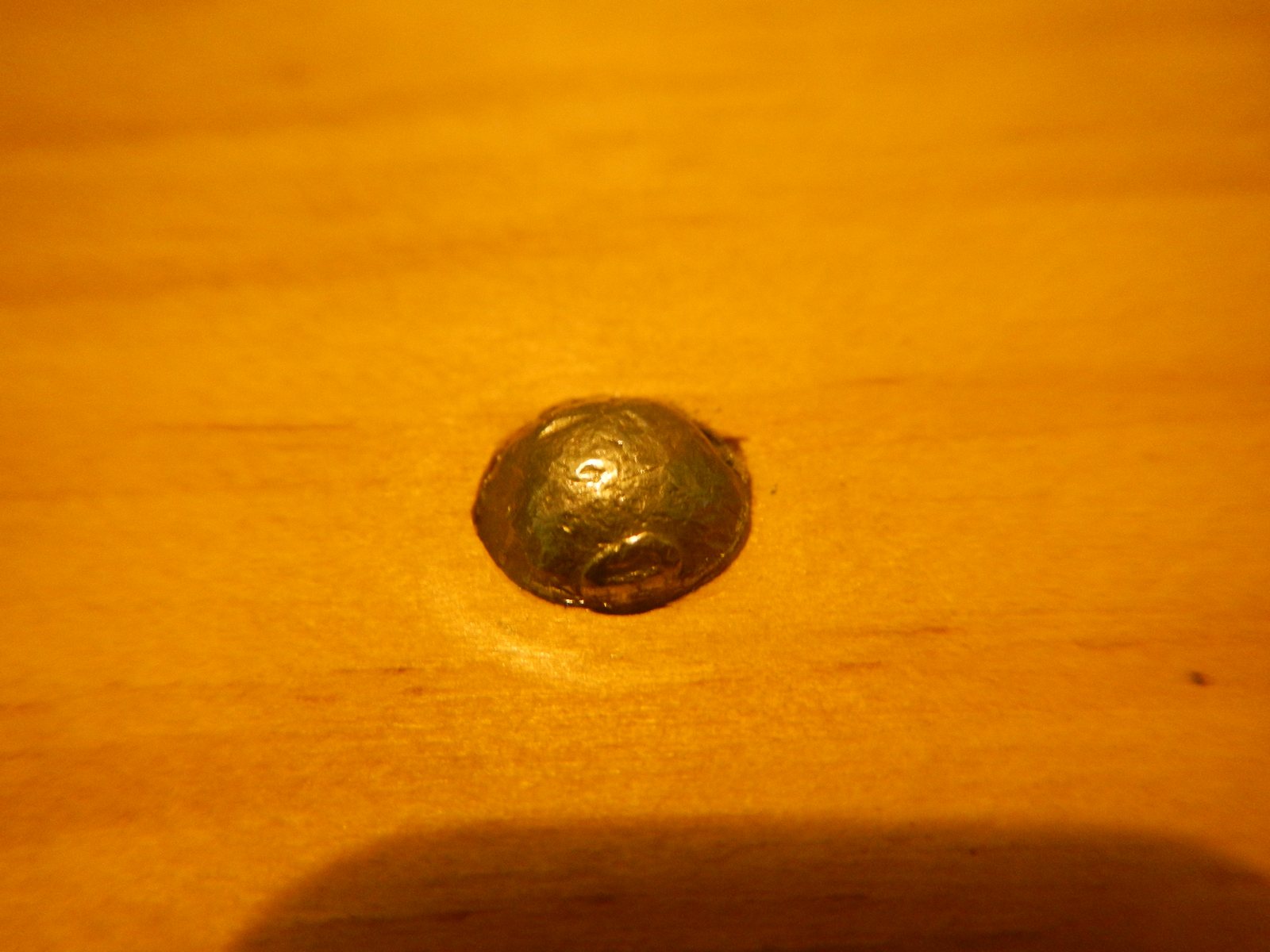

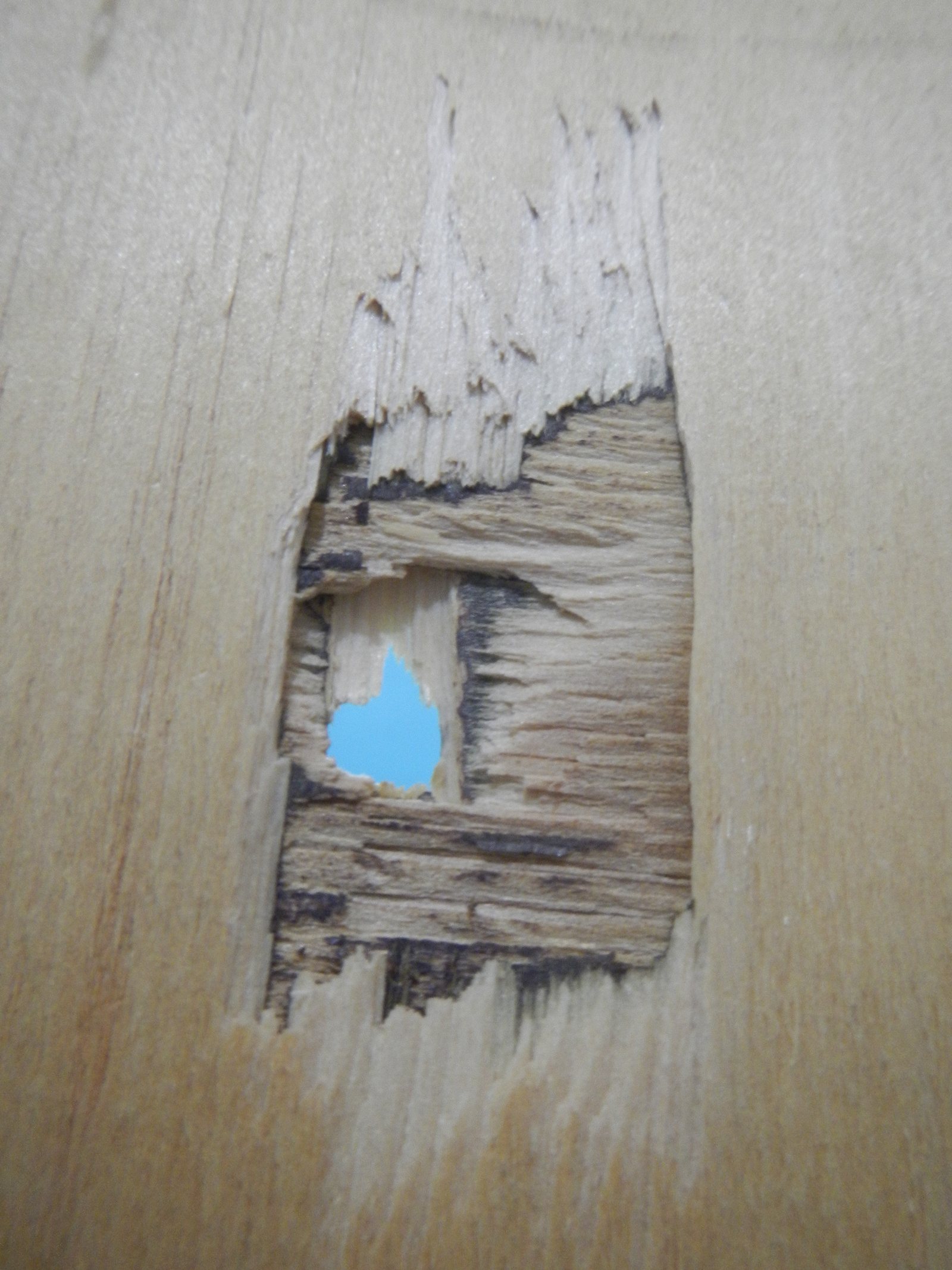

Heres a few photos of my test today, the first was at 100PSI and the sinker half flattened but only left a small dent maybe 3mm depest probably closer to 2mm, it just bounced off and across the room, the second test at 180PSI you can see the sinker is more than half embedded in the bed slat, this was from close range (around a meter).
This wood is fairly solid its an old timber bed slat.
I tried on some 8mm plywood at 180PSI from about 4 meters and it went straight through (last two pics).
8mm Plywood
8mm Plywood
8mm Plywood
8mm Plywood
180PSI
180PSI
180PSI
180PSI
180PSI
180PSI
100PSI bounced off with small dent
