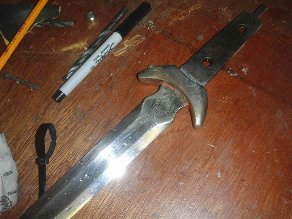

Edit; to make this post more useful, here's something relevant I made a while back.
(what, you didn't think I'd been doing nothing at all while I was away, did you?)
Total length ~ 16 inches
Rough edges were done with an angle grinder
Grooves were made with the end of a belt sander (Obviously the sander wasn't running during this shot but you get the idea).
I stamped the imperial legion emblem on here because I am a giant dork.
Used the new foundry to heat treat this one. Also tesed out those thermocouple multimeters that harbor freight sells.
Made a crossgaurd out of a big crane bearing. This was the same one my hunting knoif was made from
Shineh
Shineh
I just threaded some tiger maple blocks and bolted them onto the tang when sanding it into shape. The pins that were put through them later were also threaded.
I smeared some red high-temp silicone on one side of the joint before soldering. This was to keep the solder from dripping out when it was clamped upright.
The rest was easy.<br />The pommel was fitted by blackening the underside and pressing it against the grip. Wood was removed where it left a 'print', until flush.
The rest was easy.
Final product. Still needs a sheath.

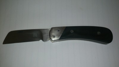

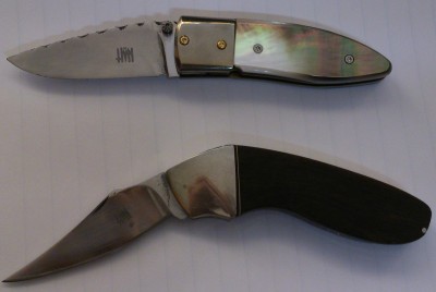

Here are 2 small pocket knives my dad is busy making that is not completely done yet....
The voices in my head may not be real, but they have some good ideas!

jackssmirkingrevenge wrote:That's a pretty awesome Dad you got there :)
Those screws look like they were taken from a Nokia 3310...
hehe those silver coloured screws were recycled from old hard drives, one place to find that size screw, the other golden coloured screws are actually bought screws that is gold plated...
Edit:
another WIP pic:

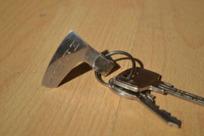

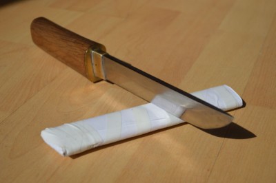

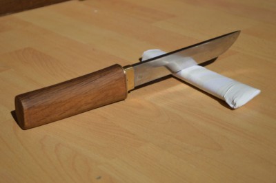

Here's my first try on knives. Its made out of an old file. Blade - 180 ,handle - 130 ,thickness - 7 mm . For now im too lazy to make saya :( . And a keyholder just for the lulz
