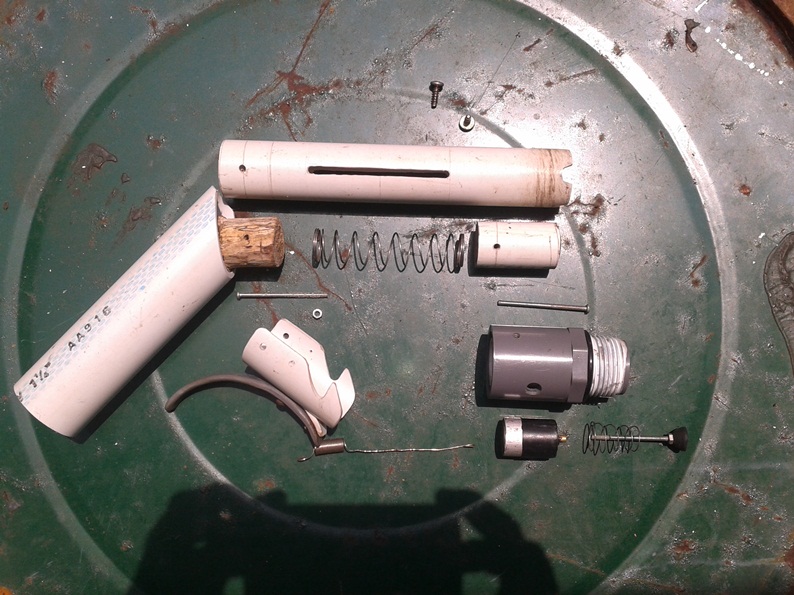

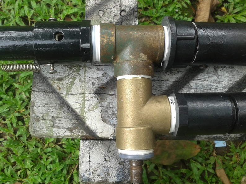

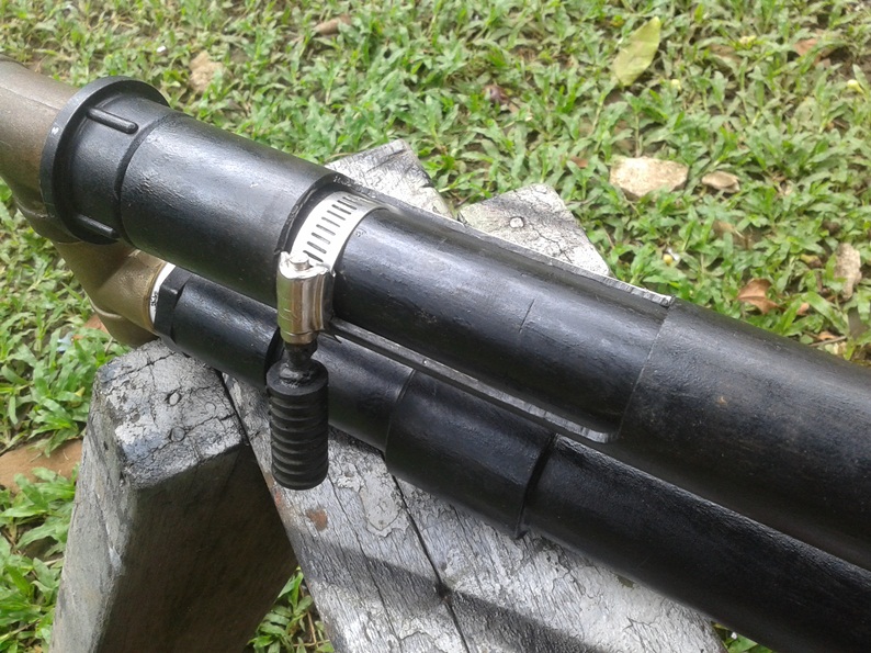

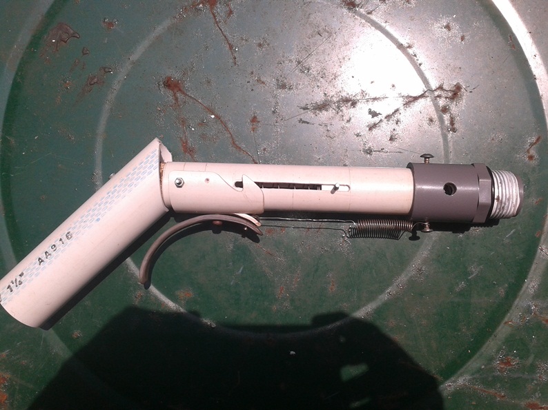

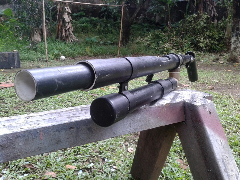

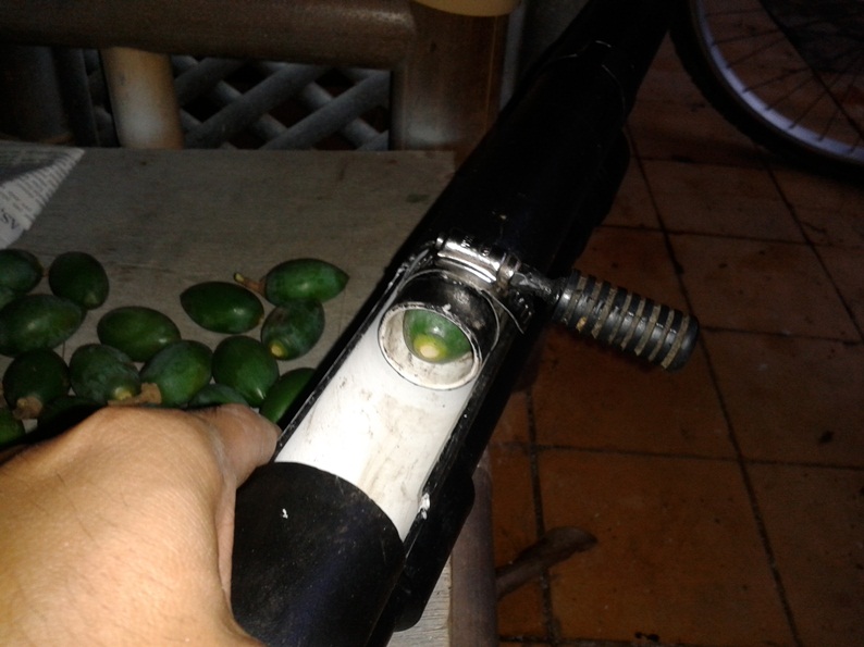

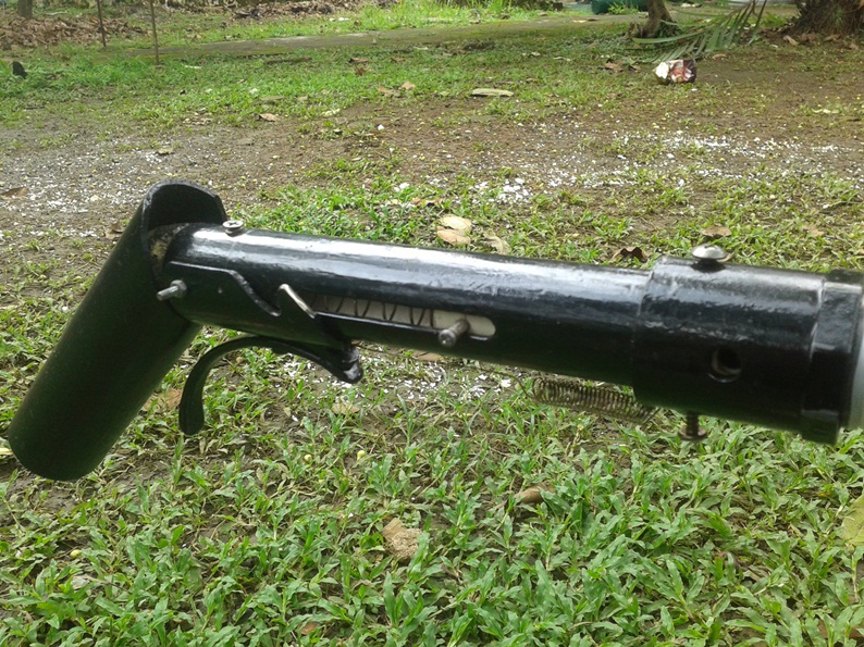

Hi guys, this is my new gun, scaling up from my previous gun. It is 3/4 inch piston inside 1 inch brass T with 1/2 inch seat. The barrel is 1 inch, used max with 80 psi
. Multi shoot (attached to commercial air compressor), chamber filling, hammer valve for piloting, breech loading.

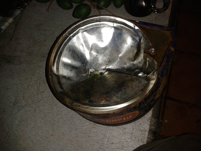

haha, i see you use those fruits as ammo, i used some local forest fruits and olives kernel . i was able to penetrate both sides of a big metal olive canoneocim wrote:Hi guys, this is my new gun, scaling up from my previous gun. It is 3/4 inch piston inside 1 inch brass T with 1/2 inch seat. The barrel is 1 inch, used max with 80 psi. Multi shoot (attached to commercial air compressor), chamber filling, hammer valve for piloting, breech loading.

Thank you jack. Yes, it is ghetto, i should practicing more on painting and stock making. I know I have seen that kind of post here but can't find it anymore.
And bravootome, free ammo, nothing better, also helping the environment for planting more trees ha ha. My gun is not so powerfull so most seeds are intake. According to GGDT I should be able to plant tree 185 m away.

if so, i should of plant a forest till now,ha. you should use more pressure, like 300 psi to have more consistent shoots
