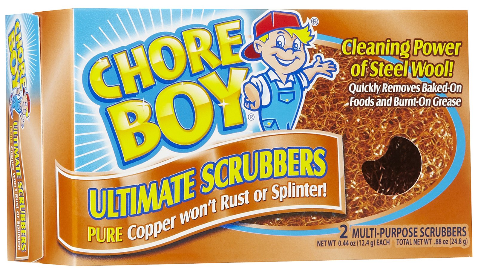

A large volume suppressor packed with heat absorbing material like steel wool (not too fine or it will burn!) can make a significant difference if done well.
