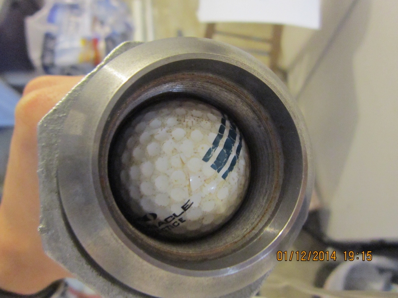

I think I've found a great, accessible material for golf ball barrels! I took a ball to the hardware store to try to fit it in some pipe, and came across 1.5" IMC (Intermediate Metal Conduit). It's basically the perfect barrel; its only flaw is having a seam running down it, which really shouldn't be much of a problem. The length of pipe I found cost me $25, which isn't bad for a 10 foot barrel, and comes threaded, 1.5" NPT. Golf balls are also a super tight fit, so tight that they can't roll down the length unaided. It's very easy to push a golf ball down the barrel with a ramrod, but the barrel won't require a detent, which is good news for the lazy ones such as myself.
I found my pipe at Ace Hardware, which is pretty widespread around the US as far as I know. The internet also says that Home Depot carries 1.5" IMC, so it really shouldn't be too hard to find.

I haven't seen IMC in any of the places I usually shop, but will look for it. It would screw right on to my 1-1/2" EMT barreled hybrid as a replacement for the EMT. It would be heavier, but since that cannon is already almost 20 pounds even with a not too long barrel, I guess the weight battle is already lost on that one
It sounds as if you like the fit, but running a hone through it might yield a "drop in" fit if that is desired. I have found that a brake cylinder hone works fine for about that size and can be found cheap ($6 from Harbor Freight).
Alternately, I found that with EMT, ramming a pipe or dowel with a big wad of steel wool on the end through it several times, smooths it out a lot. I expect it would be the same for IMC.

Nice find! I love being able to source "off the shelf" stuff intended for "real world use" for our hobby whenever possible - it's usually always cheaper.noname wrote:I think I've found a great, accessible material for golf ball barrels! .......
- Gun Freak
- Lieutenant 5
- Posts: 4971
- Location: Florida
- Been thanked: 8 times
Likewise!I love being able to source "off the shelf" stuff intended for "real world use" for our hobby whenever possible
I was gonna ask what your barrel was! Good to know.
