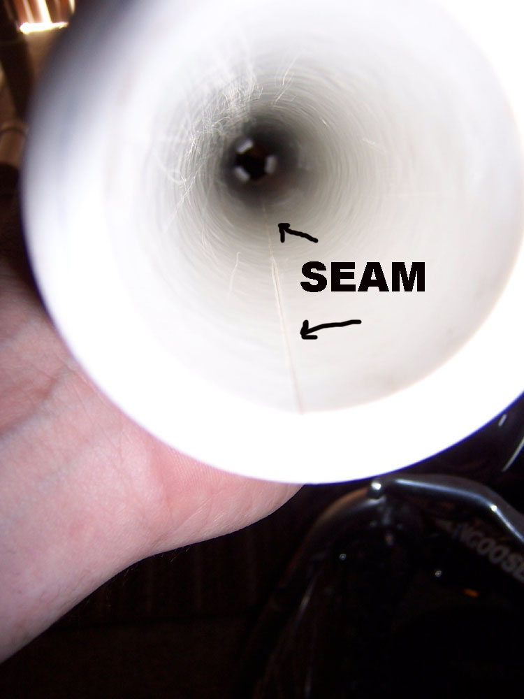

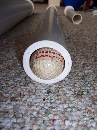

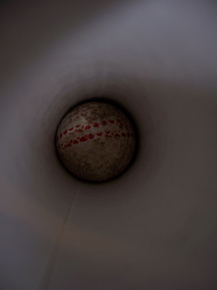

Made one just the other day, it was a bit of a chore cramming one pipe into the other.
Originally slated to be 48" long, the pressure rated s40 PVC shattered at one point so I was forced down to a 32" barrel. All in all, I think it came out fairly decent, with the proverbial 'gap' being very minimal. I also used small pieces from the strip I cut out and glued them inside at the breech end as a ball stop. I have yet to use it, but I'm sure it'll be pleasing. I'll let you know. -Lp
Minimal seam
Minimal seam
Seems just right.
Seems just right.
Not a bad fit!
Not a bad fit!
