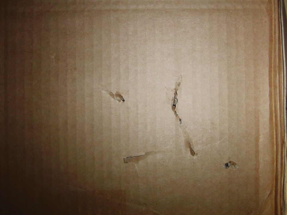

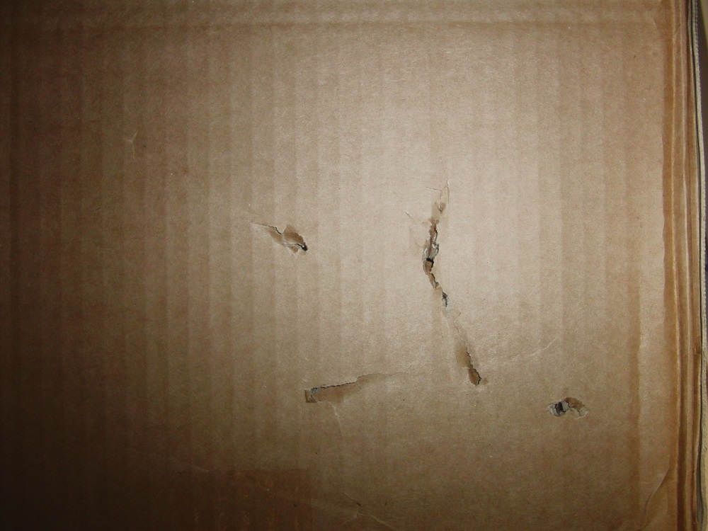

edit: I was unable to replicate your results at 15 feet, here's 5 shots fired head first at a cardboard box:
I tried different bits and got the same results, even when firing them tail first - none of them flew straight.
I would surmise that you're not seeing the tumbling because of the high velocity and short distance.
Have a look at this unstabilised unrotated projectile fired at supersonic speed:
It starts to tumble immediately, but for the first instants of its trajectory it is still travelling more or less straight enough to make a round hole in a target.
