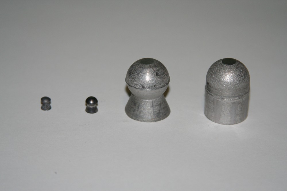

Only made the one to prove a point...it punched a round hole though.
My thinking is that the diablo slug IS slightly better for smooth bore airguns than the foster slug. Less drag in the barrel, and the skirt obdurates easier to seal the bore.
Greater angle exposed to airflow should also increase stabilization forces...minimizing "wobble" and working well over a broader velocity range.
BUT....having made both types...the foster slug is a heck of a lot simpler to make an effective mold for.
Dr. Beeman wrote:The diabolo shape of modern airgun pellets was developed empirically early in the 20th century. The key reason was the simple matter of greatly reducing friction in guns which had so much lower power than firearms. The diabolo pellet has the minimally required two stabilization points, fore and aft, but no friction between them.
Concomitant with this was the concentration of weight in the head which is a trick used by the developers of many other projectiles: sabots, "mini-balls"., lawn darts, badminton shuttlecocks, etc. to stabilize the flight of the projectile.
And, as a very large bonus, perhaps realized at time, was having a thin skirt which would be expanded, even by the relatively weak blast of gas from an airgun, to nicely seal the projectile into bores of such widely divergent sizes as those of German and English airguns of the supposedly same caliber.
