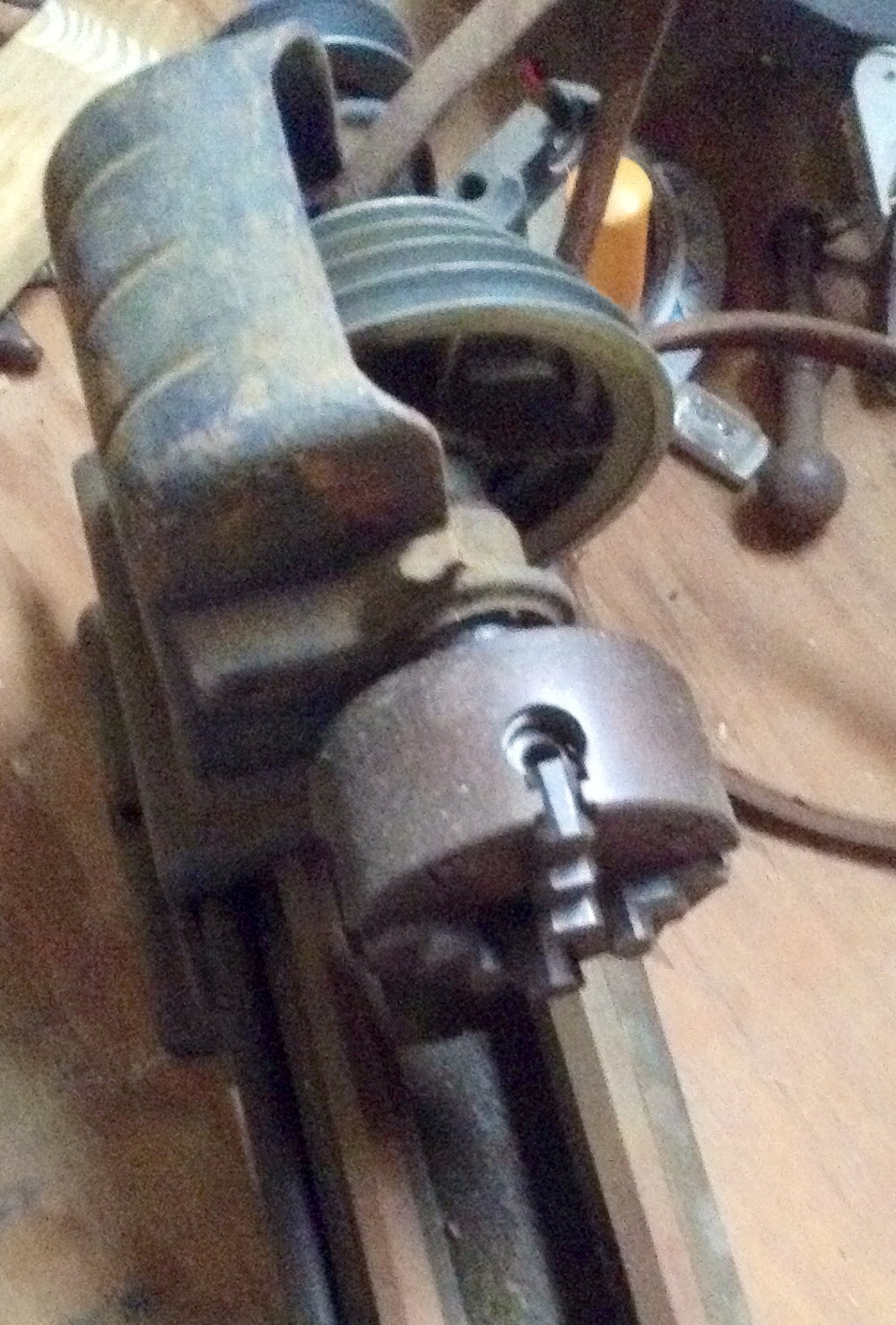

Hello machinists, I got some problems,( make fun of me after my problem is solved) I got a small metal lathe, most likly not going to be turning any thing larger than 4 inches, although it is small it is completely manual, but it has some missing parts, like the centers, probably some bits, and above all a motor, it is relatively old too. Can anyone post some picks to help explain metal lathes to me? Also any tips or tricks on using it? Also is there any tools that you would call mandatory? Wouldn't mind having a friendly machinist make me a live center?( just kidding :D )

it is small like maby 3 feet long.
when life gives you lemons... make root beer and leave the world wondering how you did that :D
Looks like a Delta Wood lathe conversion. How are the bearings? Smooth, rough, sloppy or tight? From looking at the pictures you need: moter and cone pulleys, tailstock lock. Build a motor mount with belt tensioner. Give it a good cleaning you might find a ID tag...
Start searching ebay for parts, motor and pulleys can be some what universal as long as the pulleys are close to the same size and the motor should be about 1/3rd horsepower max RPM 1250.
If you didn't pay much for it say 100 or so looks like you're off to a good start.

It was free and it has everything in smooth working order, found a motor, possibly, the belt is killed, and the wheel for the move ing of the carving thingy is just a little squeaky,.
