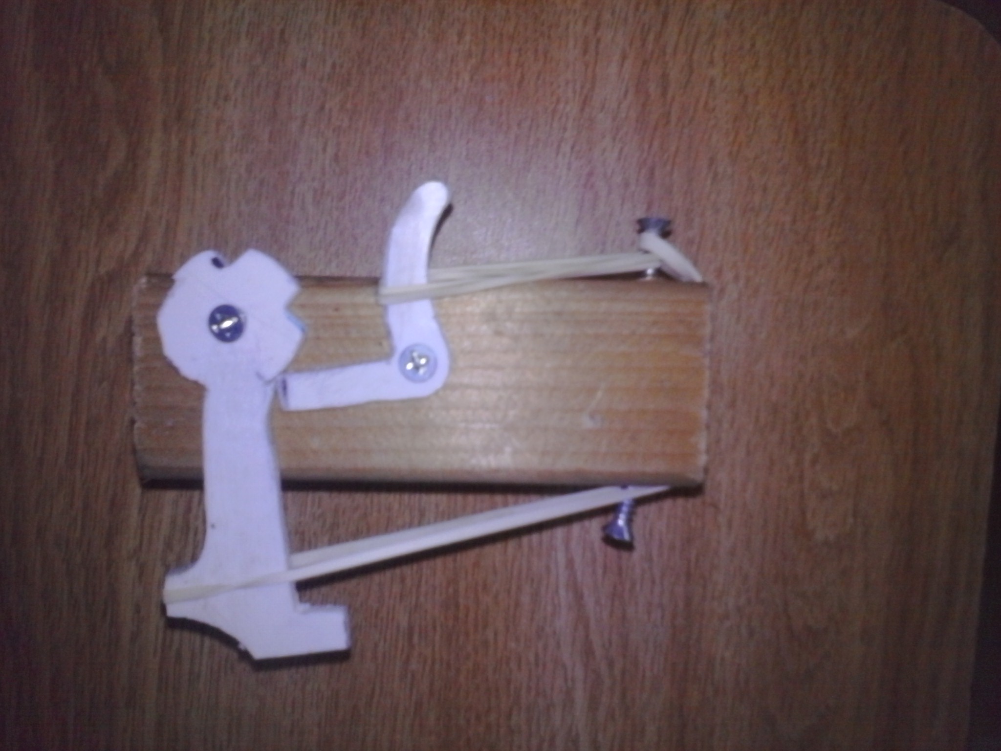

My intent is to tweak the design below from the pistol with handle to under-over style like the gun with no handle. This one has a rubber tube connecting pump to pilot area , this gets changed out to a brass connector. I'll move the exaust valve to the back , and smack it with my revolver-style hammer ! My reason is the if the one-way valve on the pump fails , the pump rod will eject toward the user. Not what I want to have resting on my cheek. So the volly gun below will turn into a huge under-over pistol with "revolver-style hammer" pilot trigger.Eh?

I've been too busy with "life" to finish my hammer mechanism , but I made this update incase someone is interested.
Re-worked pump and chamber attachment (now brass) and moved pilot vent button to rear.A medium rubber band on the proto-type hammer (photo above somewhere) was enough force to pop the pilot nicely at 80 psi ! Can't explain it all now , kid just woke up crying.
