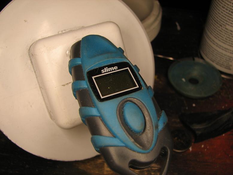

Can you convert a cheap tire PSI gauge to work on our cannons some how? Im thinking about putting one on one of my carbide cannons to gauge the chamber when it fires. I have a few of the tire gauges, not sure how high they go though but i thought it would be smaller and look a little more high tech then a big round analog one with a needle that everyone else uses.
I have a few extra 4" caps i could cut the valve stem off and then cut it down and just glue the stem right to the meter then screw it on and fire it.
I may not even need the valve stem though.
Digital PSI gauge?
ok never mind im just going to take one for the team and try it.
I had this old slime PSI gauge the battery quit so i tore it open and found the battery was soldered in, i managed to rig in a new one. So now it works.
A little research found that this gauge is rated for 5-150 PSI perfect, im either going to be under 150 or error it out wich i dont think will happen my cannon wouldnt even still be working if i hit that high of PSI.
I drilled a little hole in an extra 4" cap i have, pushed the stem from an old wheelchair tire ive since replaced and cut it down. Then i used shoegoo (because i love that stuff, that and liquid nails) and i shoegooed the gauge right to the back of the cap over the stem. I used the PVC pipe cement on the inside between the PVC and the valve so its sealed on the inside with PVC cement and shoegoo on the outside to the gauge.
Anyone want to take some predictions on how much PSI im pushing with my 4" carbide cannon? Im going to guess 80psi using a loose fitting tennis ball. Im going to figure 60 without any projectile.

- The cut down valve stem and the gauge air inlet
- Digital pressure 2.JPG (36.65 KiB) Viewed 7779 times

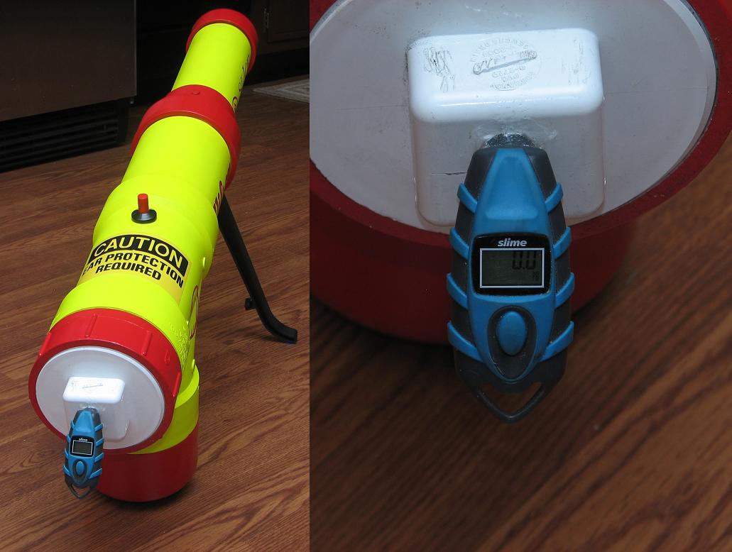

- gauge mounted with the cap as some extra support
- Digital pressure 3.JPG (38.43 KiB) Viewed 7779 times

I think this is like a powder scale, as you first apply the gauge to the stem it reads the pressure till the change in the pressure stops then it locks on that number. If you touch it again any change in the pressure value will readjust and display the new value.
I thought there was a sort of button in the gauge that not only pressed the valve but then pushed a button on the gauge. Its just a hole right into the pressure sensor. It should work reguardless of leaks as long as im not over 150 psi
Ill find out though
Here is my setup
Ill find out though
Here is my setup

I predict you will destroy it
