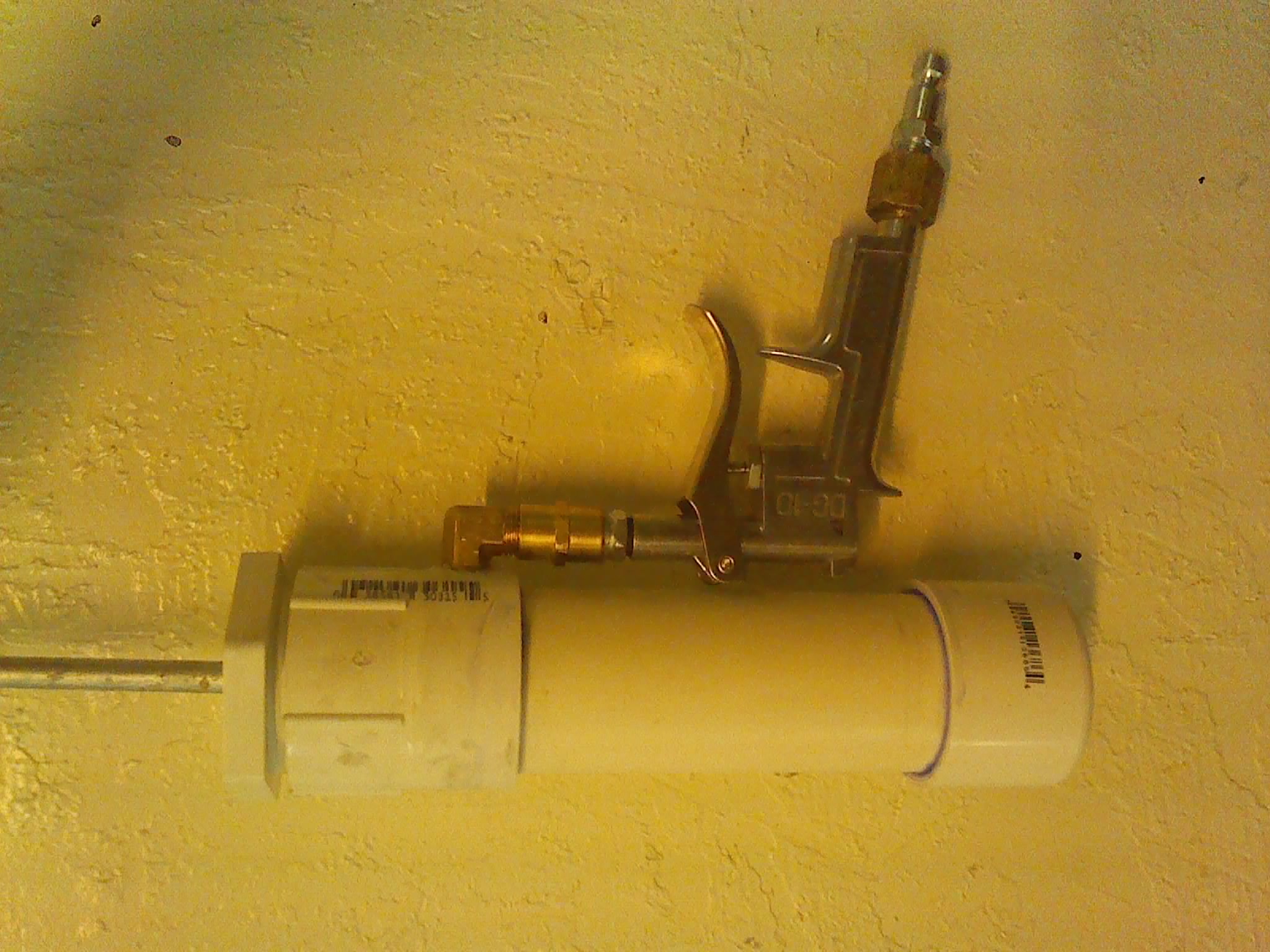

I'm experimenting with several bbmg designs and I have some questions. After much research I've yet to find any discussions about how far inside the chamber the barrel should go on a cloud design. I've seen designs with the barrel barely into the chamber and I've seen some where the barrel went almost to the back of the chamber.
Well...which is the best?
I would also like to know if anyone has found the optimum barrel to air input position. Basically I'm just curious if anyone had found the best spot for the air to enter the chamber. I've seen them toward the front of the chamber and the breach end of the barrel toward the back of the chamber. I've also seen the air input directly below the breach end of the barrel.
Has anyone found that one configuration seems to work particularly better than another configuration?
Thank you for any insight you may have, I just wanted to ask the knowledgeable people here before I built three or four chambers to experiment with. This particular one will use airsoft ammo and a piece of brake line for the barrel. For my final design I'd like to use a real airsoft barrel.

- This is basically what I'm going to experiment with before I build a more advanced version. I would like to be fairly confident in my design before I build anything too extravagant.

Frankly as long as the barrel sticks out a little into the chamber, and the air flows into it in such a manner that it directly agitates the main mass of BBs, it doesn't really make a difference.
Here is basically what is happening in slow motion:

That's exactly what I wanted to hear! Like always Sir you are a wealth of knowledge. Thank you.
Well then mostly I'll have to experiment with the chamber and air supply volume. I have an old backpacking frame I'm going to turn into a portable air supply. I have a bunch of 3" sch 40 laying around. I'm going to start with about a gallon and a half or two gallons at 100-120 psi and see what kind of run time I get. I will test it with my smaller 3 gallon air compressor at 100 psi and start from there. I think that will give me a good idea of how large of air supply I need. I may add a pressure regulator to allow me to trade runtime for power and vice a versa. I would like to get 20+ seconds of runtime. Of course more is always better.

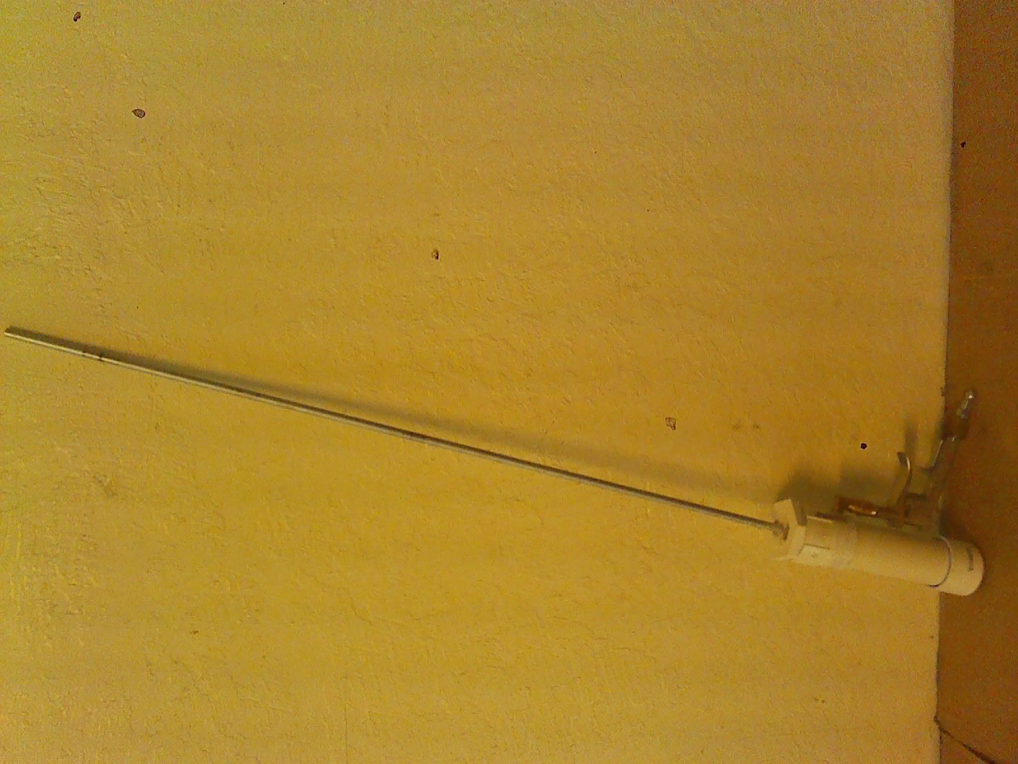

Edit... Well I tested my prototype. It feeds great but accuracy isn't what I would call spectacular by firearm standards. For airsoft it probably good enough. The rate of fire is much slower than my tube feed .177 bb gun, but this one will sustain fire for much longer.

- This is my first BB gun prototype

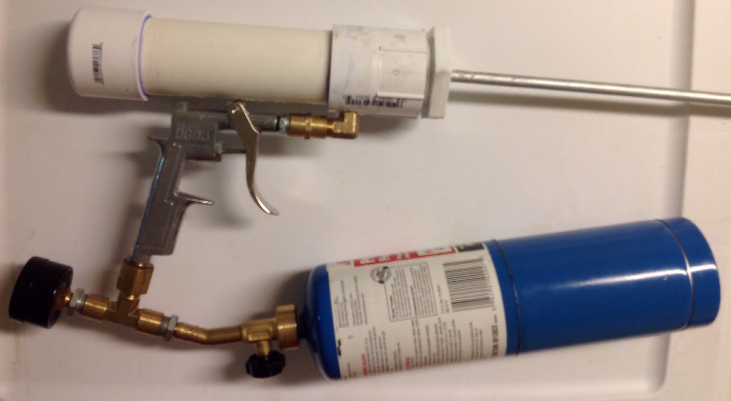

A better valve is definitely in order. This was mostly built with scraps. I'm going to test this out tomorrow ( because my propane tank is empty today

Hopefully I'll get a chance to test it out on propane power later today. I have a feeling the propane tank will outlast the backpack, but won't have quite the power due to the nature of propane. It rarely gets over 80 degrees where I lived and propane expands rather slowly.
