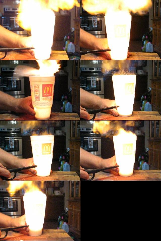

Check it out, lucky no one was hurt.
Careful sir, our coffee is extra hot today! :alien:

My point is that is styrofoam! i tried and tried and i couldnt even crack it.
I really figured the first shot would blow it apart and water would fly everywhere so i first tried it in the sink. 3 times nothing.
Ill try taping 2 cups open end to open end and then cut the bottom one out of the top one to increase the velocity and see if i can get it to split but the pressure of the explosion wont even damage these cheap cups.
Two points.
1 The cup is not styrofoam. It is a drink cup, but not foam. It is a lot stronger than styrafoam.
2 The gas air mix was quite rich. It was a flammable mix, but short on Oxygen. This is noted by the length of the burn and color of the flame. The heated gas exited the cup and then burned above the cup as the gas mixed with more air. Note the location of the flame in the still.
A leaner mix would have more bang to it.
Watch someone light a welding torch sometime. Without oxygen turned on the flame is large, yellow and sooty. Add Oxygen and that all changes.
In summary, he was lucky.

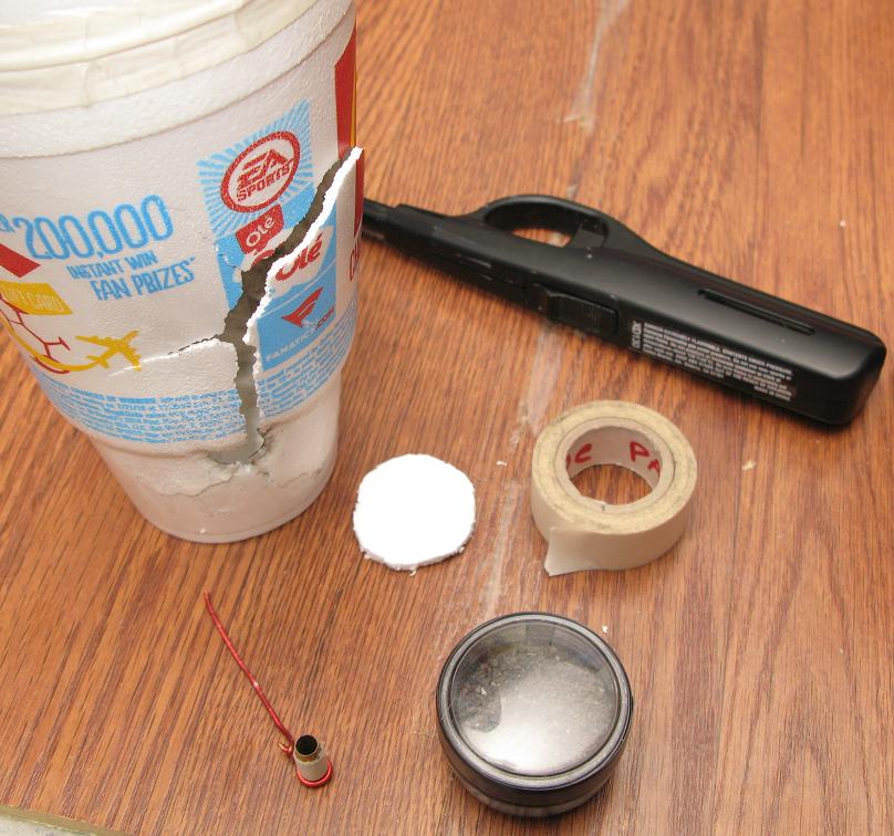

So much for that, i taped the bottom back on and cut a smaller hole, didnt help much then put the carboard over top and then it cracked. I tired some hairspray in it also to see if i could tell any difference i swear the hairspray just seems slightly less energetic.
I need a new cup now my fun is over for the day.
