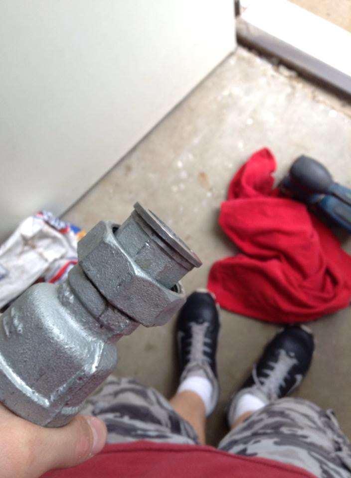

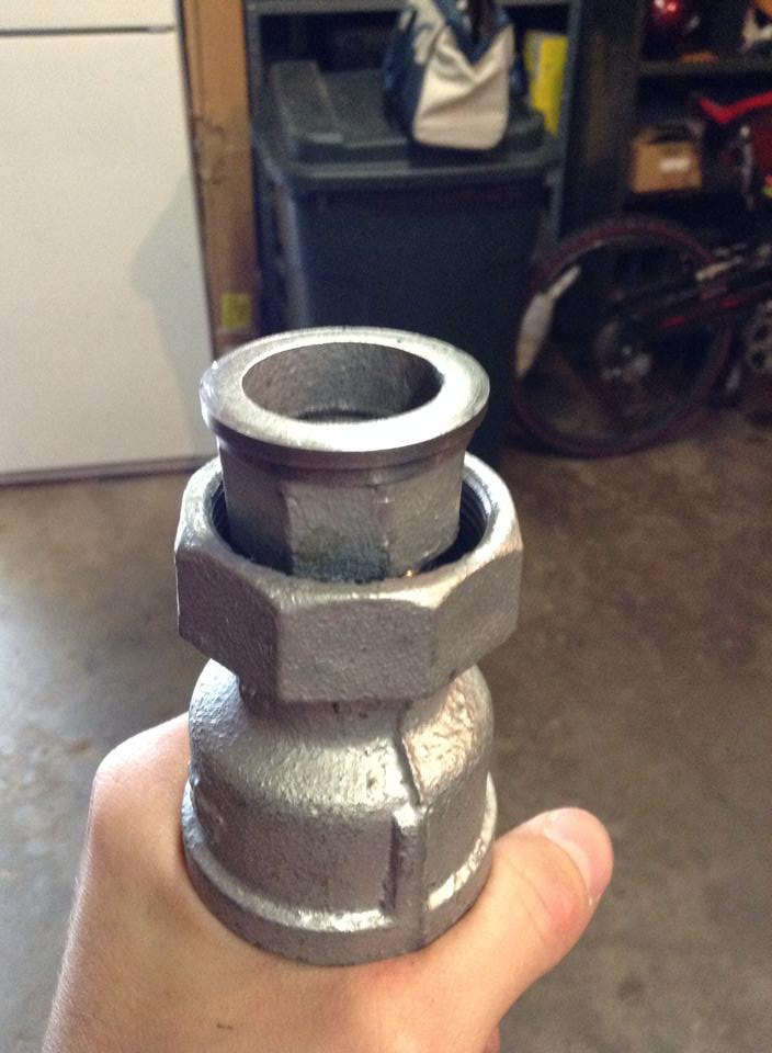

I'm not sure what else to say about it, it only cost about 30$ (45$ with the stun gun and syringe), and I think it turned out quite well so far. I'm not yet sure if I want to make a stand for it with some sort of recoil reducer or just try and fire it handheld. I modified the union using a dremel, to grind it down, a file to even it out, and a sander to smooth it (it took a good 1 and a half hours) but I think it turned out well :)

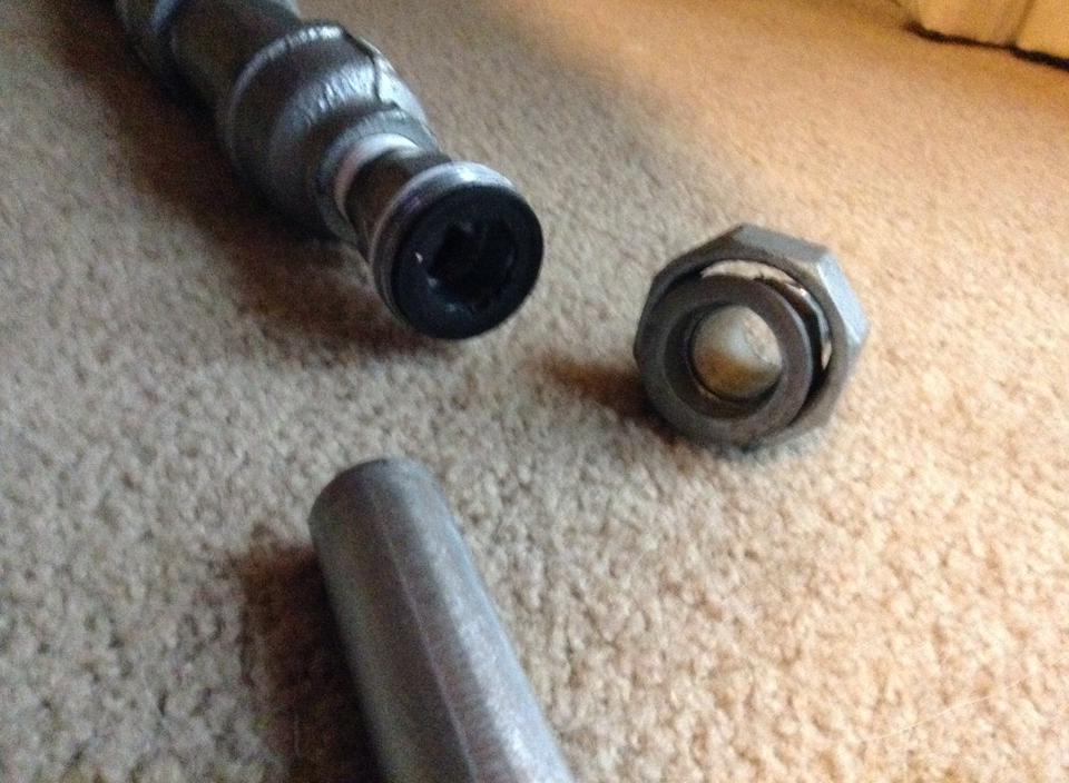

Union setup: I cut up a thick rubber washer for the gasket
Fueling system
Fueling system
The union (It's direction is reversed)
The union again
The union again

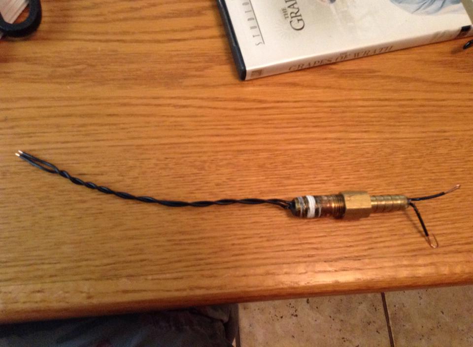

I finally got everything pretty much sorted out (kind of), I pretty much just redid the spark plug and measured the volume of dead space to my pump. The stun gun is somewhat restricting though, so my next step will be making a nicer ignition circuit and implementing some sort of remote firing.
New sparkplug
New sparkplug
Spark plug setup, the leads are epoxied at about 1mm apart and are set to extend just about in the center of the chamber. The wires are straightened as to not allow them to make contact with the conductive body.
