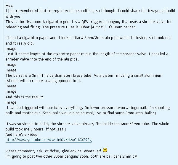

DasAbonnent, I can't see the images ,did you upload image through "upload attachment" ?
This is what i see...
@Talk, try refreshing your browser while on this page. Run file clean up, at least your browser temp files. It's been my experience running file cleanup fixes this issue. I use IE9.

No i didnt use the upload attachement. I'm using a external picture uploading service as you can see in the URL.
