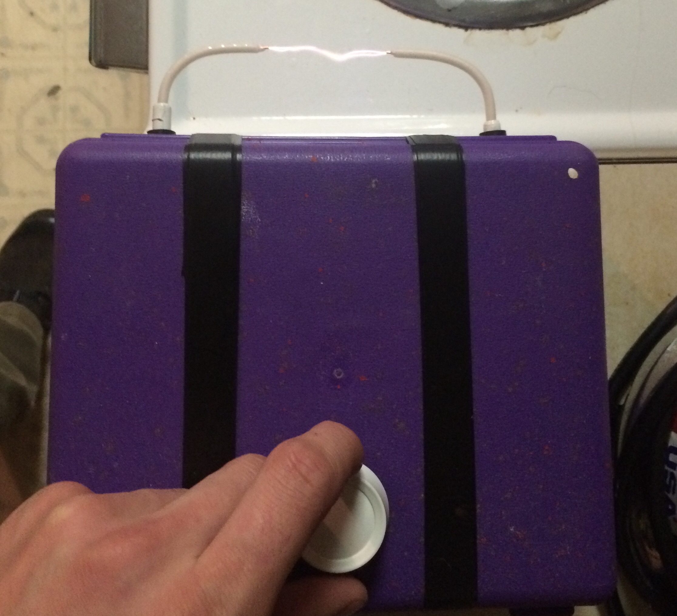

So the marx generator plan did not work out. It worked, just did not make a long enough spark, and it discharged inconsistently. I really didn't quite like the idea of waiting for 30 seconds with no exact idea when the cannon would fire. However I did get a working ignition system. Two ignition coils connected with to 120 with capacitors and a dimmer switch produce a almost continuous 3" spark. Should be plenty to overcome the 20 gaps and pre ignition pressure.
