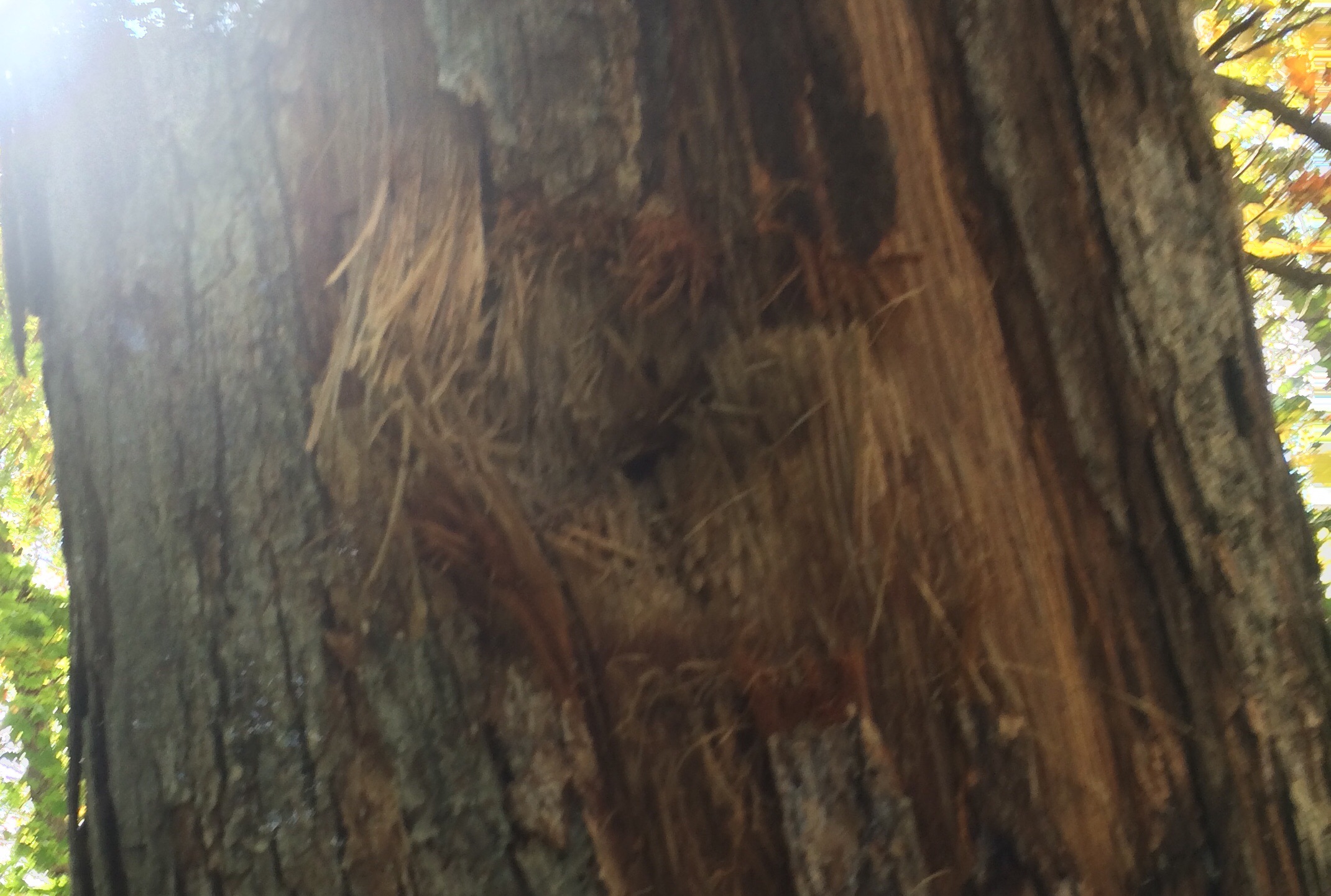

I have not had a chance for more shots, however my freind located the impact points of the first two. We have not located either projectile in part, or in whole at this point. The next shots will be with the apfsds rounds. We plan to fire one at a steel plate, and one at a large log.
Hard to see, the splintered area is where the aluminum projectile struck this tree.  It hit just to the left of the center passing all the way through.  The tree was 8-10". If it had hit an inch to the right it likely would have severed the trunk.
