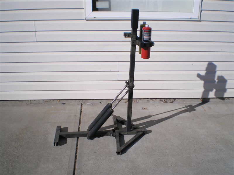

shock absorbing platform with onboard fuel

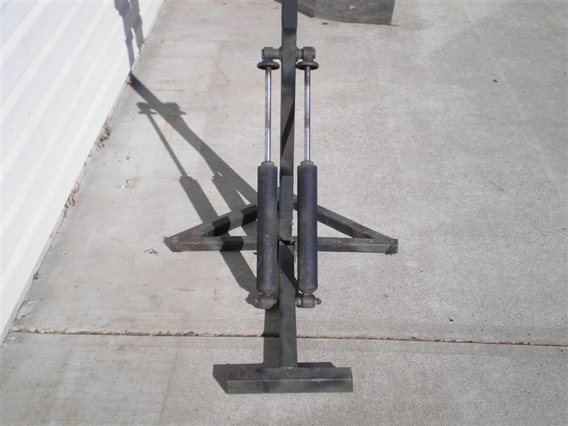

good veiw of shocks
good veiw of shocks
the platform in its extended position

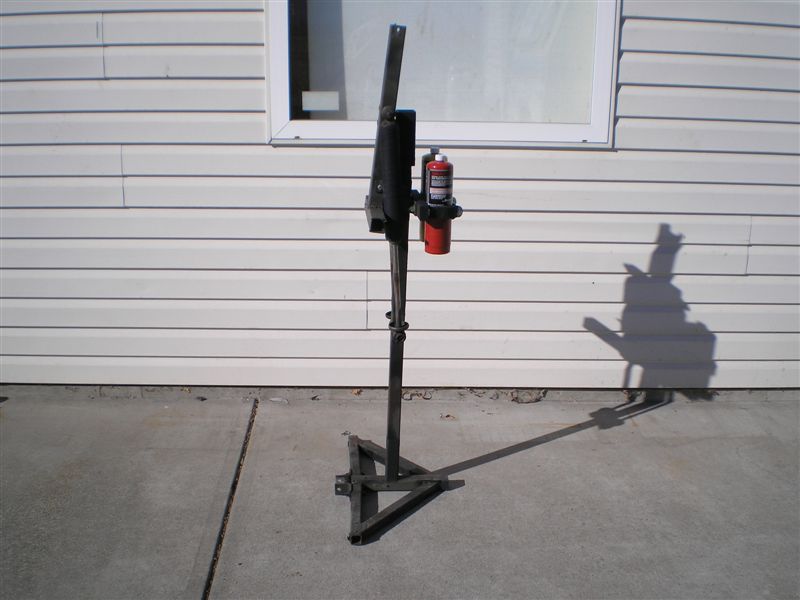

the platform in its folded-up position
