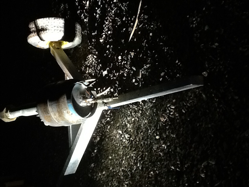

Here is my other combustion cannon, mainly for bird scaring.
I have had this shooting 25 mm steel balls at 240 m/s
Version 2 of the H2 O2 cannon

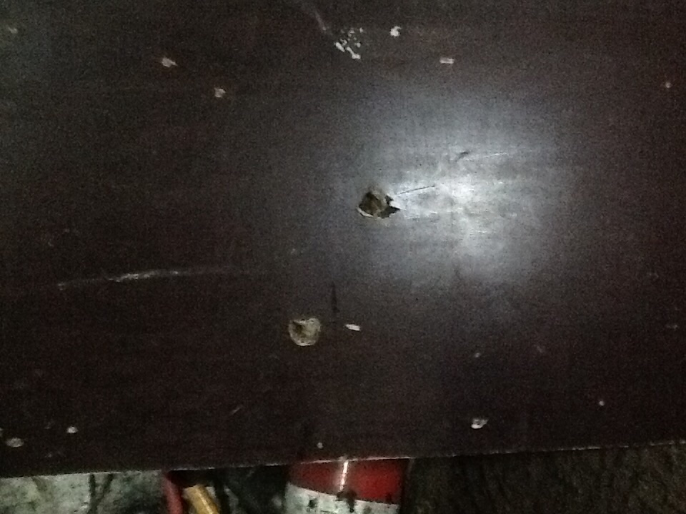

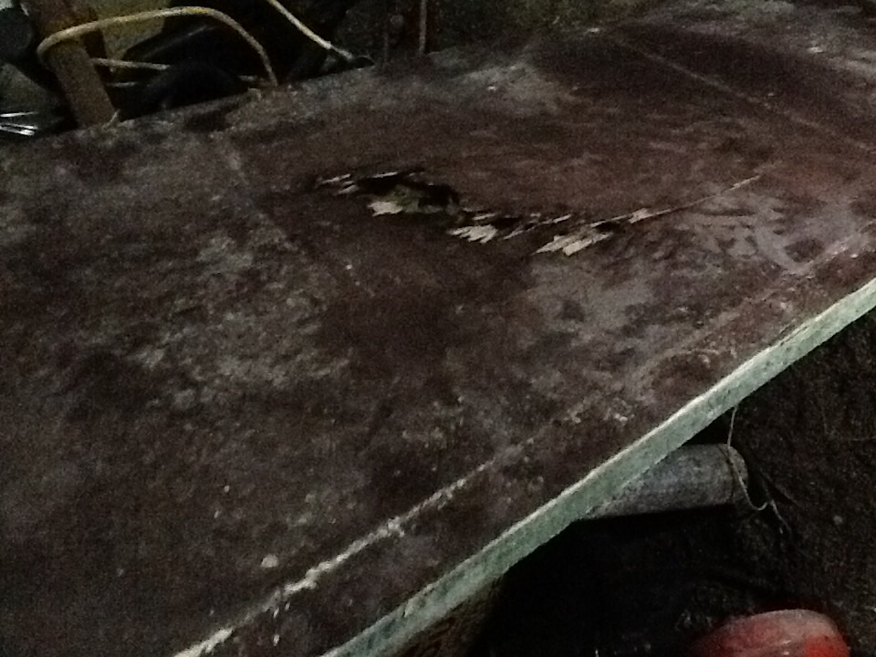

Impressive! 25mm ball bearing weighting 63gr at 240m/s is 1790J
also that muzzle flash is really cool. do you have some damage pictures? it would be nice to see some carnage, bet you could launch a frozen spud at supersonic speeds.

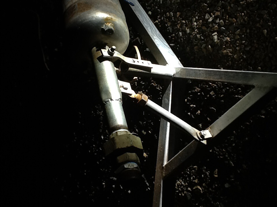

Here she is
The chamber is a lpg bottle (holds about 6 liter)
I let it off one day for an adrenaline hit, the sun had just gone down and the air was quite moist ( you know how sound travels further), anyway you could hear the shockwave traveling up the paddock for about 5-10 second. The sound was unreal !!
