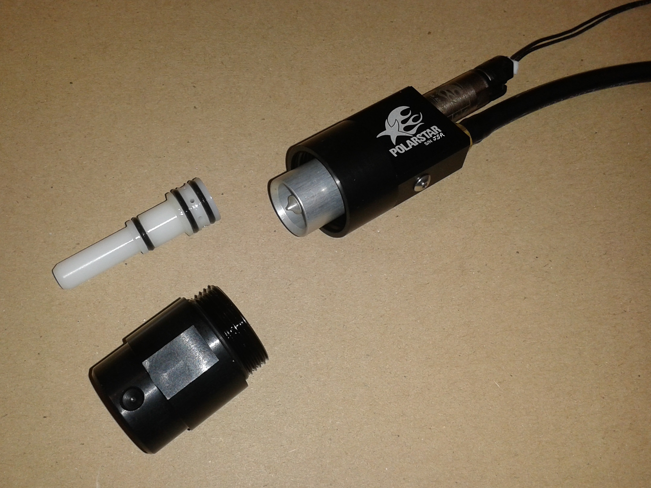

The Jack was actually acceptable, and now since yo have played with it, how does the solenoid works? My guess it's a custom 3way.
Posts: 26220
Been thanked: 352 times
It's nothing more than a compact solenoid valve driving a blow forward bolt. Since you asked nicely, took one apart and took a photo ;)
edit: just to clarify, it's a little bit more complex than that, since the solenoid has two ports that driver forward and backward motion of the bolt, which allows more adjustability in terms of power and efficiency.

Yeah I know it's like a blow forward bolt without a return spring. So the solenoid must be some kind of 2 postion solenoid. Could you please screw out the solenoid? From the only video I found where it was taken apart, it seemed very interesting, my guess is a coaxial 2 position.
Took mine apart, going to source a solenoid 3-way for it, mechanical not very consistent. It was doing 490FPS with 0.20 already though :D
Posts: 26220
wyz2285 wrote:Could you please screw out the solenoid?
Not for now, this is new stock. We'll have to wait until someone breaks one :D
