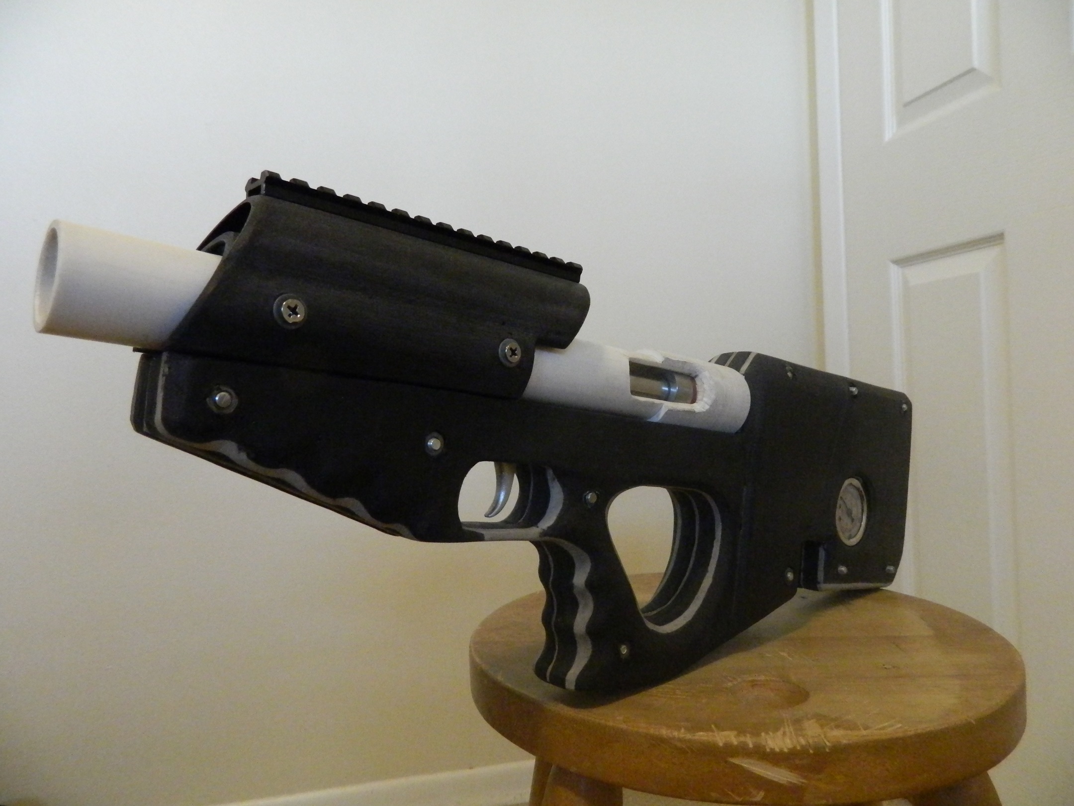

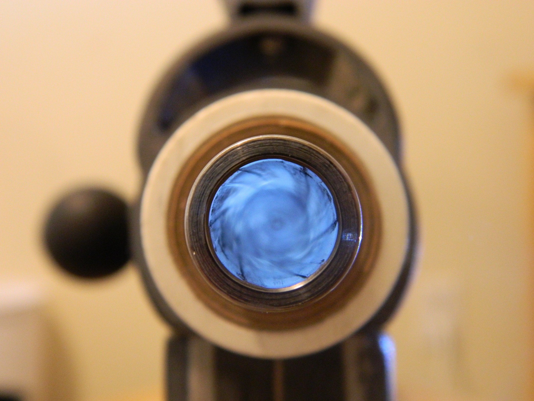

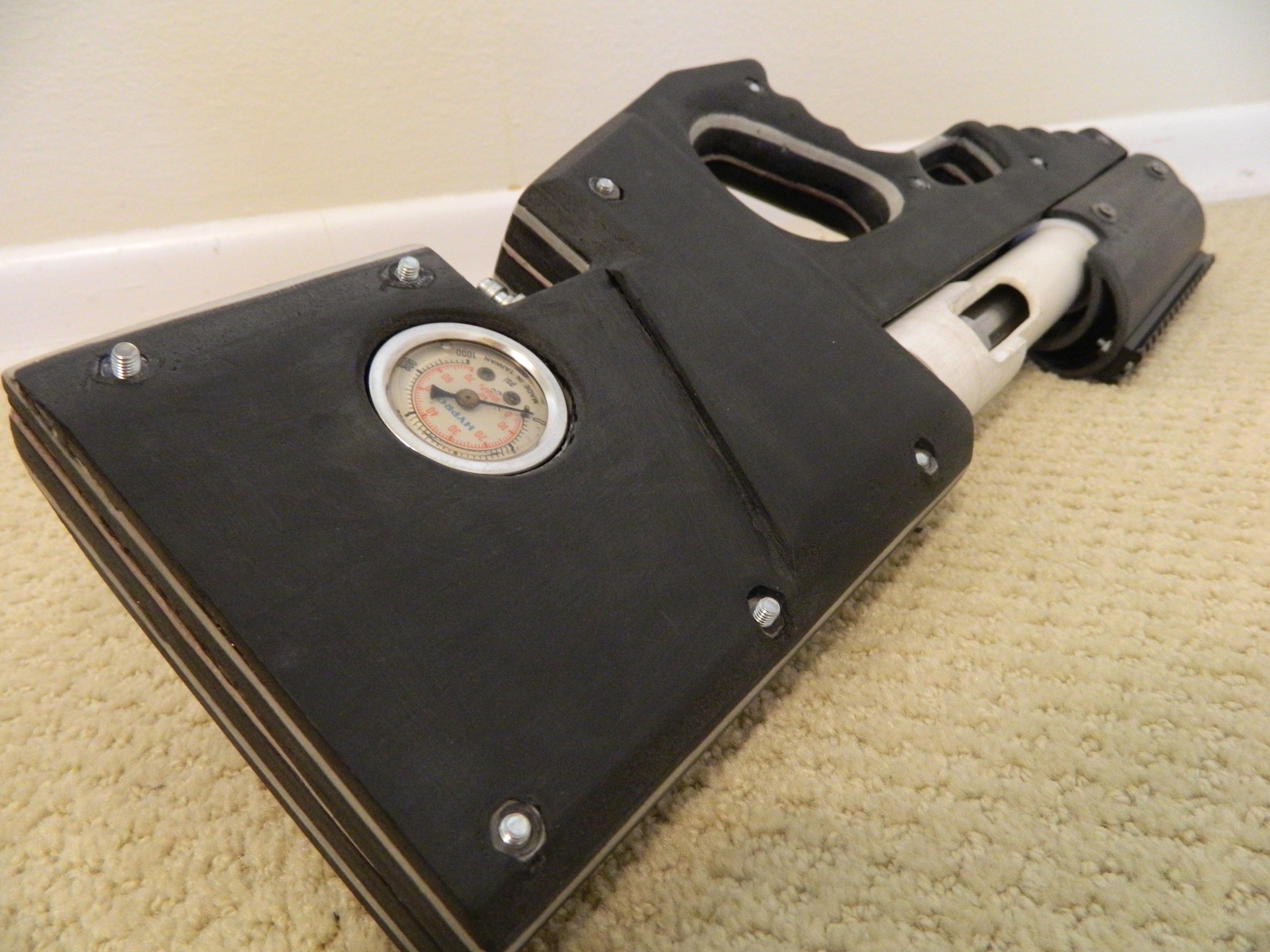

I got a chance to test out my idea of adding a smoothbore extension to the rifled barrel. It wasn't as accurate as just the 10.5" rifled barrel by itself. It did seem to do a bit more damage to the stool though. The damage is shown at the end of my shooting video:
I decided to go back to having just a rifled barrel because it isn't that much slower and it's more accurate. Plus it's a lot more compact and light.
And here are some pictures of my final setup and a picture of the rifling:

found your gun, it awesome. Its so mutch more neet looking than my first one but you probebly have a lot more expertise. Im really going to look in to the QDV what sound good. I think your idee of having a tank on your back an just a little chamber in the gun is really smart. But way did you deleted al the videos on you channel I would like to see some more info or just shotings.

Looks like the barrel moves in and out to expose the breech for loading. Is there any play in the barrel when locked in position?

There isn't any play in the barrel when locked because of the two points of contact. It is a similar sealing system to my most recent combustion cannon "The Jackal" where the wedge of the bolt slide forces the seal against both surfaces.
For the laminating process I just used the standard brush-in-can inside the ABS glue and worked quickly. I would do it layer by layer and press it down as I built it up and then stood on a big board to compact it for a while. I didn't want to make a press.
