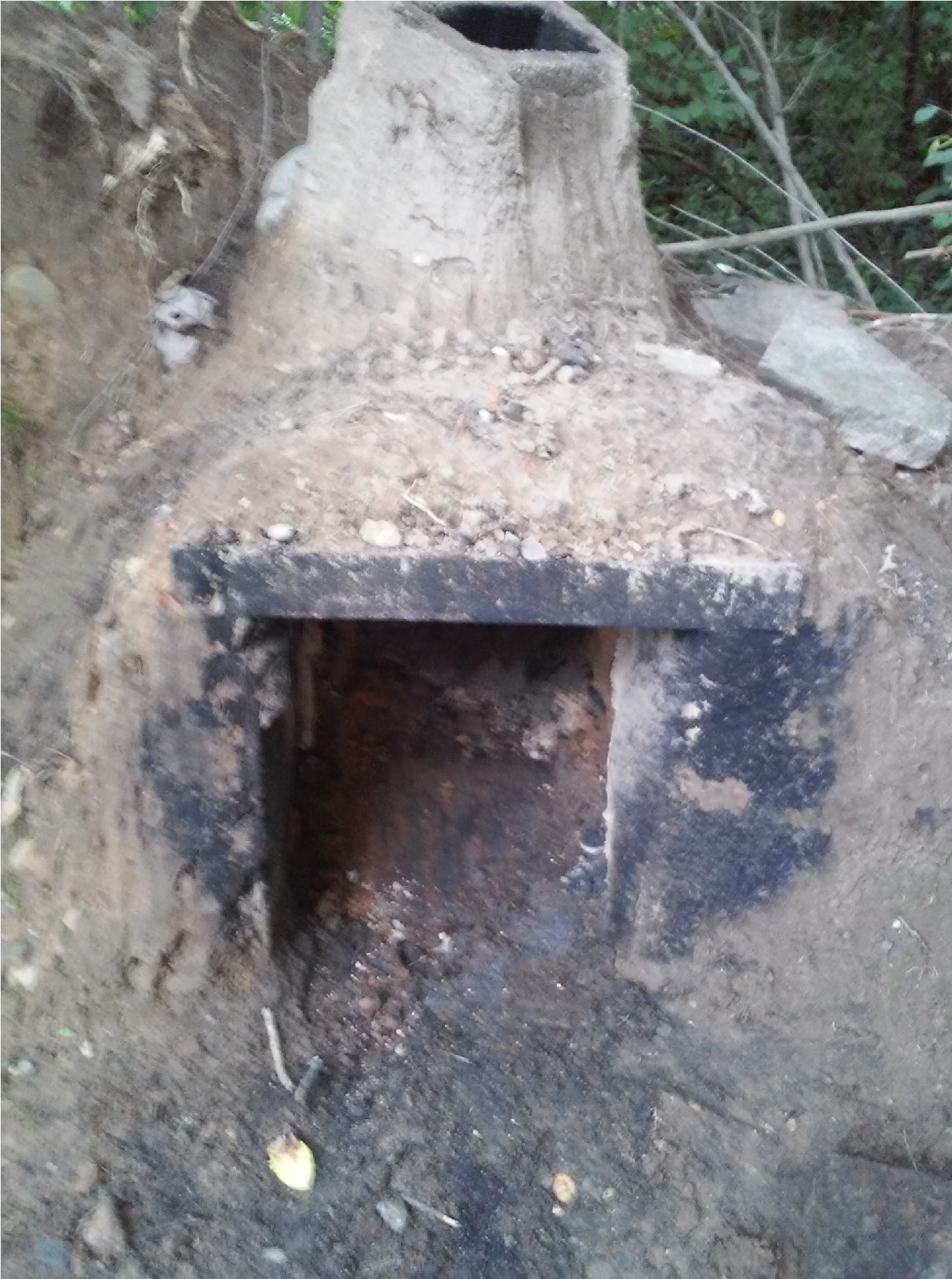

Sorry about the crappy picture quality, but the point of the foundry itself was to be as cheap as possible (the only expense was the exhaust duct, $4 and not shown). It's made from a dirt mound that was once a fallen over tree. The side walls and roof are made of concrete blocks (horrible idea, I know) and a lot of dirt.
I close the front area off (except a hole for the burner) with more concrete blocks. Hopefully the picture shows that the side walls are padded with dirt for better insulation (although the roof is not). The floor is also dug out more so as to create a threshold at the opening; I'm using soup cans and other refuse for crucibles and if one burns through I want it to be contained in the foundry. The dirt inside slopes upward towards a whole in the back that leads off into an exhaust port (below)
The duct is missing but I use a 4''x5' section of duct pipe as an exhaust (the port slopes forward because there are bushes and trees behind the stump that I don't want to accidentally catch on fire).
I realize it's kind of horrible and unsafe but it heats up very quickly and was insanely cheap (my smaller foundry had like a third of the capacity and was 15x more expensive). Plus, I don't have a screen to filter out the rocks from the dirt, so now I flinch whenever I hear a faint pop :mrgreen:

Industries and countries have been built upon such simple devices...nothing wrong with simple IMO. Won't be as durable as refractory (obviously) but the replacement cost is well within reason. :wink:
You've a surplus of heat with that burner if only doing aluminum alloys...could just pile some bricks together. Adding the dirt insulates it all that much better.
