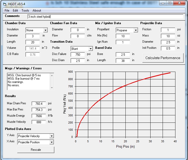

Quick simulation at 10X Propane:
As you can see, without the need for a chamber fan (pressurizing the system agitates the mixture in and of itself) you're already at ridiculous power levels, well beyond .338 Lapua Magnum.
How are you thinking of holding it exactly? Did you plan on fitting a stock or simply holding it Bogan style?

Wow, those readings are nice! I was disappointed about the data until I realized that that was from the 2.5" barrel and using Propane, not MAPP!!! This upgrade to Galvanized steel certainly opens opportunities... better stop bragging to mom, she is starting to get antsy and threatening to stop the project haha.
What would the 1.5" barrel yield with MAPP and a chamber fan?
