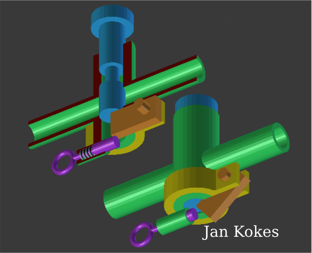

That would be super cool, albeit steel seems more practical. I designed extra fast valve for starter:
Top of the vertical pipe and one side of the horizontal pipe are connected to the (same) pressure tank. The vertical pipe never allows the pressurized medium to pass through, however it does allow for the piston (blue) to move freely. The piston of closed ventil (cutaway view) is held in place by wedge (brown) which is held in place by trigger (purple). Once the trigger is pulled (full view) the piston shoots down powered by pressurized medium above. That opens horizontal pipe to allow for the pressurized medium to pass through.
Consider a lever instead of a pull pin to release the mechanism, as the friction from the force of the "pressurized medium" will make it difficult to open.
jankokes
Posts: 6
Joined: Thu May 18, 2017 8:45 am
jackssmirkingrevenge wrote:Consider a lever instead of a pull pin to release the mechanism, as the friction from the force of the "pressurized medium" will make it difficult to open.
OK, little clarification. By "connected to the (same) pressure tank" I meant the inlets can be, but don't have to be, connected to the same tank. In Archimedes-me cannon there are two areas with high pressure. One is the purple area of steam at the top of the first picture. There isn't that much of a pressure there before the cannon is shot, and it is this pressure that the pin holds. Second pressure area is inside the cannon. There will be much greater pressure there and also in the steam area once the pin is pulled:
CxHy(l) + H2O(l) + heat -> H2(g) + CO(g)
Two liquids turn into two gasses almost instantly, resulting in rapid increase in pressure. However this pressure won't interfere with the pin because the pin won't be engaged any more. The design can incorporate lever trigger of course, there is nothing easier, and I thank you for the suggestion:
I originally thought that I would pull a string attached to the eye of the pin, but tying string to a lever will be just as easy. I want to stay clear when the cannon goes boom.
