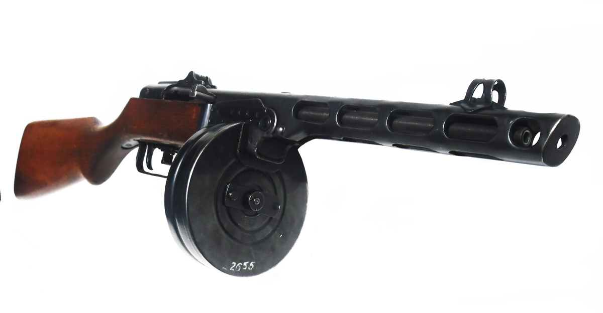

I think it's a better idea to incorporate a system that spreads the recoil, ie allowing the barrel some dampened movement on a fixed mount, something like this:

Otherwise it will keep the benefits of Spagin, preventing both recoil and muzzle jumping up. The pinhole may or may not be required however it will make it less likely you will shoot the whole appendix off.

Hah! I remember that thing, high impulse weapon something, from France if i remember correctly. You forgot the second part where the other guy got his ass kicked by that thing! :D Not exactly low recoil tho :p I had been thinking of building a stock from an old pneumatic cylinder to absorb some of the kick. All made the thing a lot more bulky and heavy tho, which i guess also helps with recoil, but i'm not Joerg Sprave :mrgreen:

I don't get the PPSH reference tho? It's a big heavy gun firing a small pistol round, that's why it has so little recoil, i have a semi auto conversion on license and it still kicks tho :p Or are you referring to the barrel shroud acting as a crude muzzle brake?
