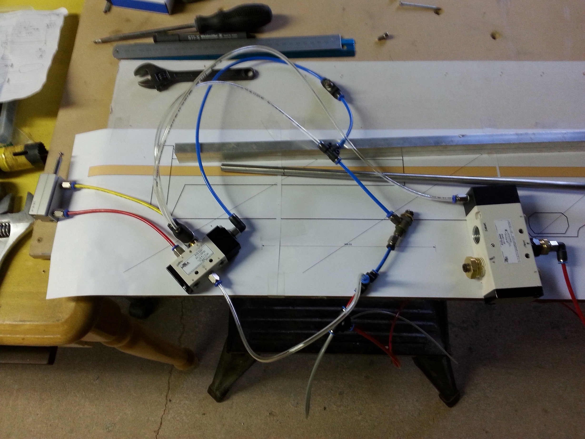

Had to come up with a new pneumatic circuit as it uses a double acting cylinder rather than a spring return like BFG. This seems to work, adding a EOS (end of stroke) sensor to the control valve seems to give me what I want.

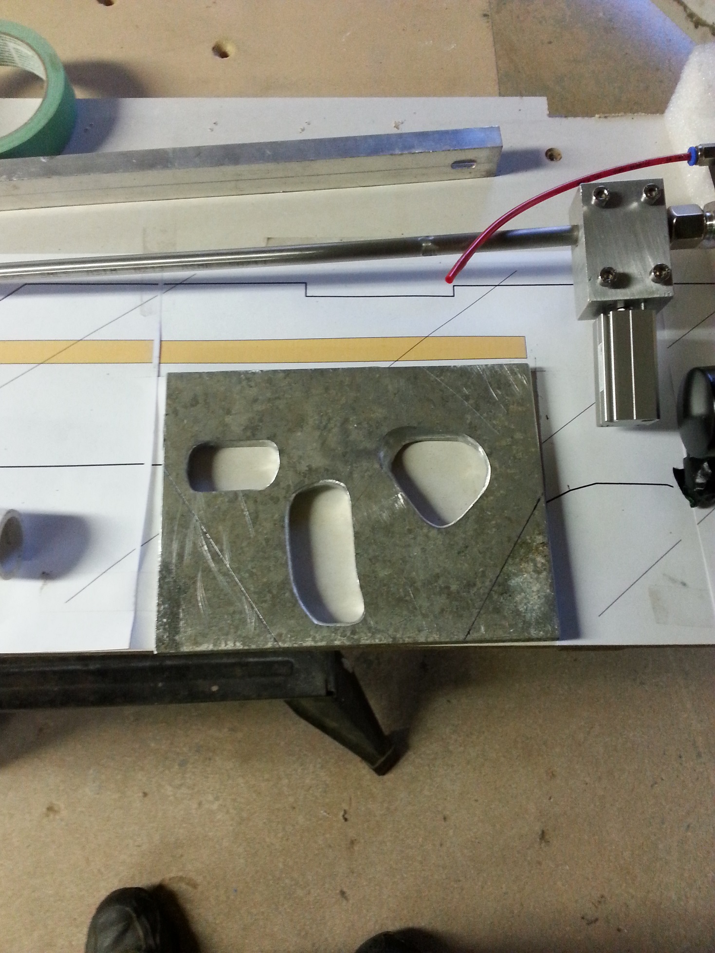

A bit of drilling, this is going to be a lot of work :o
Your dedication to this painstaking form of construction is very admirable.
No jig saw available? Hacksaw blade? Working with what you got??? Sometimes I still have to wrap a blade with a rag and saw like crazy to get a job done...

jackssmirkingrevenge wrote:Your dedication to this painstaking form of construction is very admirable.
Drilling holes and filing is my therapy.
10mm thick alluminum and tight corners not so jigsaw friendly, took me an hour to get that far :| Did a bit more today, made trigger and started to mount trigger valve.
Sort of got most of it worked out in my head, but anything can change, and usually does :idea: :idea:

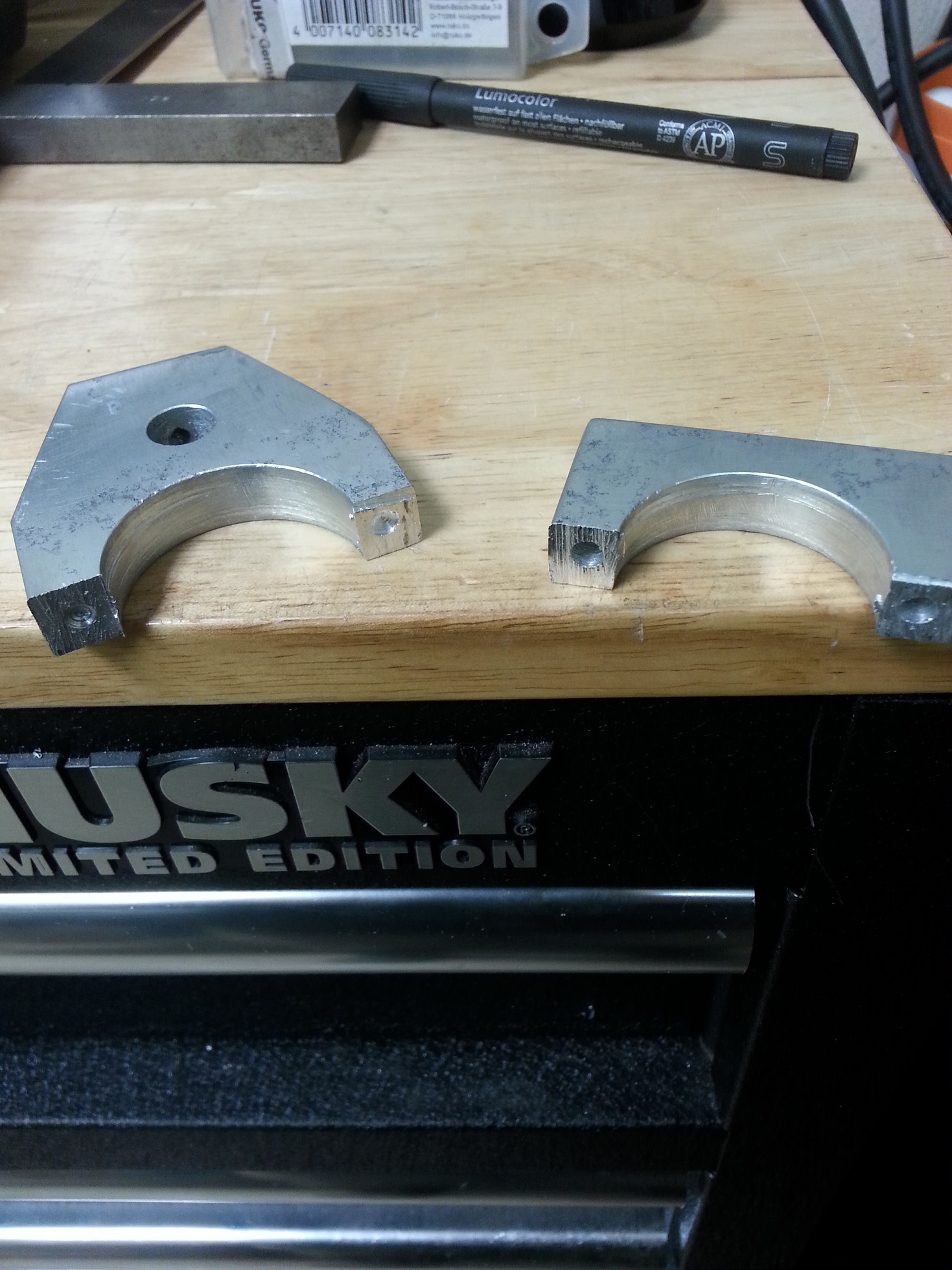

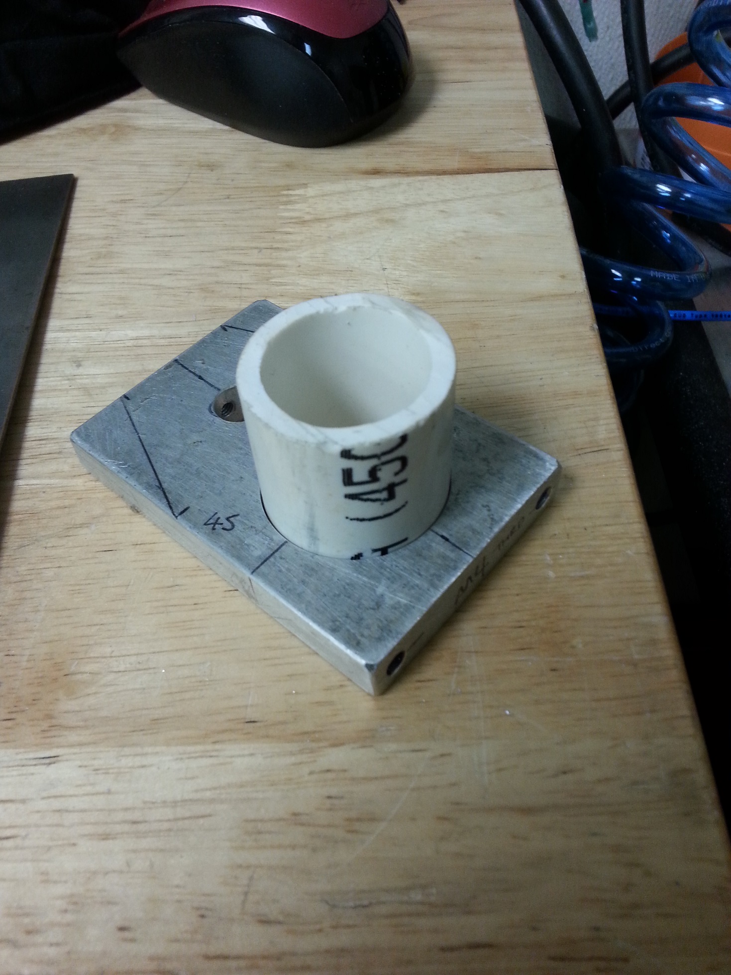

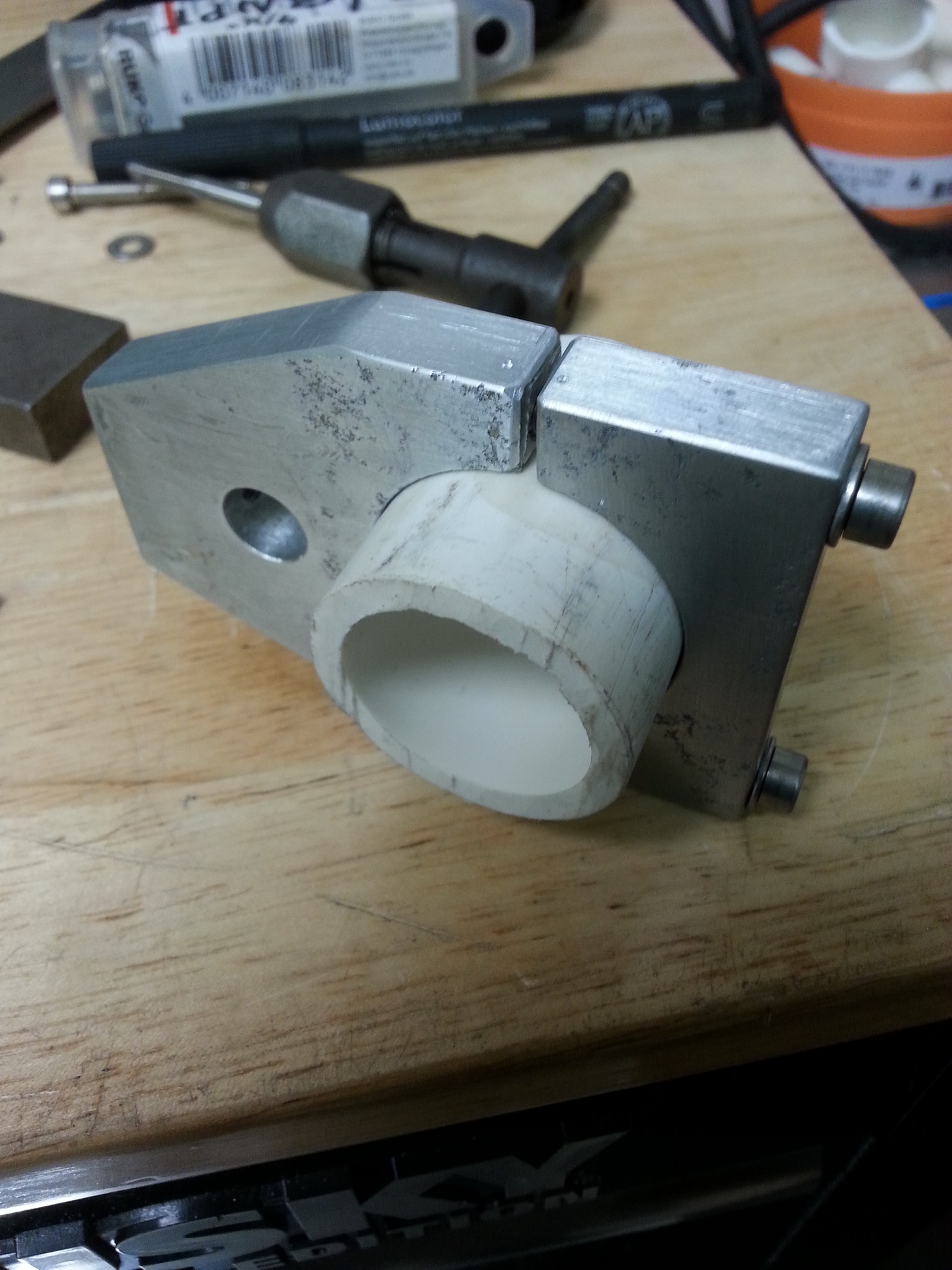

How I make a split clamp for 1" PVC, about 33.5mm. Barrel goes through the 10mm hole and rail attaches to the top.
Drilled 2x 4.5mm (anything smaller tends to wander) down just beyond eventual cut line (split in clamp)
Drilled down 3.3mm into 10mm barrel hole, then drilled down 4.2mm halfway so I tap M4 in the bottom of the hole then M5 in the top half
Drilled 33mm hole with hole saw then polished out until PVC fit
Cut in half, then used previous 4.5mm holes as starting point for 3.3mm holes, tapped M4. Cut off the top corners and polished a bit (this is old scrap material)
Finished

Something like this
