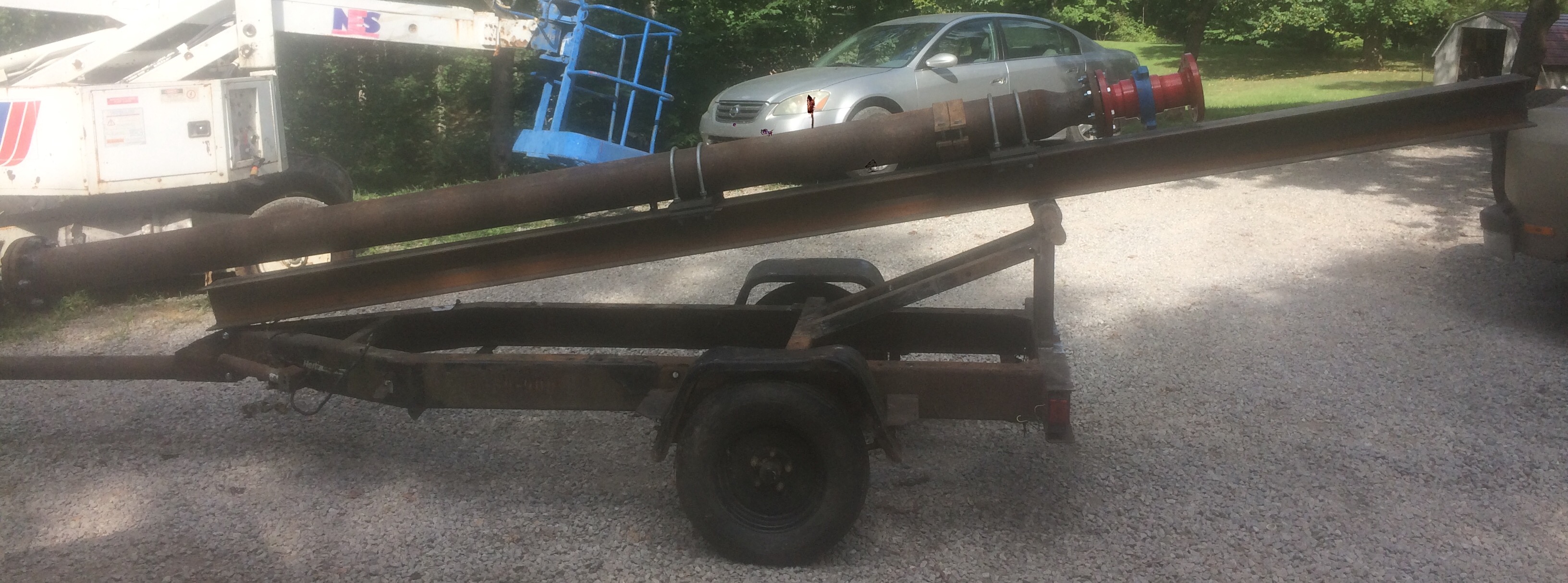

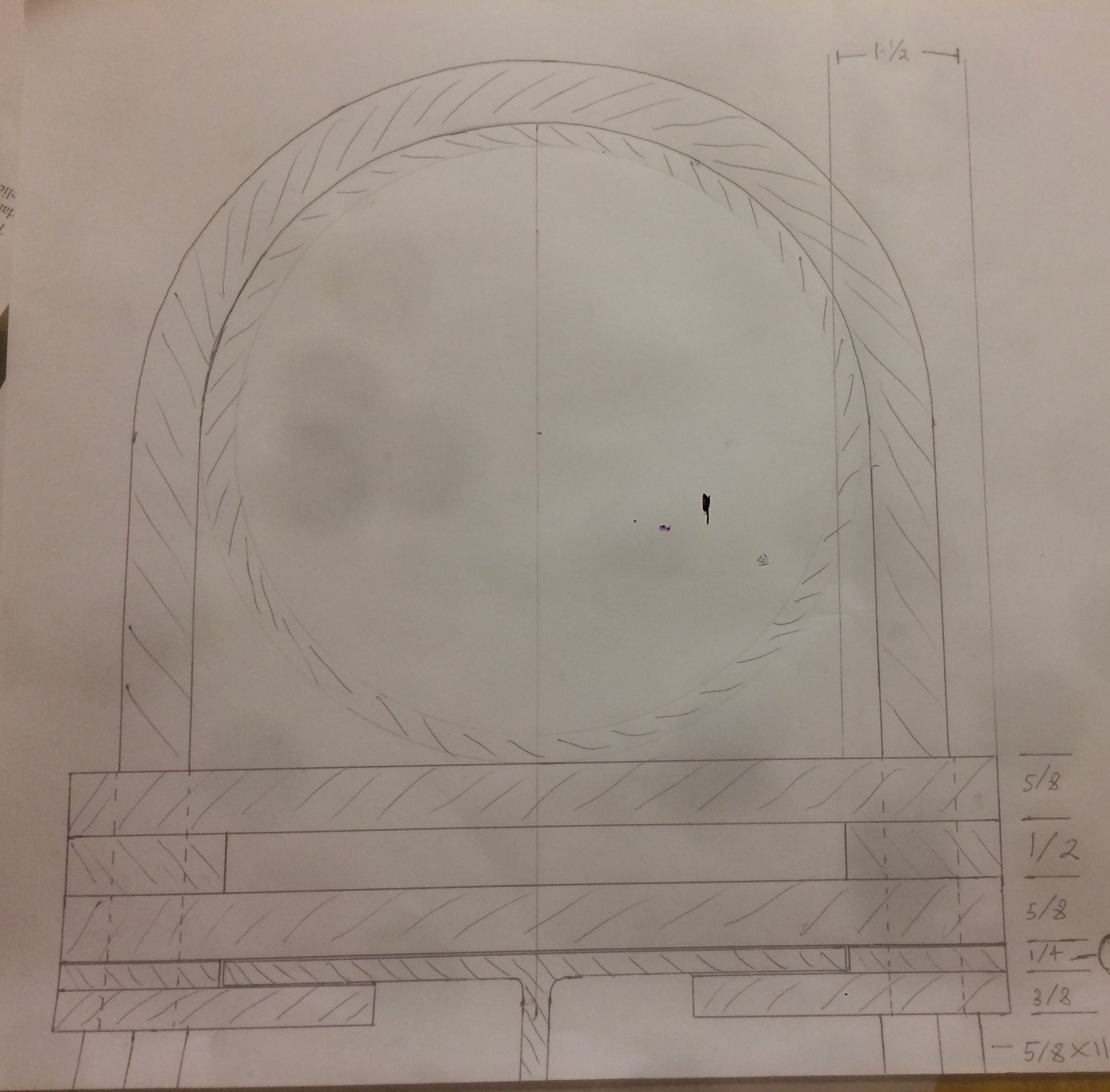

hello all, update here, this project has been on hiatus, moved at the beginning of the year. I was able to do some work durring a visit home with the help of some freinds. The remaining work should be completed before November by my freinds with test firings of the new arrangement in early novemember. Here is the current progress.
Chamber and shocks for recoil test fit
Trailer with pivot mount for elevation
Beam for slide and chamber on trailer

Slide mount drawing for chamber

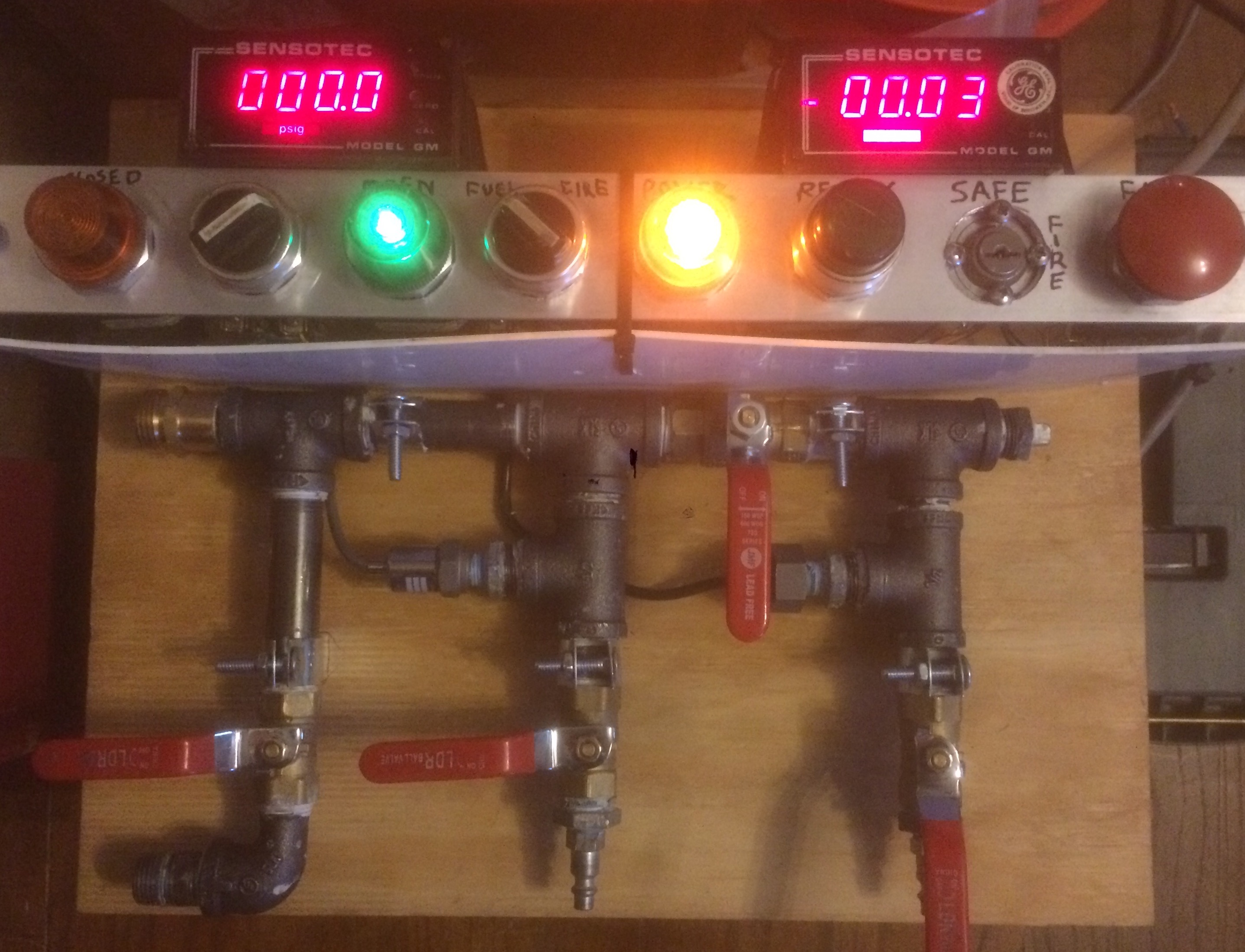

Luckily I had planned for venting the chamber withought a known combustion for both this exact reason or if a leak occurred durring fueling. I have a electric ball valve now installed on the cannon and then a vent off my fueling manifold. So I can vent the chamber entirely remotely. I will have my freind check on the condition of the disk as soon as I can and get the videos up as soon as I have them.
This is the most recent fueling set up. Controls for the actuated valve on the left and firing on the right. Air and propane are the two quick connects, the brass fitting is the hose to the cannon(just a standard garden hose). Lower left is the vent.
