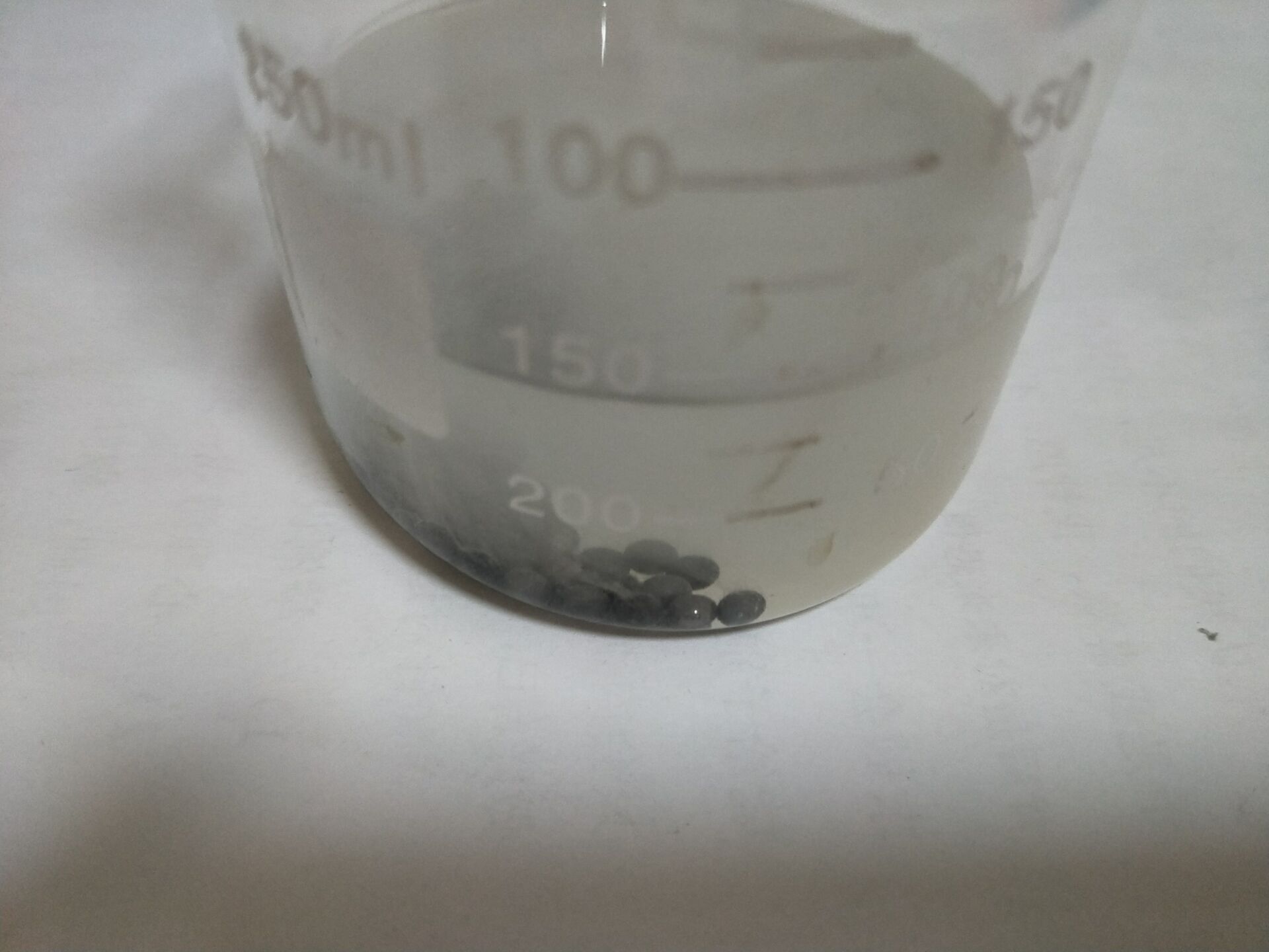

The shell I used was steel ball.The ball you found may not fit well to the barrel,but you can try with this way:put it in a baker,or something you could found like a plastic bottle,then add with acid,like hydrochloric acid,sulfuric acid,and wait for sometime,maybe 20minutes or more,until it fits the barrel well.Remember to wear protections while dealing with acids!

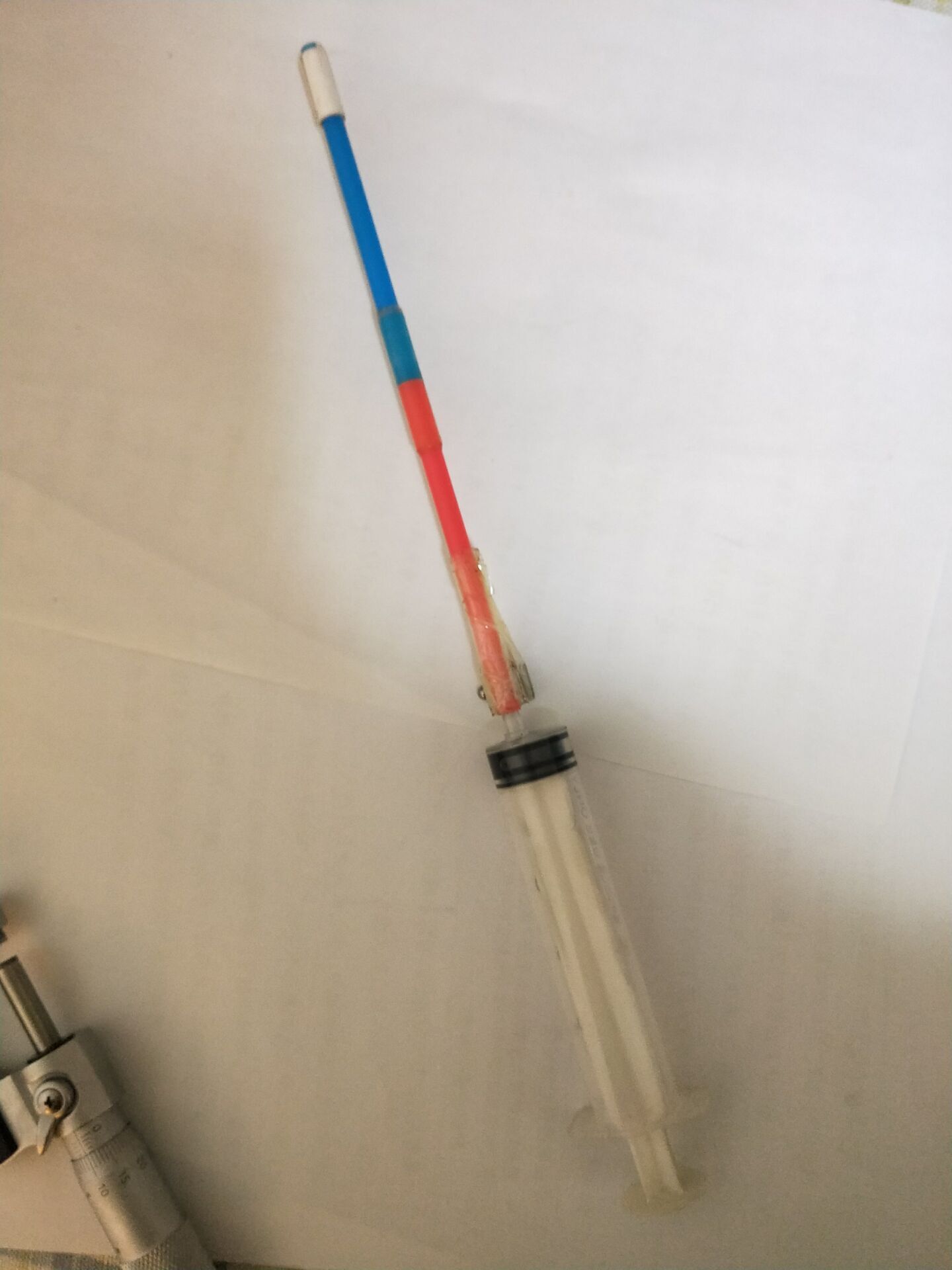

The barrel length is another important factor.As far as I tried,the 5ml fits for 10cm[4in],and the 10 or 20 ml fits best with 20cm[8in]barrel.I've got the barrel built up by used gel ink refill.The length in the picture was unnecessary,it was for a control test.

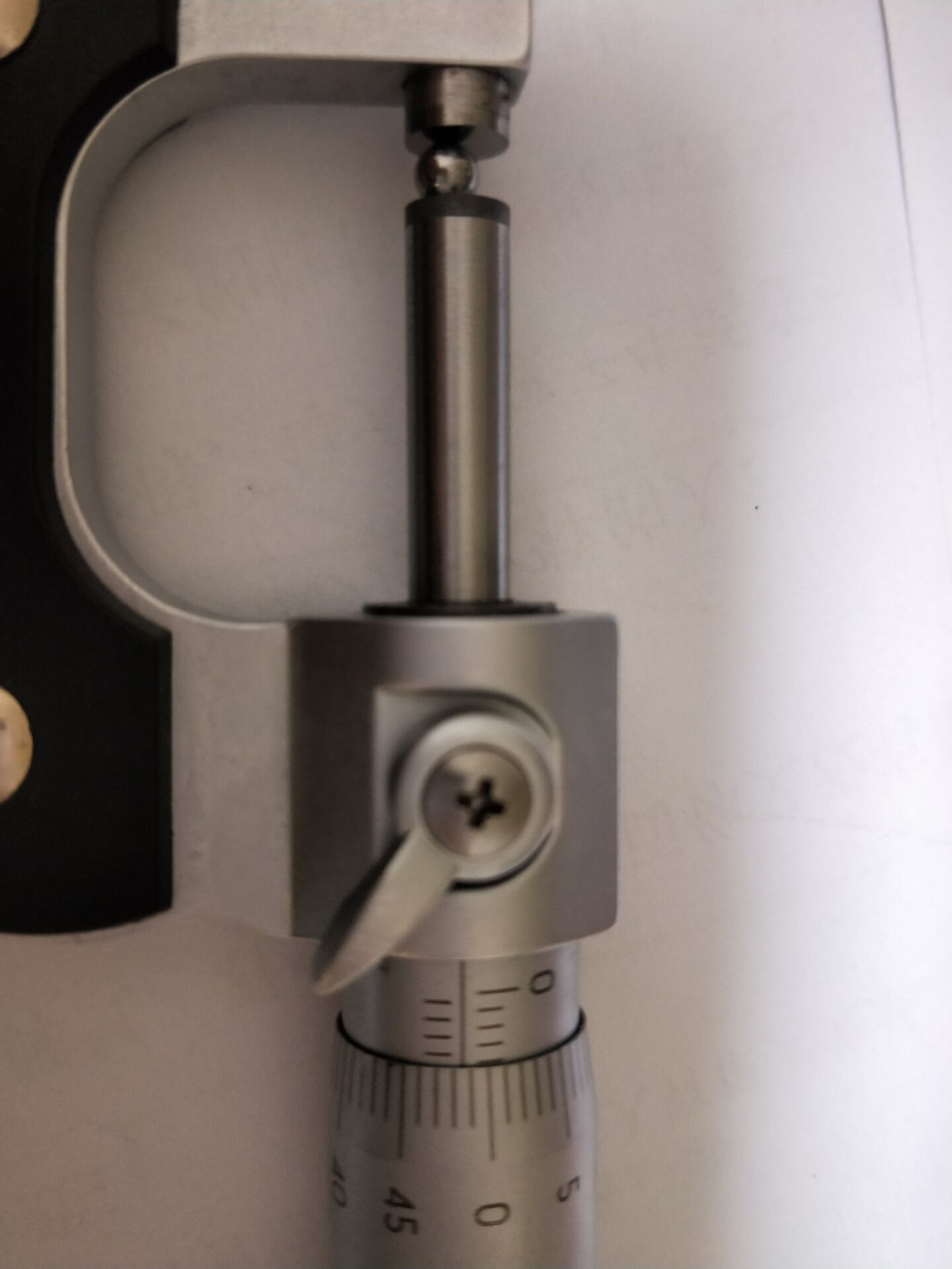

size after chemical milling,about 0.1mm smaller
balls in the acid
balls in the acid

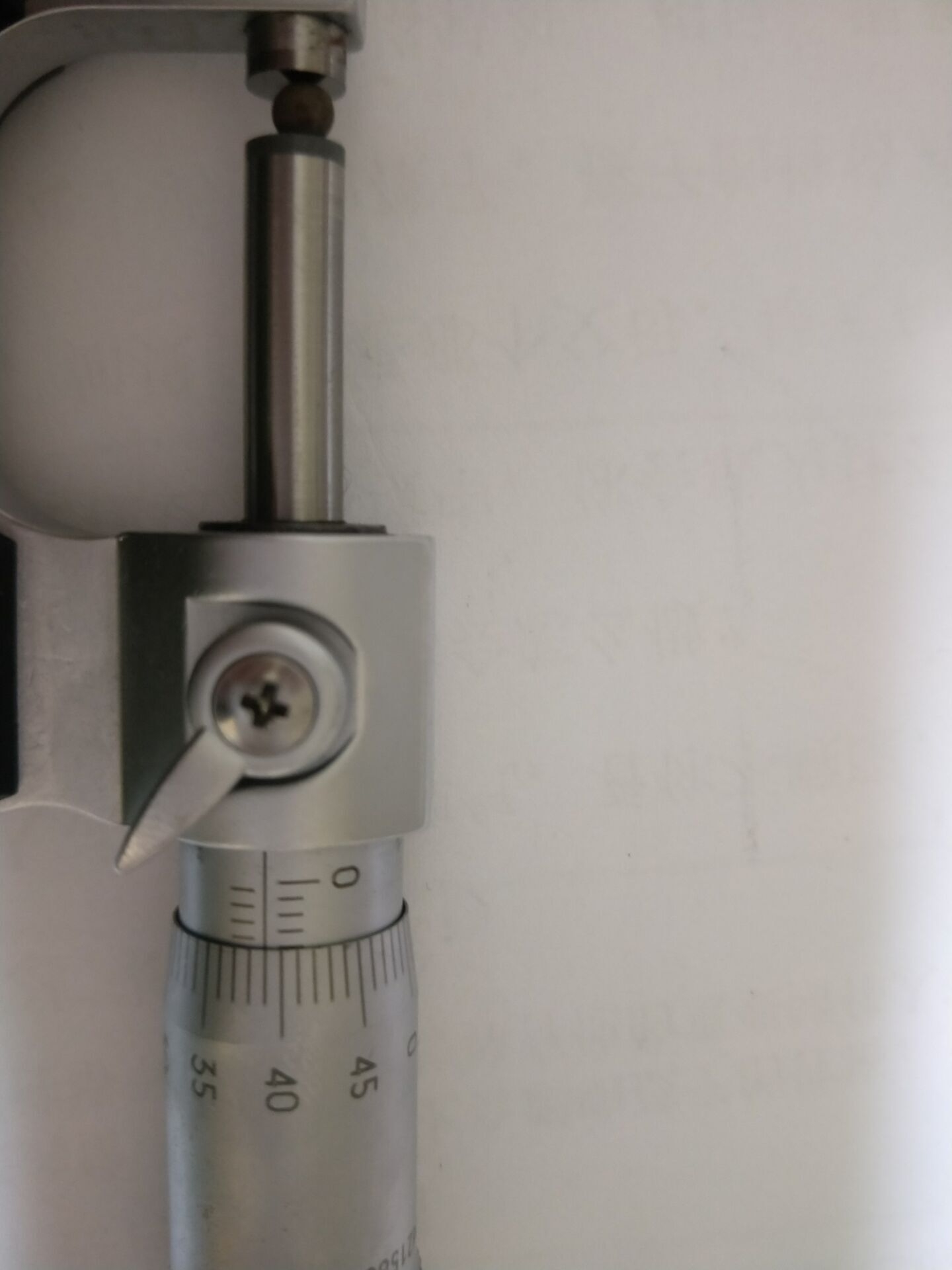

orginal size,a bit larger for my barrel
complete version
complete version

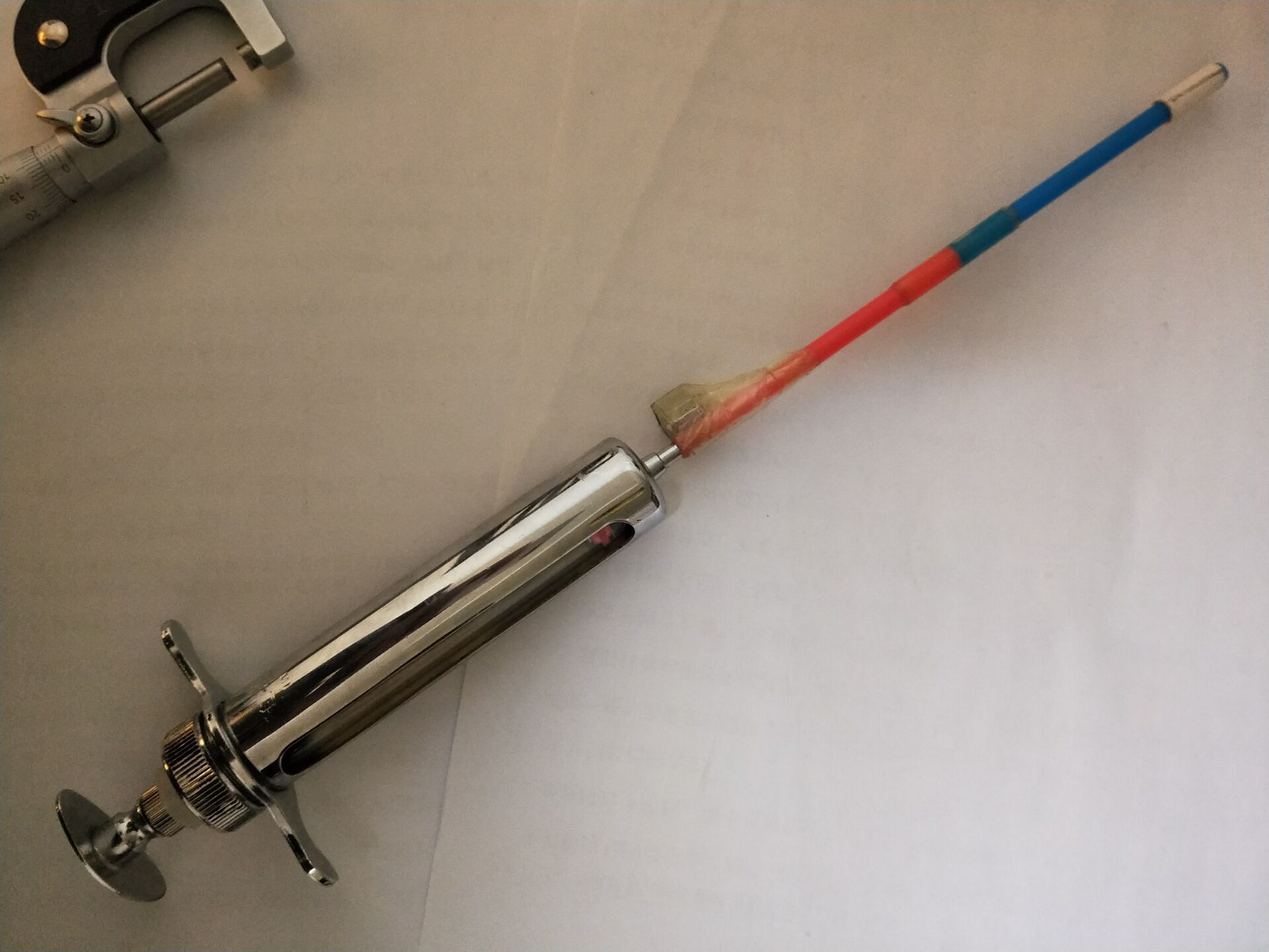

the metay syring is another choice,for it fits your hand better and make it easier to use
