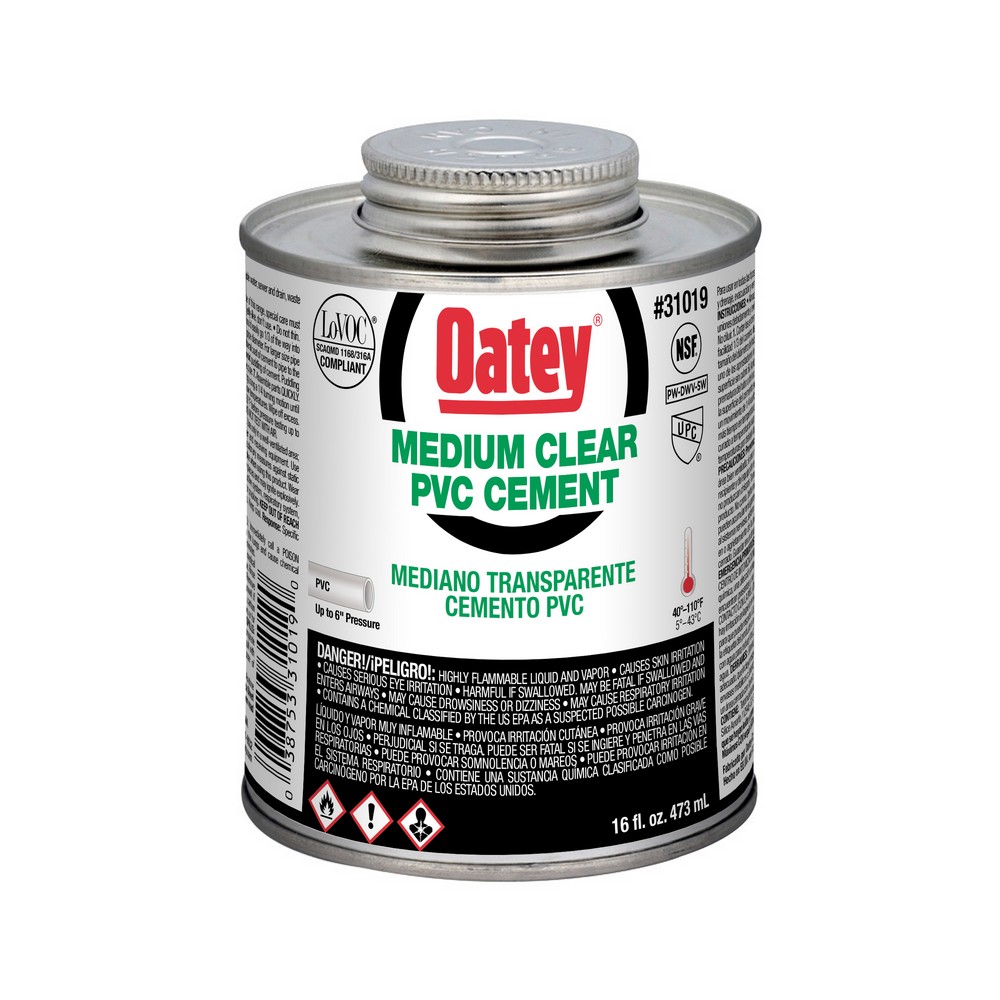

I leave mine at least 24hrs as well just to be sure, that might be overkill but I haven't had any leaks so far at 140PSI.
I have used this

You need stuff like this
