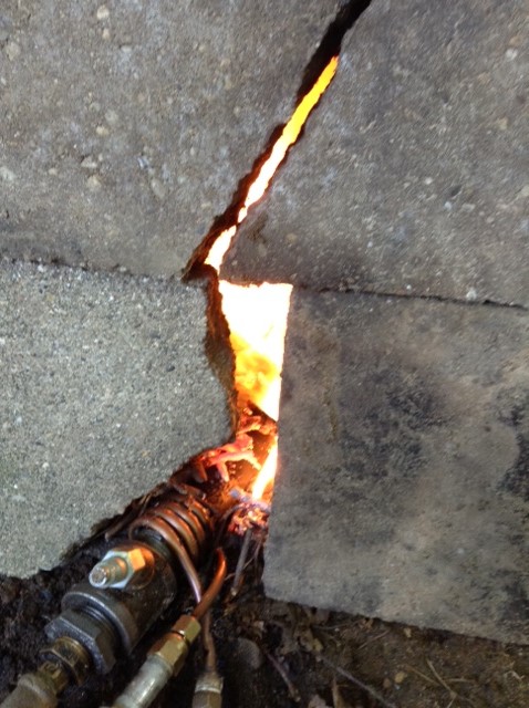

Just finished my waste (motor) oil burner
It's basically just a nozzle with an oil line and an air line attached, the oil tank is pressurized to force the oil to the nozzle.
It seems to runs best when the tank pressure is set to 20 psi (regardless of how open the air line is). The pictures below show it running on something like 20 weight but I've got a lot of 50w oil with some sort of additive that makes it even thicker (I got the oil from some amateur racers). The 50w seems to be too thick so I mix it half and half with the 20 (I'm not really sure that the oil is actually mixing or if it separates once it sits for long enough), on top of that I have to run my air line at full bore. With all of the extra oxygen, the sludgy mixture seems to burn without any smoke and the flame actually has some purple flares at the base.
The polyethylene tubing is the air line, the vinyl is for the oil input, and the male quick connect was supposed to be for a propane inlet to warm up/start the burner on but I've kind of ditched it, now I just start a small wood fire under the burner to get it going. The copper winding around the base are for preheating the oil (not sure how well it actually works though). The holes were meant to provide more oxygen to the propane nozzle through a slight abusing of the venturi effect but they work pretty well at supplying extra air to the oil stream too.

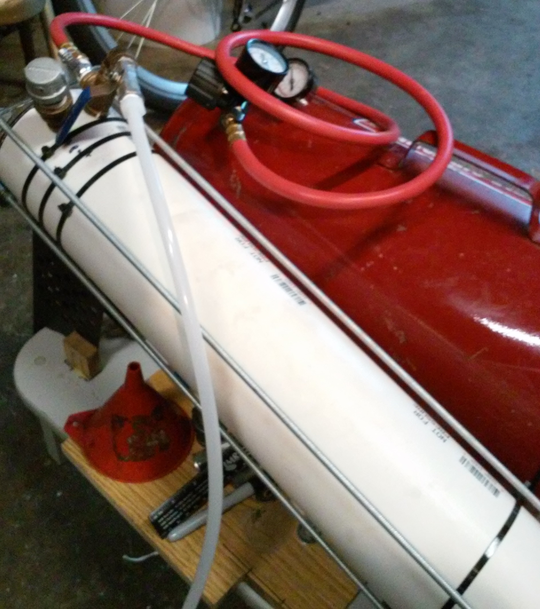

The picture's old but there's the air tank (red) and oil reservoir (PVC).
And, of course, testing the burner

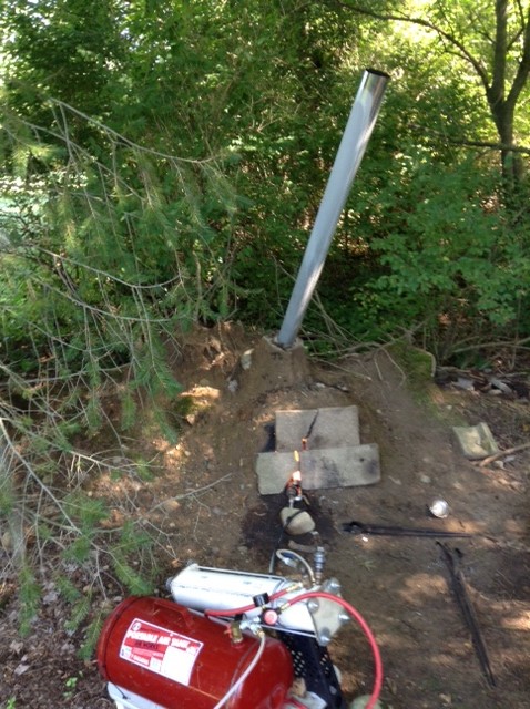

Sorry about the crappy picture quality, but the point of the foundry itself was to be as cheap as possible (the only expense was the exhaust duct, $4 and not shown). It's made from a dirt mound that was once a fallen over tree. The side walls and roof are made of concrete blocks (horrible idea, I know) and a lot of dirt.
I close the front area off (except a hole for the burner) with more concrete blocks. Hopefully the picture shows that the side walls are padded with dirt for better insulation (although the roof is not). The floor is also dug out more so as to create a threshold at the opening; I'm using soup cans and other refuse for crucibles and if one burns through I want it to be contained in the foundry. The dirt inside slopes upward towards a whole in the back that leads off into an exhaust port (below)
The duct is missing but I use a 4''x5' section of duct pipe as an exhaust (the port slopes forward because there are bushes and trees behind the stump that I don't want to accidentally catch on fire).
I realize it's kind of horrible and unsafe but it heats up very quickly and was insanely cheap (my smaller foundry had like a third of the capacity and was 15x more expensive). Plus, I don't have a screen to filter out the rocks from the dirt, so now I flinch whenever I hear a faint pop
Pictures of it in action to come on Monday

Industries and countries have been built upon such simple devices...nothing wrong with simple IMO. Won't be as durable as refractory (obviously) but the replacement cost is well within reason.
You've a surplus of heat with that burner if only doing aluminum alloys...could just pile some bricks together. Adding the dirt insulates it all that much better.
