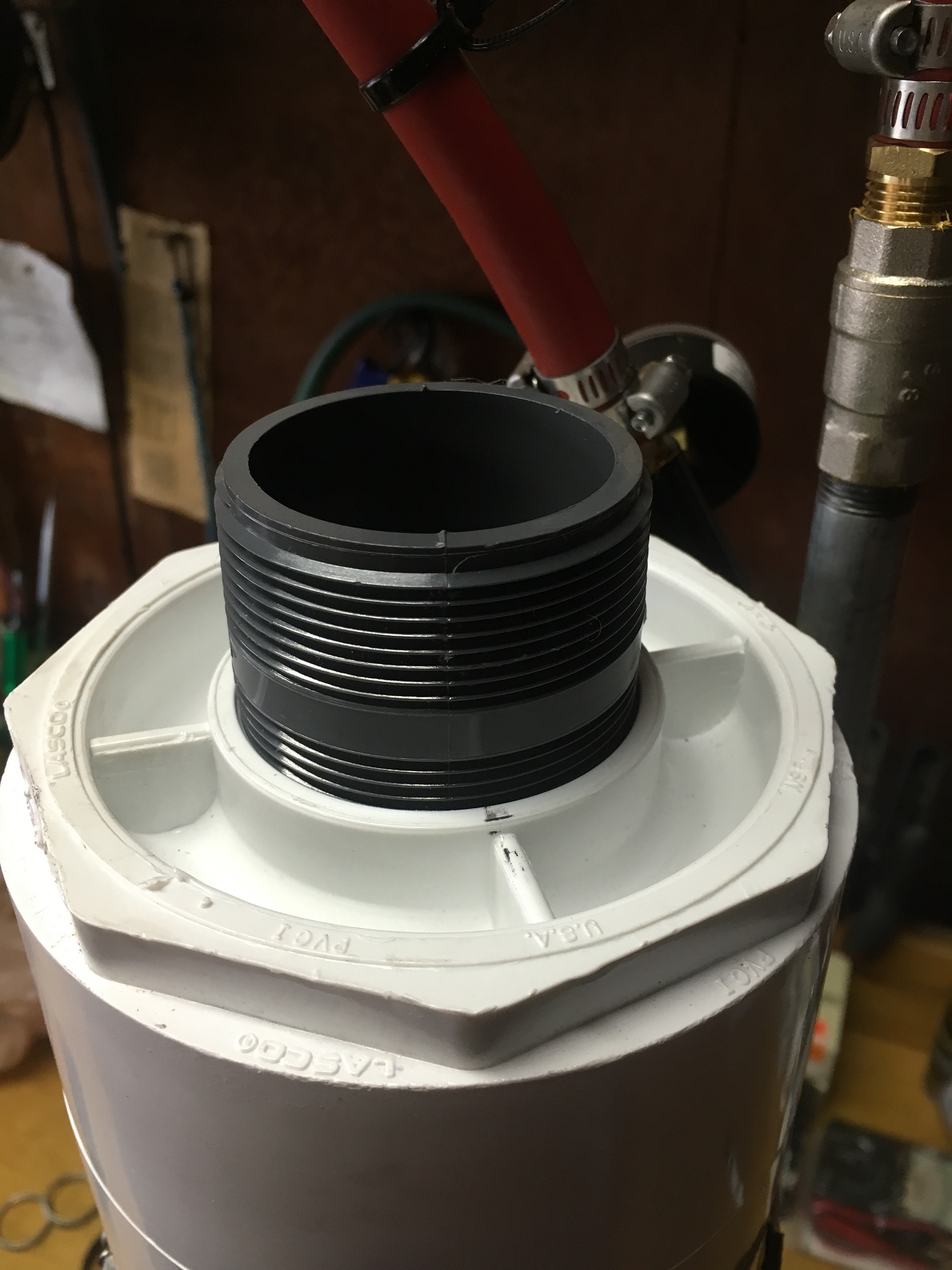

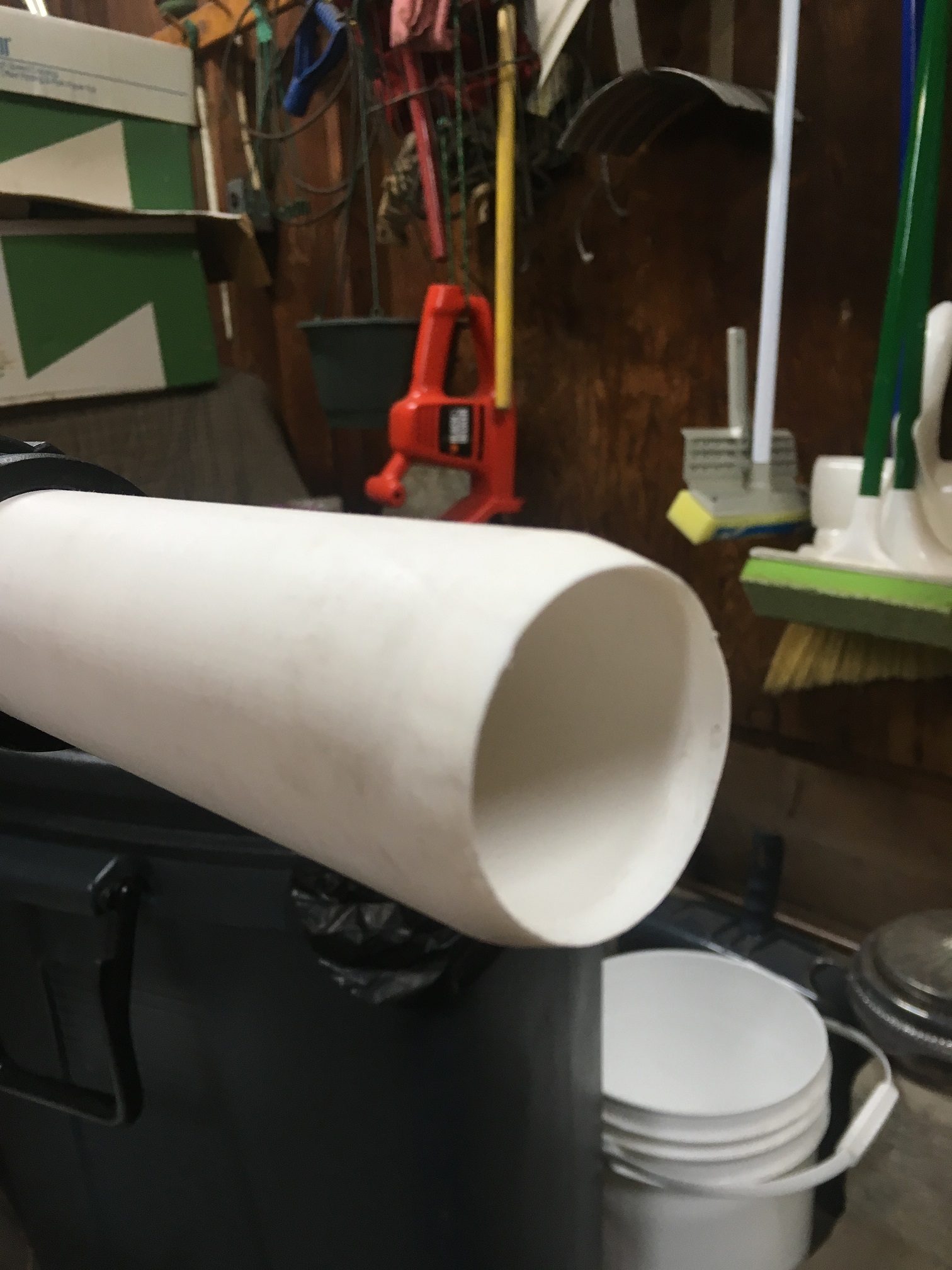

Got to do a little more work on the cannon today. Pictures show the fittings and double beveled pass through barrel. The PVC fittings only took 15 minutes to sand out but the black camlock took over an hour and a half. I also switched the camlock on the chamber to come through a SCH80 close nipple which allows the barrel to pass through good and snug. Working on a latke style trigger as well.

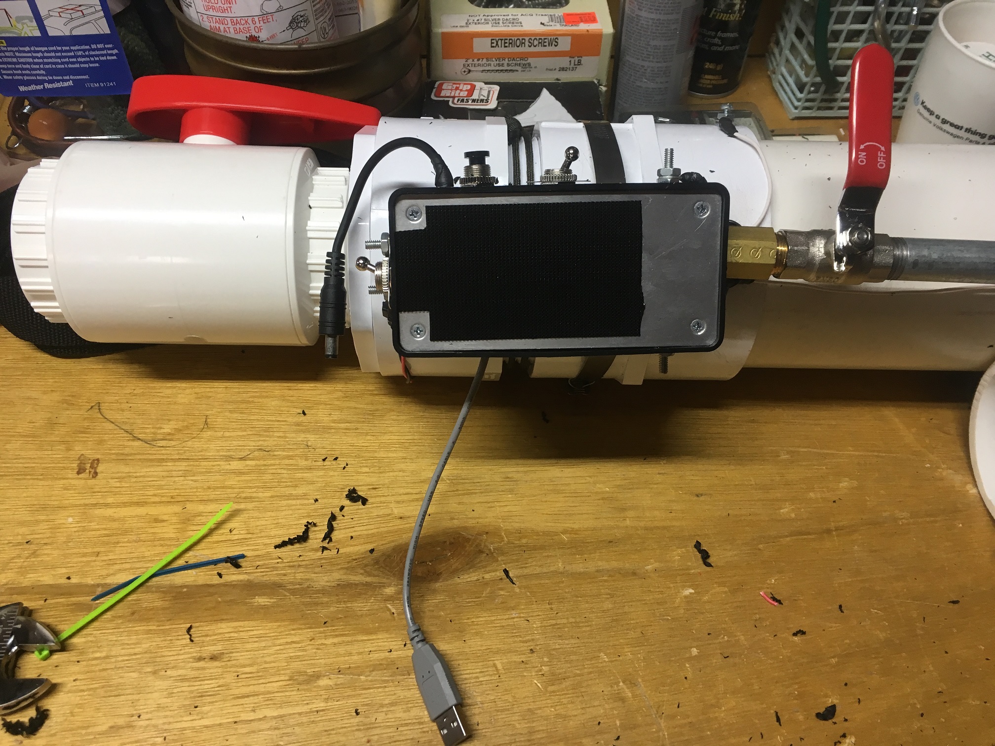

I have attached a few pictures of the updated electronics with the switches relocated to the edges and the battery pack velcroed on top. So far a quick bench test shows that the fan is spinning much faster and the spark sounds as strong as ever. My only worry is that the high kV module will draw too much current but it shouldn't matter in short bursts.
