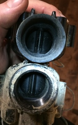

The Hunter valve is converted to barrel sealing and has been modified for better flow like I did to this Rainbird:
but I'm not sure the flow work is worth it.
