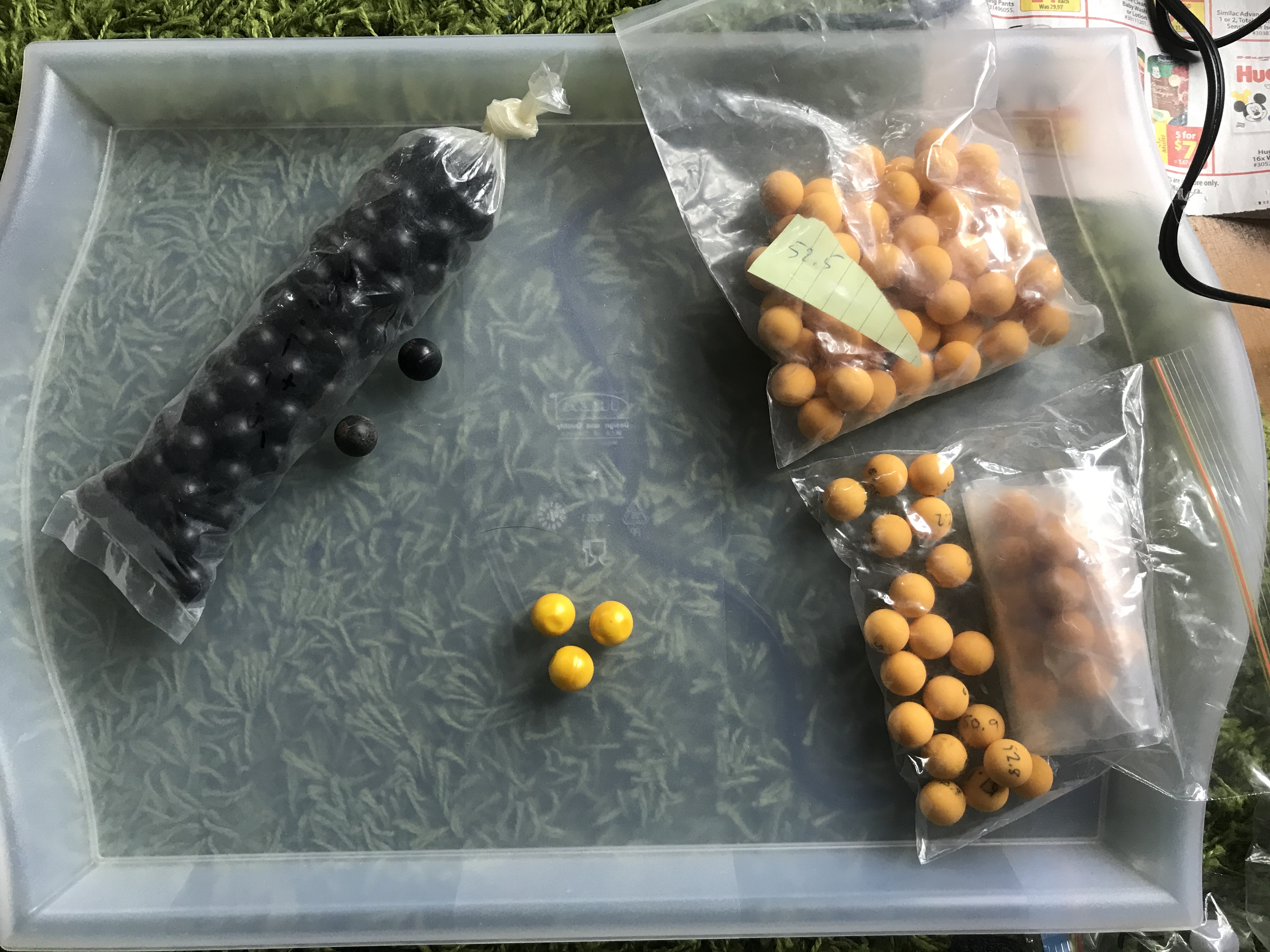

I tried some yellow foamies which are fairly precise (52 grains+- 1) but will not cycle through my delightfully engineered TMC magazine. I can't say enough about this magazine. It is the main reason this quest for ammo is happening.
I ordered at considerable expense Bulls Breaker Balls, supposedly Nylon, but they are neither Nylon nor 68 cal, most around .645. Mass varied wildly with most about 33 grains but a group closer to 40. They cycle but will not hit in 12" circle at 5 meters.
Also shown are 3 actual paintballs, roughly spherical, don't store well, and the flight characteristics of a liquid filled roughly spherical object.
Marbles are too small.

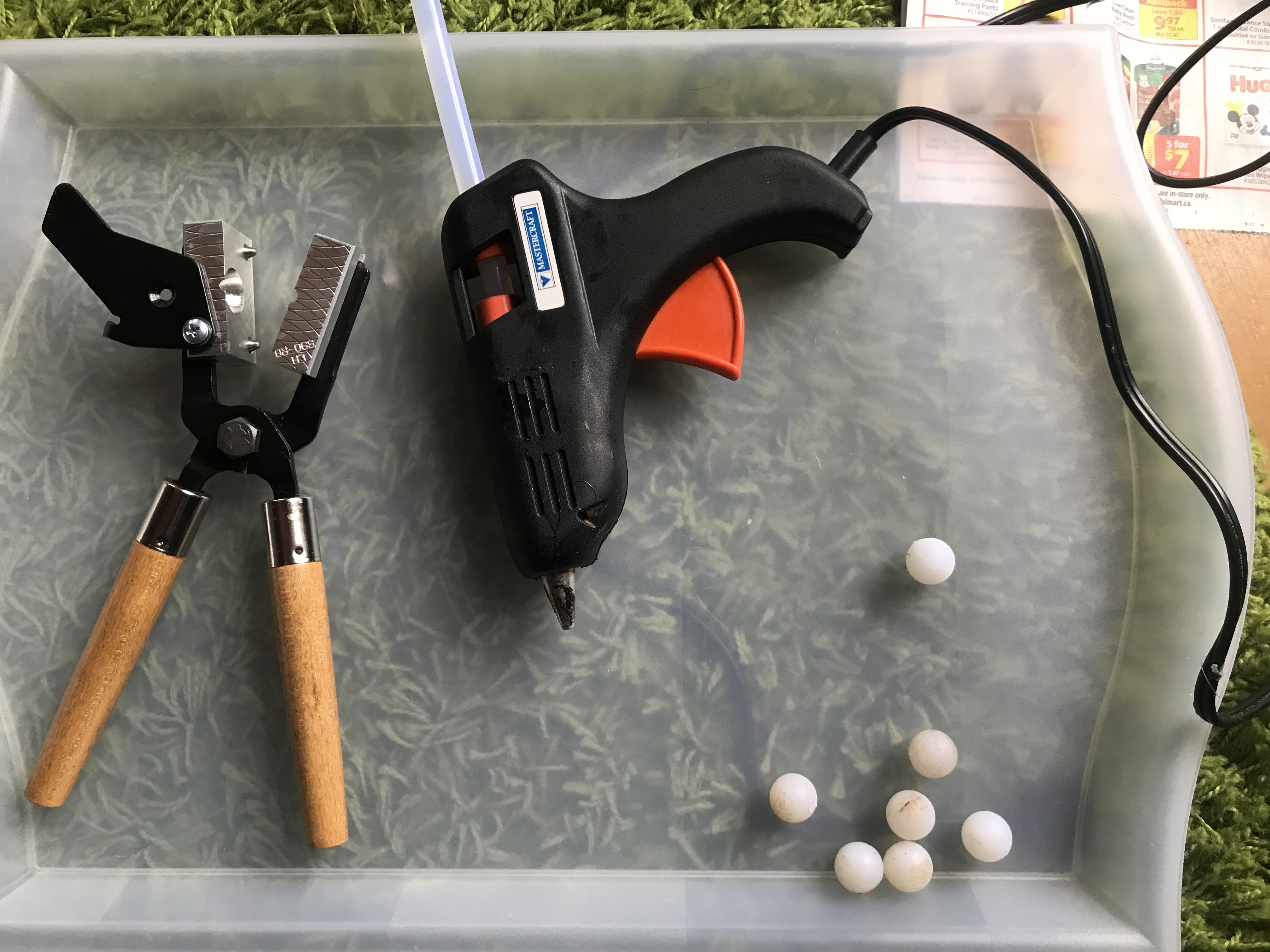

Next idea:
It takes some technique but it can drop a glue ball +- 1.5 grains and just snug enough to take a puff of air to drive it through the barrel. Varying the temperature of the mold can give different diameters. I made some too tight to push through with lung power (cast at room temperature).
video test of glue balls:
Another idea to try is modifying the hot glue (talc filler) or try beeswax.
