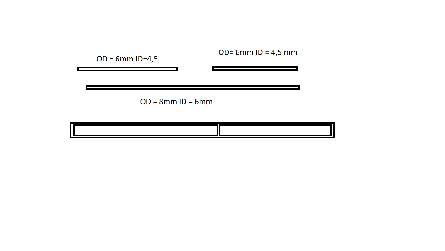

Hi , short questions
Can I connect this two 4,5 mm barrels in one longer like this? I have short barrel and I want now it little longer. I will just put this two OD 6mm tubes in one 6 ID tube. Will it work? Will it ruin accuracy? Can the power decrease?
- Barrel.png (9.82 KiB) Viewed 83535 times
You will get more power, though if they aren't perfectly joined together you might lose accuracy. You could use a 4.5mm ID drill bit or similar rod as a mandrel when you glue them together.

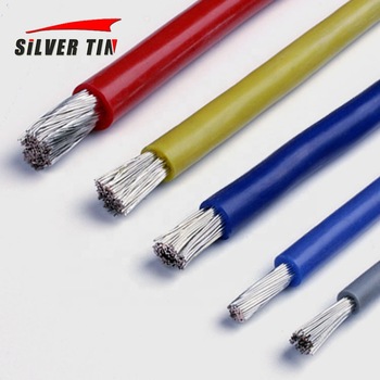

I find it a bit complicated to electrically insulate the high voltage cables from the sparks. At times it seems that only space can make the spark not jump where she wants.
What materials do you use to insulate? Is there any special type of cable for this purpose? They tell me from these sides that silicone can be used ... any ideas?

Have you tried using wire specially made for high voltage? The wiring from television flyback circuits is really heavily insulated and works well.hectmarr wrote:I find it a bit complicated to electrically insulate the high voltage cables from the sparks. At times it seems that only space can make the spark not jump where she wants.What materials do you use to insulate? Is there any special type of cable for this purpose? They tell me from these sides that silicone can be used ... any ideas?
Good multimeter leads are made from silicone and look at some of the voltages they can handle. Only thing is that a good set can get pricey.

I will try to get some cable from the multimeter or the fly back for TV.
The other thing that I have to try is a good common cable inside a silicone tube, model airplane fuel hose, which has a couple of millimeters of wall thickness and is very flexible. Thanks for the answers.

Or simply drop into a garage and ask if you can buy a couple of metres of spark plug cable. It's made for the job. I've seen the silicone hose over normal cable thing done in the model engineering world, too, it works best with multi-strand wire. Apparently (also a hint from the model enginerding lot) you can also use "push back wire" which is normally used for rewiring vintage guitars - here for example : https://www.stewmac.com/Pickups_and_Ele ... _feet.html

Good idea. I think the spark plug wire used in cars is the easiest to get around here, I will try that.
This seems to me that it meets the requirements. It does not specify the nominal working voltage, but it is for high voltage and is not too expensive.
