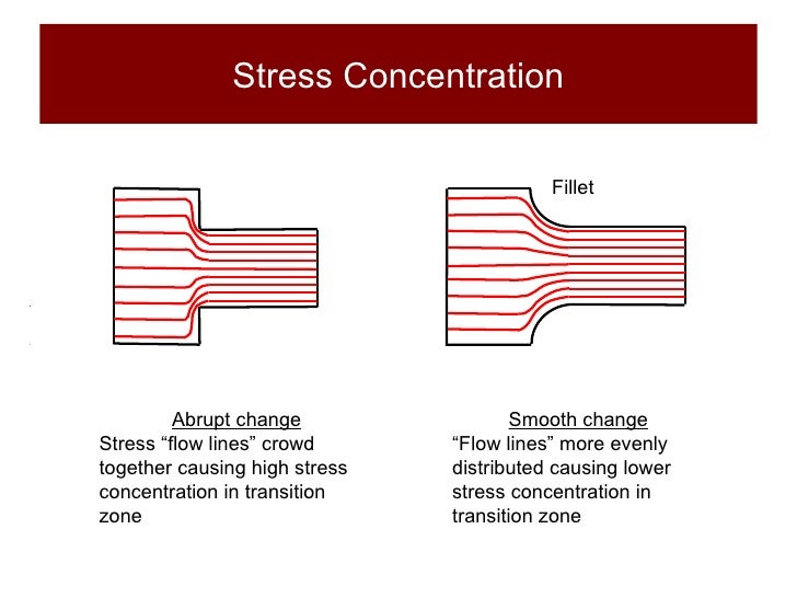

I found this image on google under stress riser. Do you think it would of been better to put a funneled reducer from the chamber to the barrel instead of an abrupt one?

Luke31 wrote: Wed Oct 21, 2020 1:11 pm Do you think it would of been better to put a funneled reducer from the chamber to the barrel instead of an abrupt one?
No, I think it would have been better to not use PVC.
My guess as to what's happening is that the piston shoots backwards as intended, the pressure behind it perhaps blows off the ball valve (that could also have been shock related or just down to dropping the broken cannon), the piston then impacts the back of the chamber, and creates a shock wave that then runs back through the PVC and concentrates at a shock riser that has also, coincidentally, had its structural integrity compromised by the use of solvents. The fact the barrel was flapping in the breeze probably didn't help either, per JSR's comment.
The problem could perhaps be alleviated by use of a radiused (not necessarily funnelled) joint, but the solvent issue still stands, as does the shock wave. Perhaps physical damping on the back of the piston, too. But ultimately, you're still talking about shock loadings on a fragile material that's not designed to handle it.
