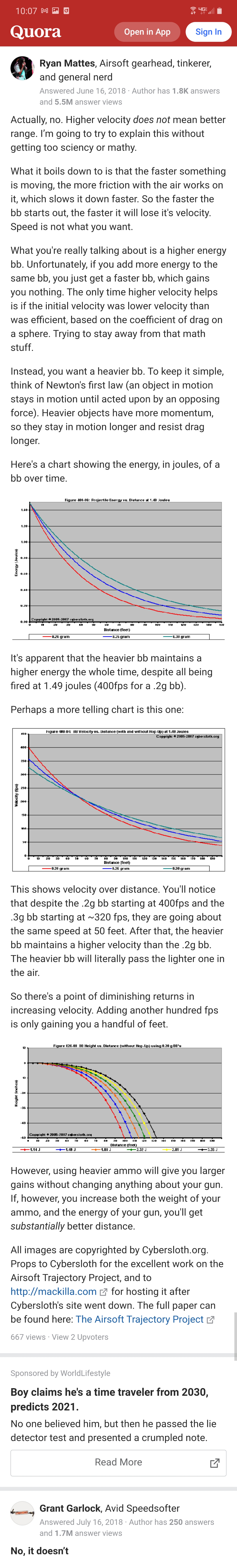

I am hesitant to chime in, seems i have a dissenting opinion.
Thank you hectmarr, language is not something I study, and your post even in translation is clear and concise. I guess I could not explain properly.
As hectmarr stated any imperfection in the barrel will affect performance.
Personally I thing you would have a huge benefit from heavier ammo.
I found this article maybe it will help.

It is logical what it says. A 1/4 "steel pellet weighs almost exactly 1 gram. The mass of the ammunition should influence its rotational speed as it exits the barrel intentionally or unintentionally. The heavier, the more resistance to rotating at high speed. Unfortunately, I only have steel bb's that I can buy, and I use them because they are reusable, you can collect them in a box that stops this ammunition and reuse it many times. I can't with lead because they deform just by shooting them I have tested this by impacting them on soft mub surfaces and pulling them from a distance. At the first shot with a smooth-bore barrel they deform, and if it is a rifled barrel, worse, the grooves remain and tend to oval ...
For the rest, feel free to comment. I don't see anyone's lack of respect for anyone here. I'm not going to say anything else about this "pull" because surely the "game" will be between three, instead of two. I apologize in advance if my comment offends or makes someone uncomfortable, sorry, sorry, sorry ... :D :) :D :) :D :) :) :) :) :) :) :) :) :) :)
This afternoon I will read the article that I need to understand about this, even if I do not have a doctorate in atomic physics! :twisted:
