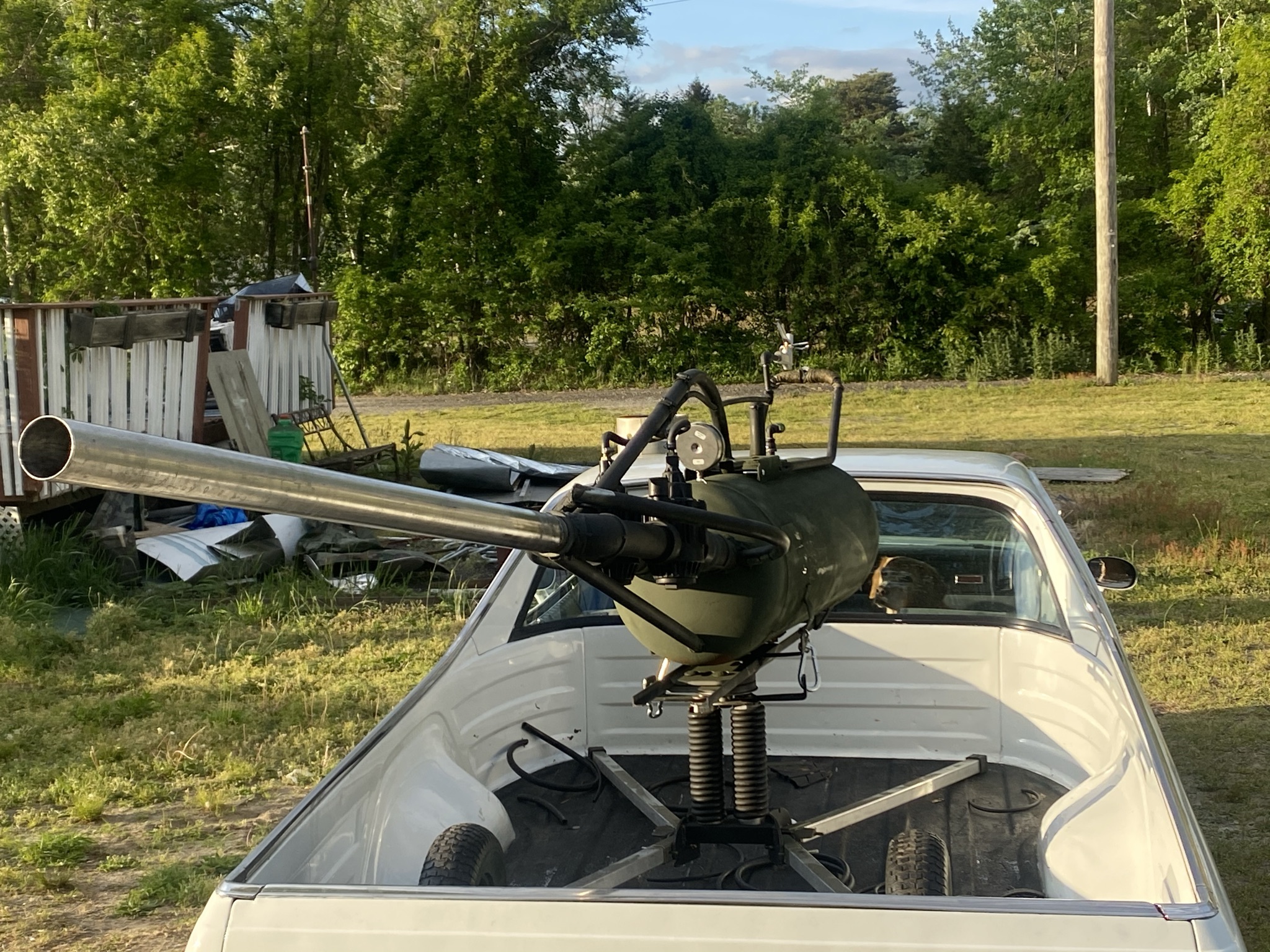

Here’s my multiball cannon, golf ball with led in it. I have 2 2” and 2 1” irrigation valves modified to dump all the air out of a 26 gallon compressor. Check it out here
https://youtube.com/shorts/NEpRU3xFAVA?feature=share
A little inefficient but cool stuff!
